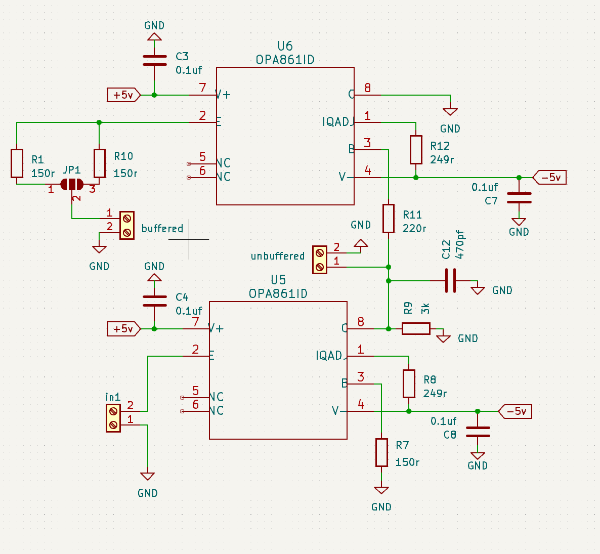

The LT3032 is subjectivly less good than the former, sound wise. ADP7102 ?
I would try to make at the voltage pins of the 861, two 0805 decoupling for acrylic caps, for instance the ones made by Panasonic. Not necessarily needed, but it is to balance the sound of the reg output cap. 0.1 uF.
The second 861 (buffer) must be configured in reversed mode according Audial's shematic.
If you can, you should try to put traces with two vias outputs to both try the circuitry with the buffer and without by outputting directly after the first stage.
the 150R output smd traces are fine, subjectivly though you can try an ALLENB 1/8W of the same value... very nice
Thanks for the feedback! I've attached an updated schematic with the ideas.

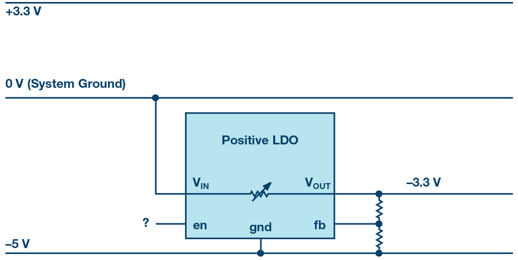

I can't seem to find a good negative voltage companion for the ADP7102. Do you have any recommendations? I could do something like this:
Seems unusual and not really recommended, but then I could use 2 ADP7102's?

@cibo ,the negative is ADP7182 but in 5-lead TSOT, so you can also order ADP7102 in the same case.
You can also use better regulators such as LT3042/3094.

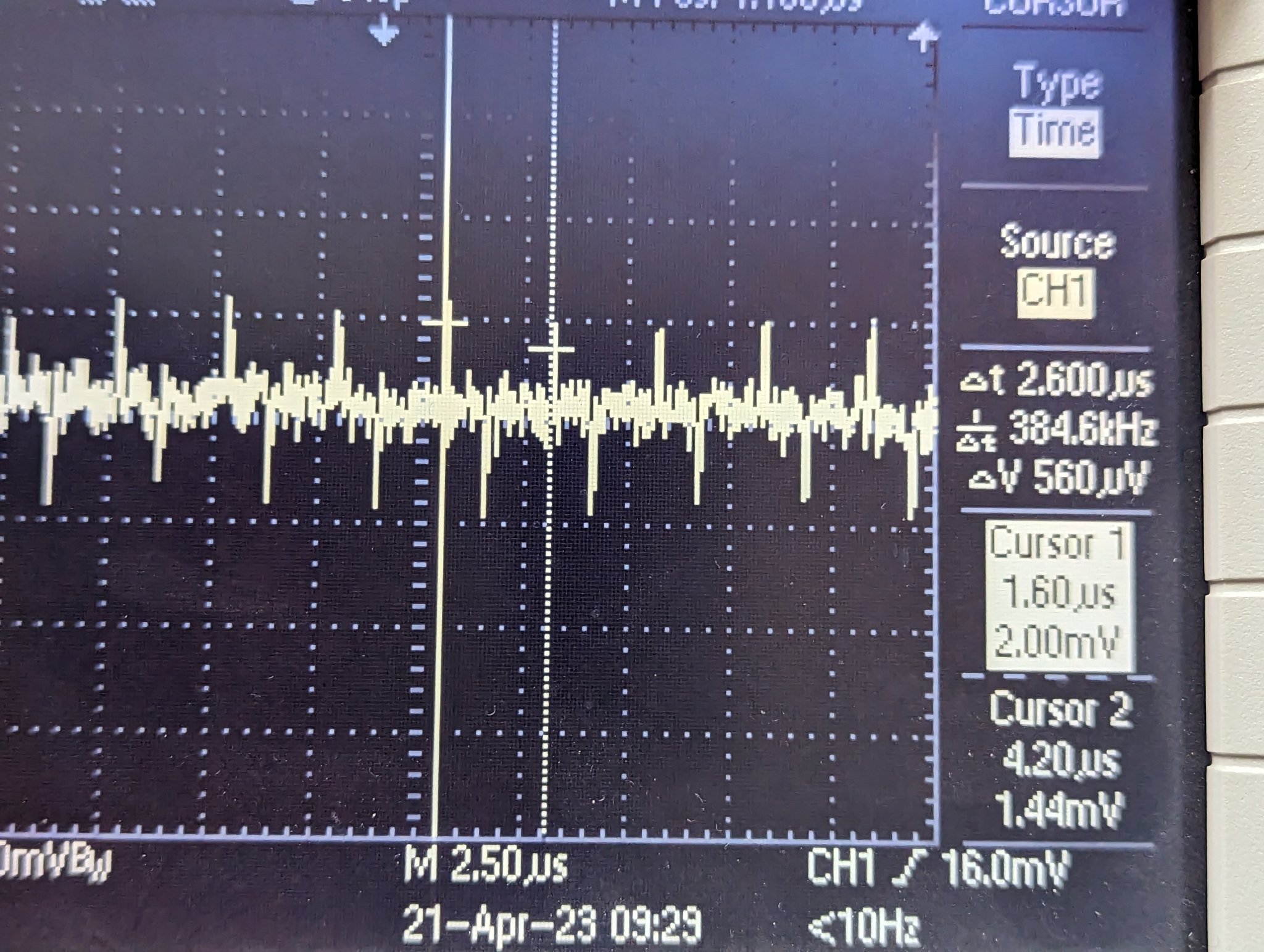

Question: I am using AD1862 with I2SOVERUSB. On noise floor one can see the LRCK residuals. Tiny but exists (my whole board has about 1.4uV noise from 1 to 20khz). Can see it with no input signal of course.
I can understand why it may happen but is there a way to reduce it? While no signal in the DAC should switch 0 according to LRCK. It happens with my other DIYINHK board, based on stop clock.

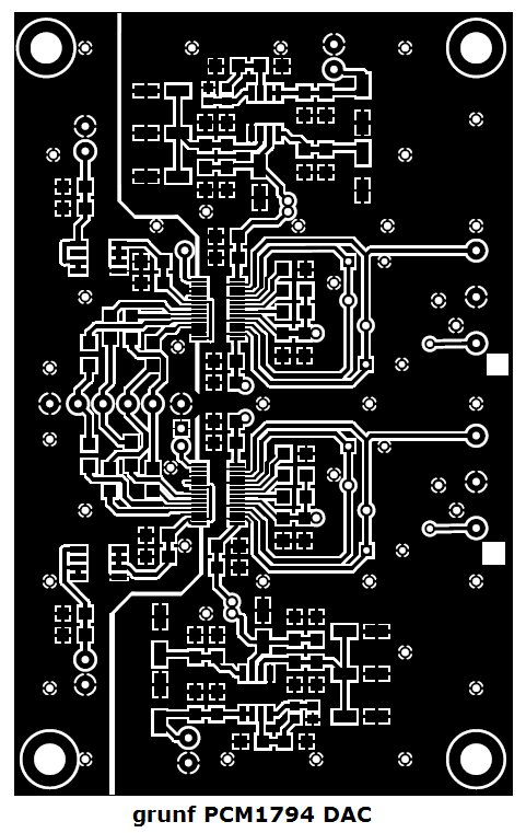

I know the PCM1794 very well, its disadvantages and advantages because I started designing a DAC with it and I expected it to replace the existing one with the PCM1702. Then I wanted an 'active' I/V conversion with tubes which I discovered then and was delighted and already then problem appeared with the high output currents of only two PCM1794 in parallel and the impossibility of finding the ideal tube for that current.
Now I would go the other way, two PCM1794, four AD811 , then something esoteric for the output buffer, although it could also be AD811 or even AD815 and all regulators would necessarily be shunt type right next to the PCM1794 on the PCB.
I wouldn't comment much about dddac here, but I still think that it can be done much better with PCM1794 and I consider that a challenge for my next diy DAC🙂

Are you using some PCB designed by me? I did not hear any residual LRCK signal, it is dead silent while no music is present. Some players are stoping the LRCK signal immediately (VLC, youtube) and some are not (bsplayer).

Anyway, even if I am not connecting the USB cable, the LRCK residuals are on the latest or what ever the I2SOVERUSB is stacked on when turning on.
I will try to send a picture. It is possible to see it even with scope on 1mV/div and clearly with cosmos E1DA ADC.
It seems the I2SOVERUSB does not stop when no music is played. It also happens with the stop clock circuit in my other DIYINHK DAC (also AD1862).
2mV/div, simple TEK TDS1001B.
