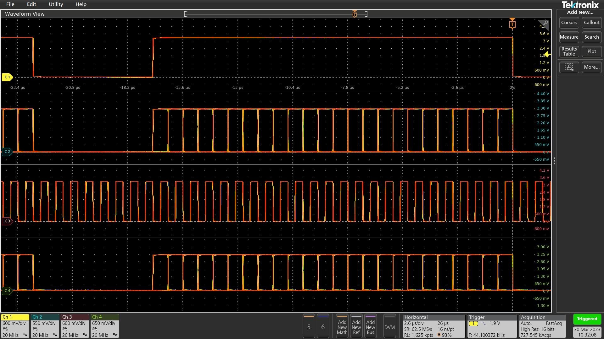

After reading AD1862 DAC datasheet more carefully - CLK is max(min17MHz), which means that it's possible to have some DACs on which maximum CLK frequency to drop to 17MHz, but it's not specified maximum CLK frequency, i.e. it may go to 30MHz, this means that some DACs may work on higher frequencies, some doesn't, i.e. it's guaranteed that all AD1862 will work up to 17MHz.I will check, you are right I should check it before. Just was taking the AD1862 datasheet as truth, see it is written support X16.
I actually don't know how the I2SOVERUSB work.
Is it 768k*20*2 or 768*32*32, in both cases it is higher than 17Mhz 🙂 so, in any case how they can write support X16 when the limit is 17Mhz?
Your and other guys math is absolutely correct - 768k * 20 < 17MHz, but this means that the frame word must be 20 bits, in order all AD1862 to work on 768kHz, not 32 bits like JLsounds board outputs (768k * 32 > 17MHz). Here is oscillogram of bit depth for PCM1704, oscillogram for AD1862 is the same, but 20 bits 🙂AD1862 supports 16x but word length should be 20 (48*16*20 = 15.36MHz). Some digital filters can output 20bit word length.

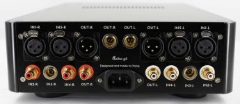

Guys, I want to use XLR output parallel to the unbalance (RCA). I don't need a true balance. So I know the next method:
- 1pin ground
- 2pin signal (L and R)
- 3pin ground with resistor that corresponds to the output on Dac board (100ohm)

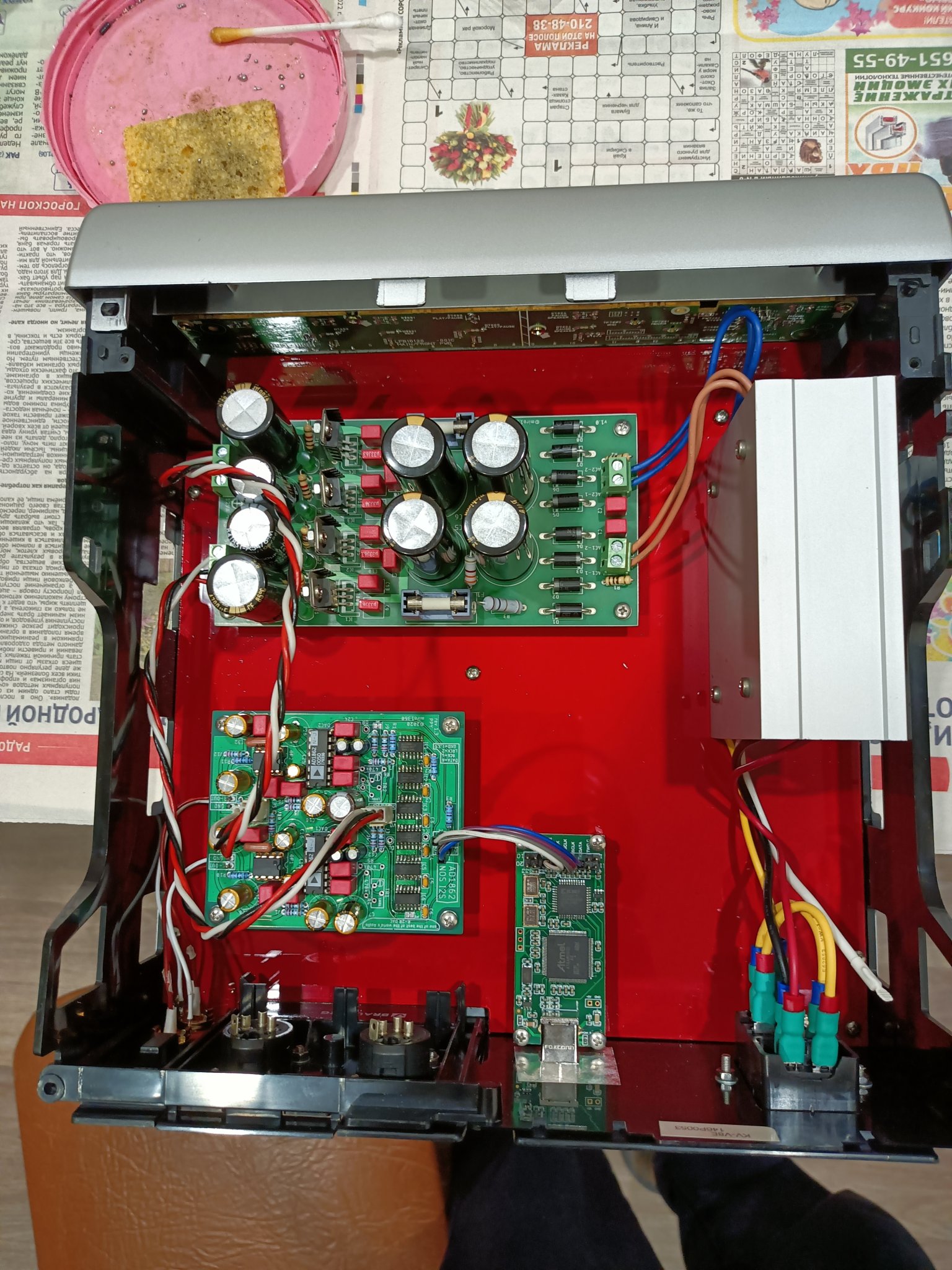

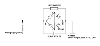

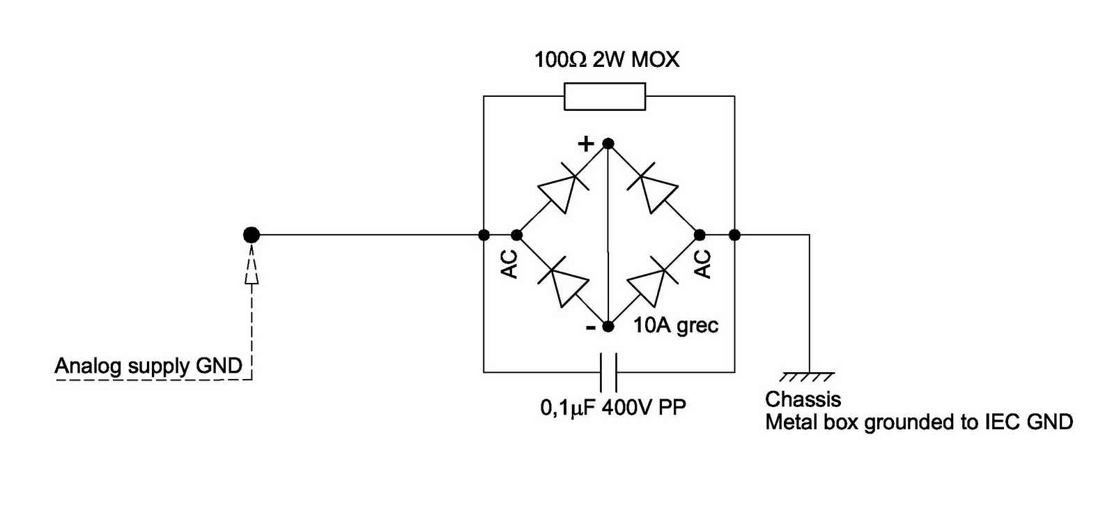

There is a known Pin1 issue. As a rule, pin1 for XLR connectors is connected to the chassis, and somewhere it is connected to the signal GND. How is your DAC GND connected to the chassis? Directly, indirectly via a NTC resistor or some other way?

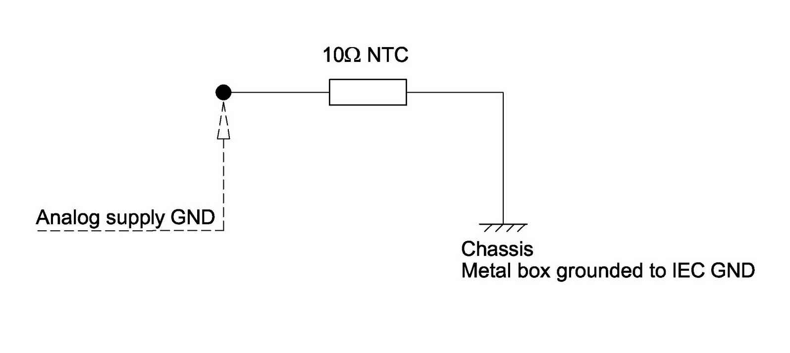

In your case I would try to connect Pin1 to the signal GND on the DAC board between the L&R outputs. And since you have a metal box, it must be connected to the IEC connector GND, and then the signal GND from the analog power supply is grounded to the chassis via gretz 10A+100nF+100ohm resistor or just with 10ohm NTC resistor.
If it's a plastic chassis, then what I wrote doesn't apply.
NTC 10ohm is usually placed from the signal GND to the grounded metal chassis. It is a GND Loop breaker, protection against too high touch voltage and removes electrostatic charge. Graetz rectifier 10A +100ohm+100nF has the same function (100nF is AC GND for high frequencies).
22ohm are the output resistors on L&R line outputs, they have nothing to do with grounding.

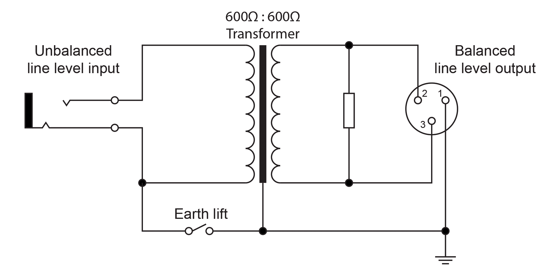

If your next device is balanced, then you have to connect pin 3 (-input, cold) to GND either in the DAC or in that device (preamp I guess). Obviously this should be done in DAC. When you connect it like that, the balanced device will have half the voltage gain (-6dB).
Another way is to use a line transformer to convert unbalanced to balanced. But it's not cheap.

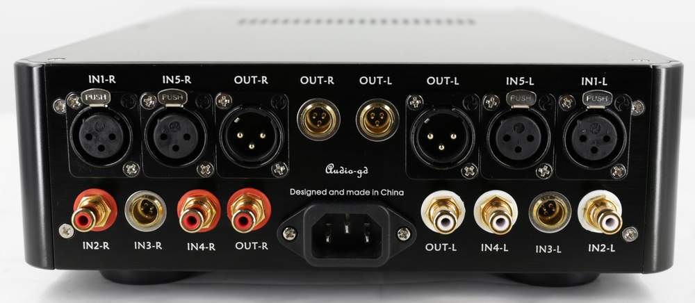

I have AudioGD NFB-1 amp. He is fully balanced. audio-gd Stellar product
What kind transfomer you mean?
Why don't you use RCA inputs?I have AudioGD NFB-1 amp.
