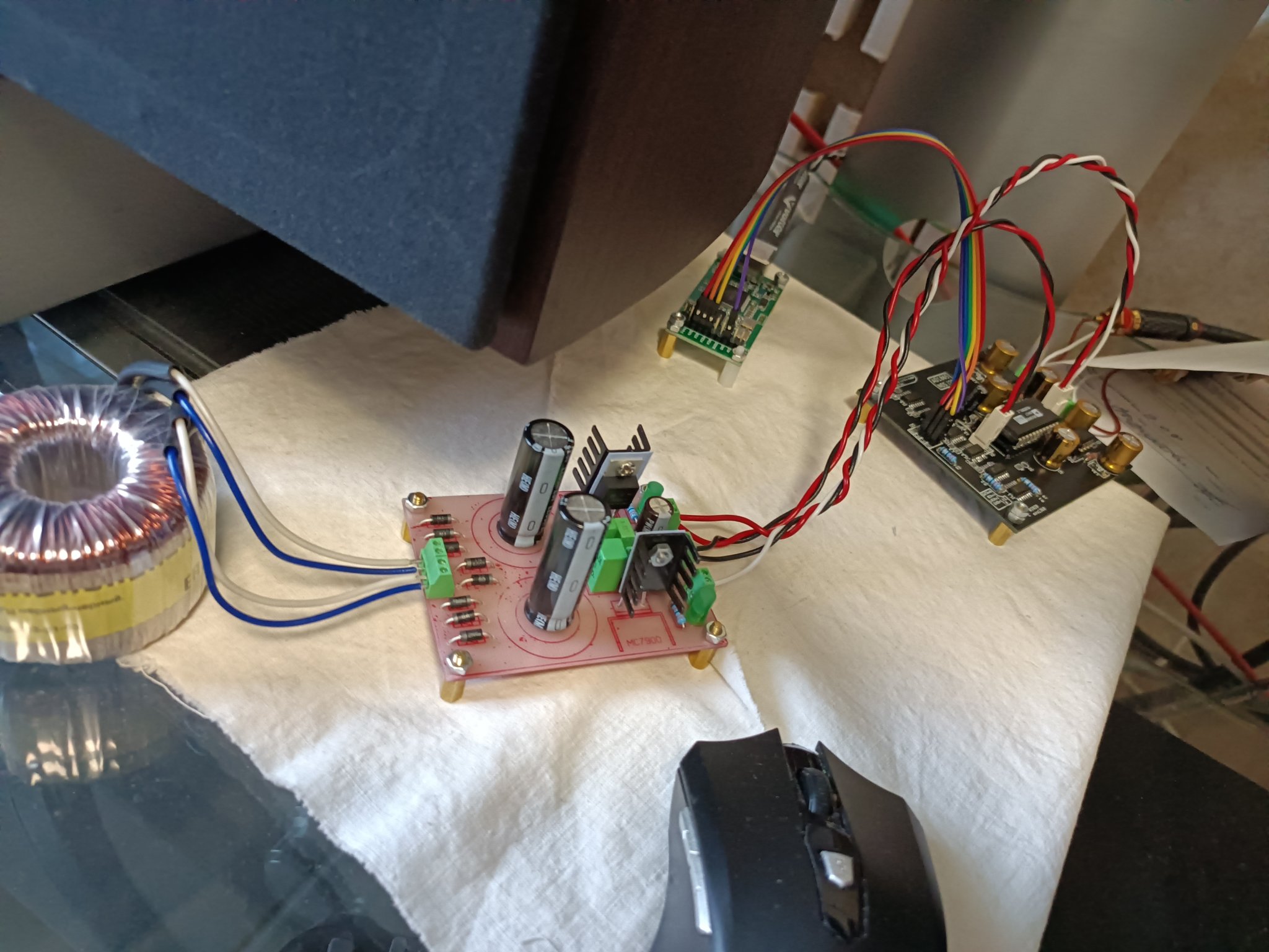

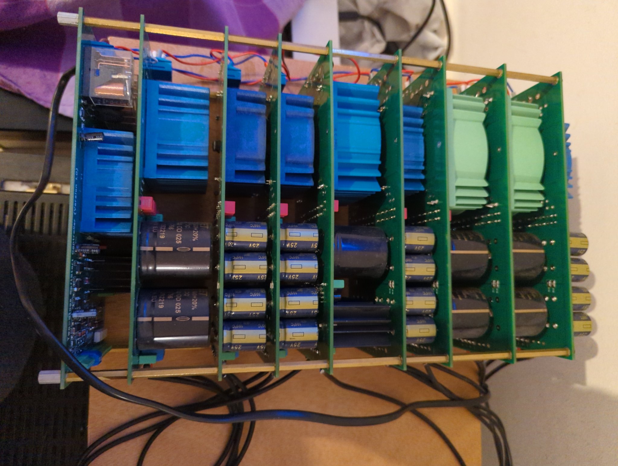

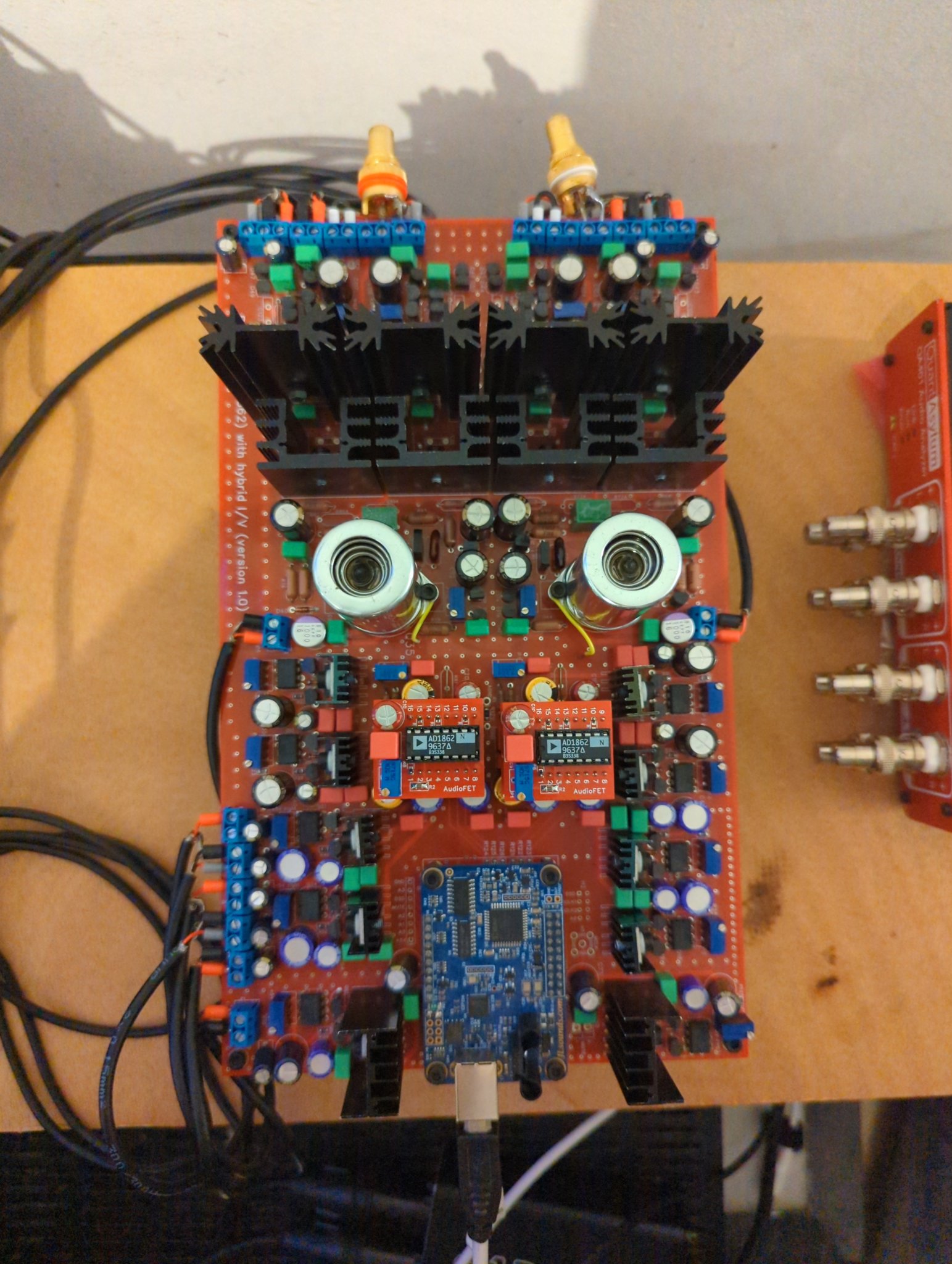

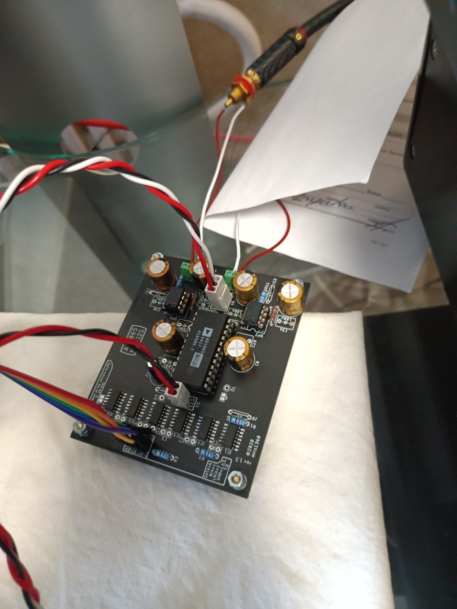

This is a DAC I build with a friend, Alex Weizman (famous ebay JFETS seller), PCB designed by Alex. You can see, 3 floors of AD1862 on each channel.

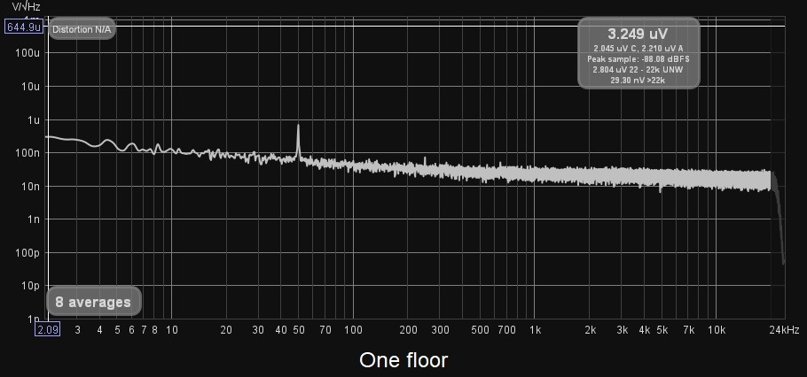

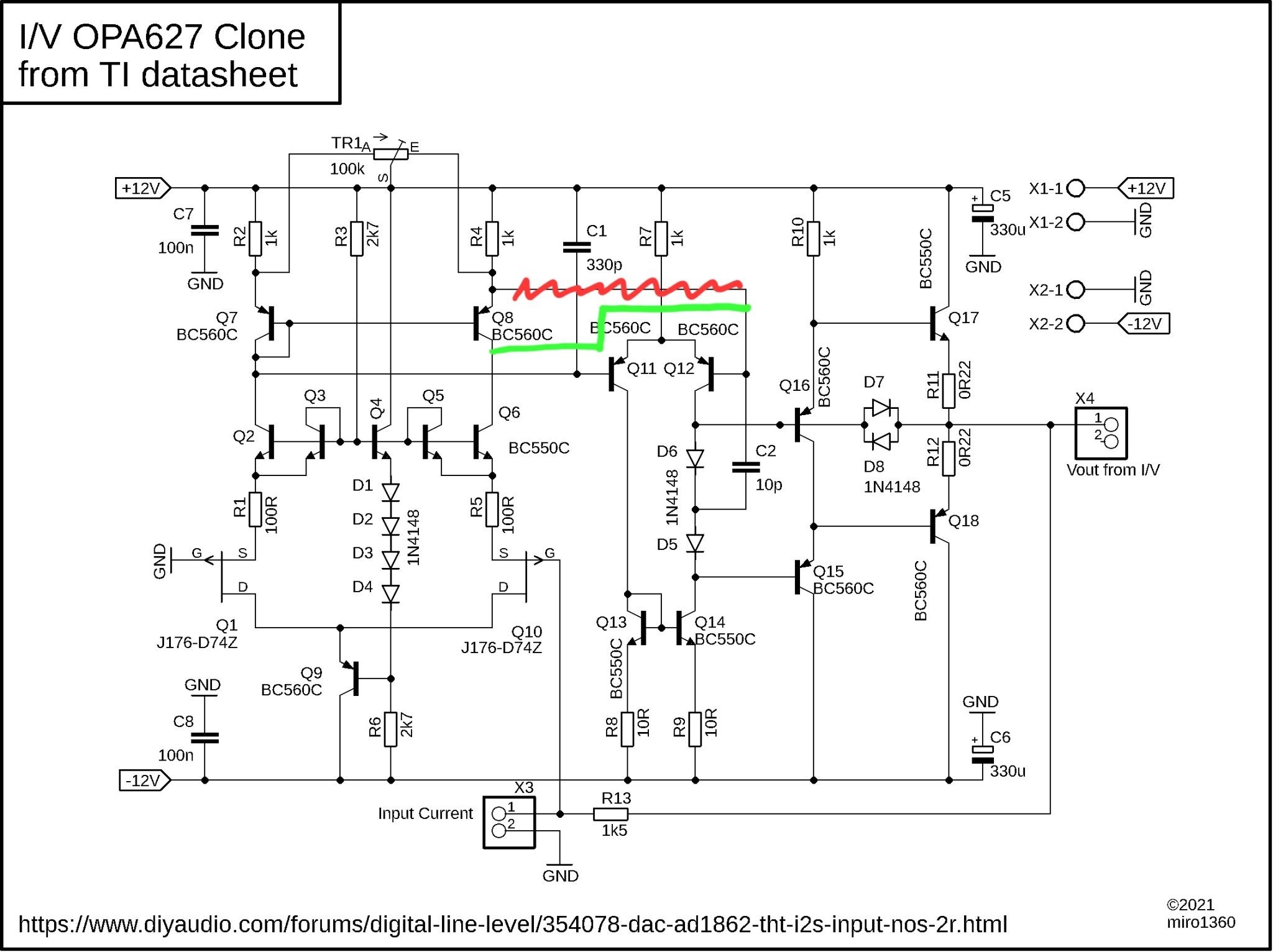

I/V based on Borbely hybrid (6N1P input differential), all regulators on board. The HV regulators (24V 🙂) are Borbely discrete and the low voltage regulators are opamp based (also a Borbely style but standard). Noisefloor about 3uV from 1hz to 20khz, not weighted.

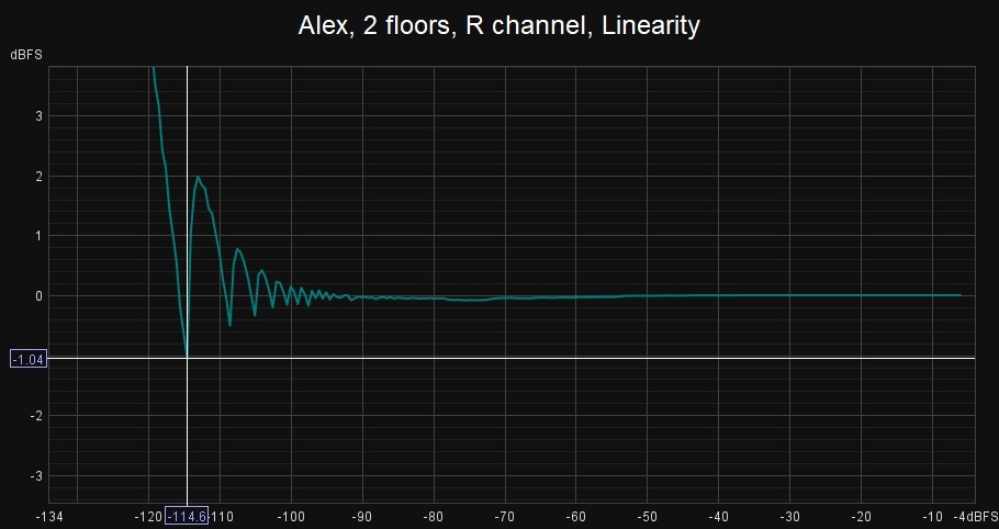

Linearity about half a db up to 18bits, about 1db at 19bits. More or less accurate up to -114db.
When I have time I will send some measurements. The DAC sounds really good. I must say, the PCM63 is more linear (in linearity test) even without trimmer calibration (as implemented in Parasound DAC). To handle offset we add servo for I/V.

Although one can see in the picture QA401 is hiding but the above tests with COSMOS. Noise is measured by first amplifies noise by Brookdeal 431 LNA then divided by its 60db gain. That is to be sure on measurement. Both the COSMOS and QA401 show more or less the same noise number.
