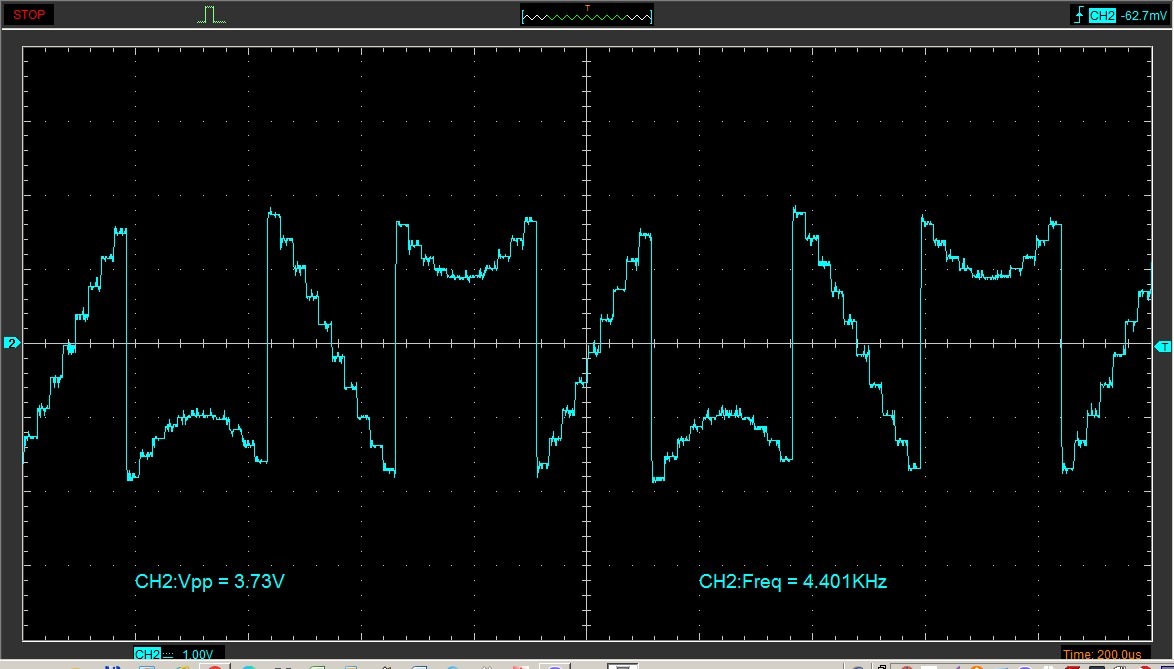

Yes, @djmilicic and I happened to notice the problem. PCM1702-K with an adapter for PCM63 in one DAC works, in the other it works but with crackling. It turns out that the problem is in the shift registers (AHCT & HCT). Later, a direct JLS I2S over USB connection was tried, bypassing the shift registers, and it works fine. PCM63 works with both types of shift registers. The screenshot shows what happens when the 1702 works with the AHCT registers (sine wave 1kHz). With HCT it works fine. I have no idea why it is like that.
We shopped parts at Mouser, there was a shortage of parts and we got the AHCT shift registers, because we know it works with PCM63 thanks to @mikorist who was a beta tester of PCM63.

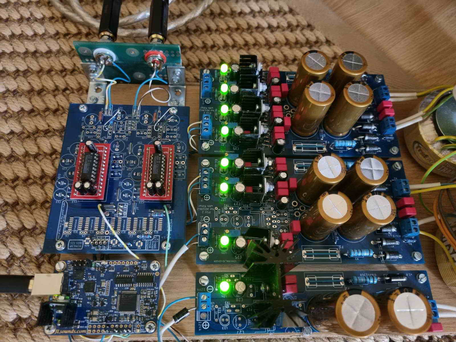

Direct connection example. The diode in the picture reduces the voltage for the XMOS part to about 4.2VDC. PCM1702 with adapter works on PCB for PCM63 with data from JLS board. I/V is passive (100ohm resistors). What is behind is the tube gain stage which is not visible. 🤣
Another interesting thing. When the Miro PSUD2 PCB is cut in half (longitudinally), one complete plus and one complete minus regulator is obtained. The other two were lost. Thus, LT1963 or LT3015 can be used to power the XMOS part of the JLS card. Pictured above is the LT3015 (fixed -5V) with a larger heatsink. The point of cutting is the possibility of using a larger cooler and smaller PCB for one single 5V supply.
