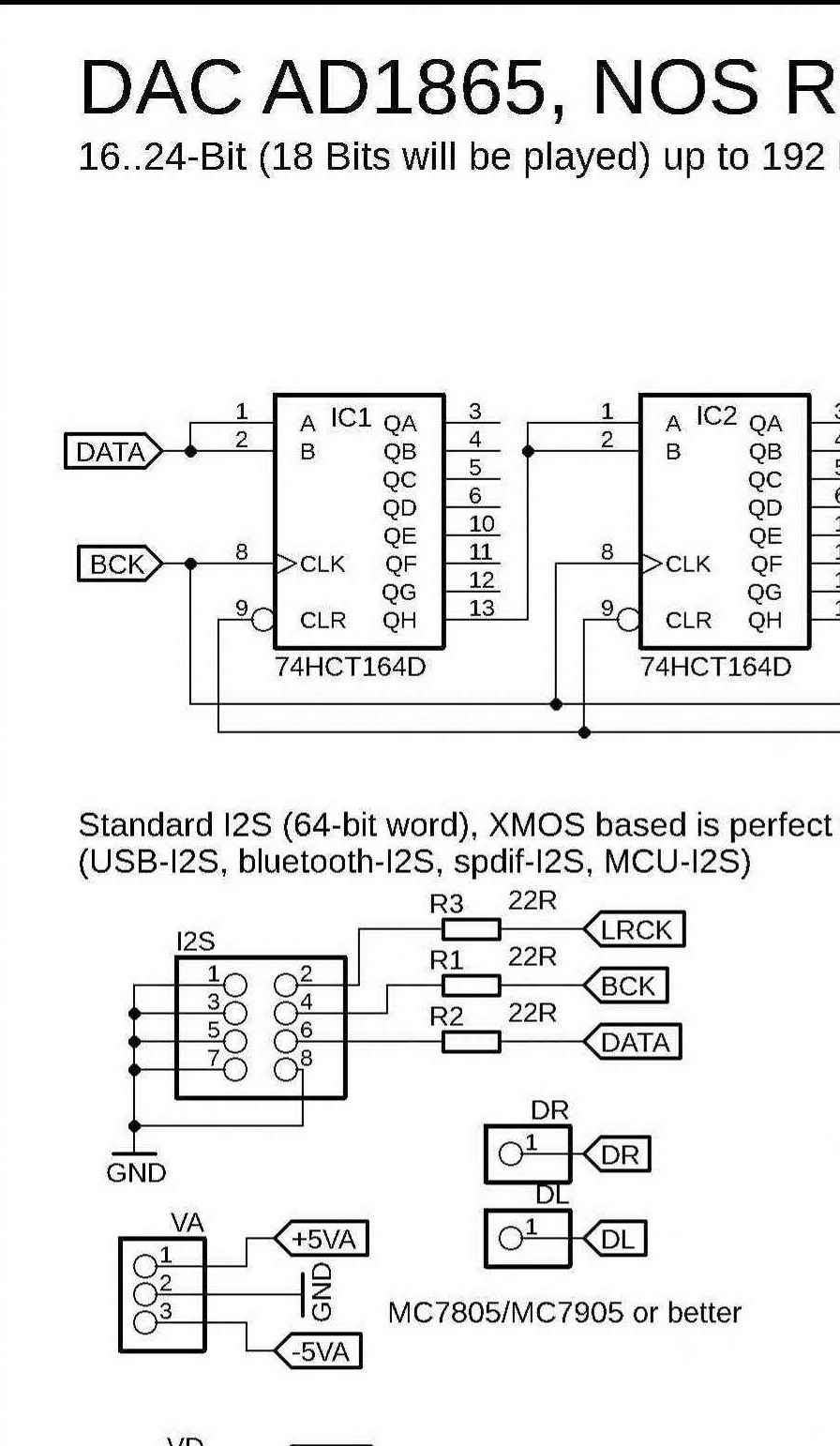

Pin 8 on I2S connector.

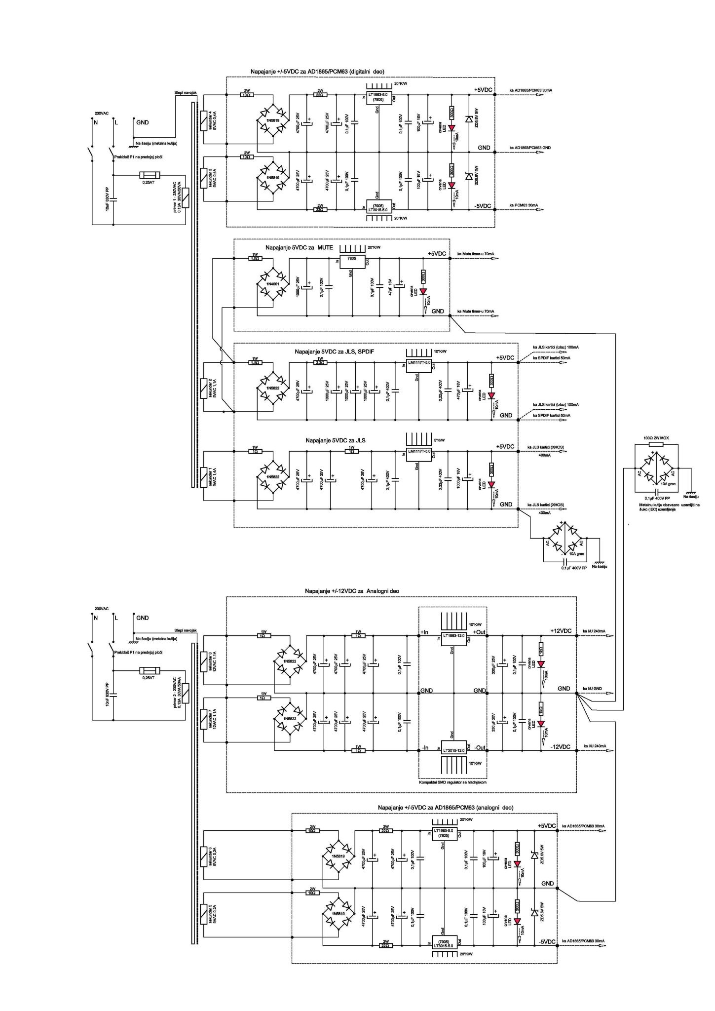

I made my own power supplies, I didn't use PSUD2 boards, I have separate secondary's on the transformer for each power supply. GNDs from the digital power supplies for JLS, AK4113 and PCM63 boards are not connected anywhere except through the I2S connector. I did that so that there is no accidental ground loop somewhere.

This is the power supply right now. No Graetz yet, I just connected everything to IEC GND, including the blind threads of the transformer. And one 0.63AT fuse was put in for both transformers, temporarily too.

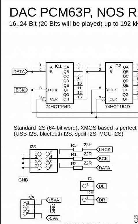

There is one small thing. On the I2S connector on the PCM63 board (pins 2,4,6 and 8) pin 8 says GND, but it is not connected to GND. I connected that from the bottom (pins 7 and 8) so as not to change the connector I used for the AD1865. I have no idea why it is not connected to GND and it says GND? I didn't notice before. This is important to me because the AK4113 and the JLS output part are grounded through that pin to DAC GND.
Thank you for pointing this out, I repaired the GND pin and here is new gerber for the PCM63P 😊 😉
