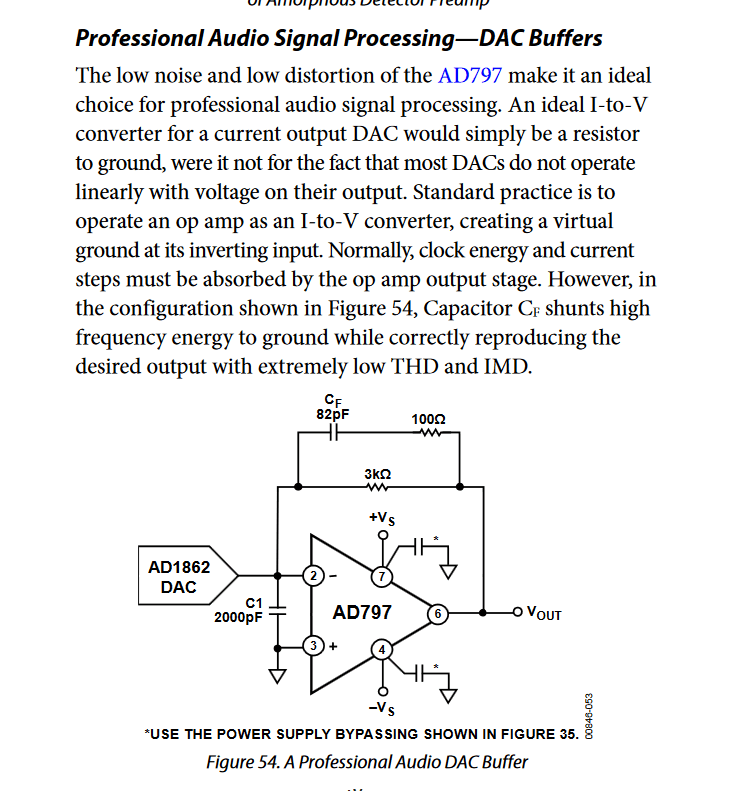

A few days ago there was a discussion about AD797, but no one remembered to include part of the text from DS.
Scott Wurcer's commentary on AD797 and AD1862 can also be found on the forum.
It is unfortunately that Scott is no longer at the forum to ask.
But I tried this exact circuit using PCM1704 and OPA1611.
The cap to Gnd actually caused huge distortion in this particular combination.
Removing the cap, and the world is normal again.
Of course I have not tried with AD1862 and AD797.
Only want to say that this should be treated with caution.
Some discrete IV circuits have an input impedance of ~20R, and they still sound very good.
Which is what led us to go with 27R passive IV followed by a 100x voltage amp.
