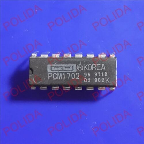

PCM1702-K from ebay seller Polida, they work, and it is written KOREA on them. The price is $31.50 a piece and postage is $2. If PCM1702 is already taken at the start, then it is better to make a Miro PCB for 1702 than to use the one for PCM63 with the 1702/63 adapter

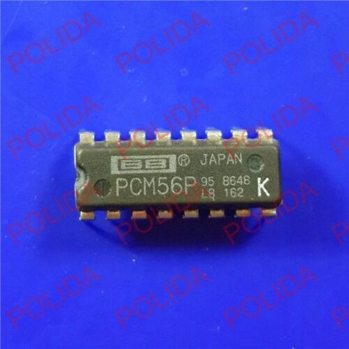

PCM56P-K from Polida look very similar to PCM1702-K, except it is written JAPAN.
I don't know if they are original, just like I don't know about these PCM1702-K. 🤣
I think they are cheap enough to try (PCM56). I'm waiting for a friend to bring me some used AD1856, if that doesn't work I'll get a PCM56 from Polida.

I don’t know what is now, but 5-10 years ago the word “Polida” was synonymous with the word “fake”.
It's good if things have changed.
I heard about some fakes from Polida long ago. Maybe they sell a mix of original and fake stuff, who knows. And this PCM1702, maybe it's an original but plain one without a mark, and someone added a K mark to sell it more expensive. I will use it for rehearsals, not to risk with PCM63 originals. And if it sounds better than PCM63 (I doubt it), it will stay permanently. In that case I will make a PCB for the PCM1702.
