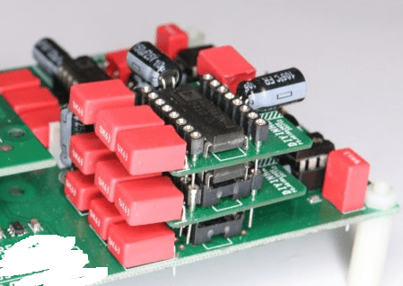

After two failed attempts with the SMD PCM1702U and two refunds, and wasting time, the DIP16 version of the PCM1702-K (from ebay seller Polida) worked with the PCM63 adapter. Pictured is @djmilicic DAC Miro PCM63 working with PCM1702. We will tell you later how it plays compared to PCM63. 🤣

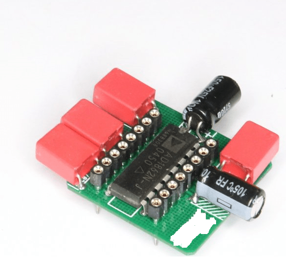

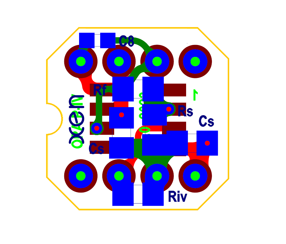

Someone asked whether the 27R passive IV with AD797 can be used directly on the Miro opamp socket.
In principle yes, but you might need to either move some caps to the bottom, or do some filing on the PCB, or both.
The circuit is the same as the one tested by Fran, but the PCB layout is not tested.
Fran will double check when he has time, before we post Gerber.
You can the order together with your next batch of PCBs.
Size is 12x12x1mm.
The opamp footprint is SOIC8 single opamp.
So you can also use others, such as OPA1611, LT1028, etc.
Some cost much less than the AD797 but not as low noise / distortion.
And you MUST remove the original Riv / Civ.
Patrick
