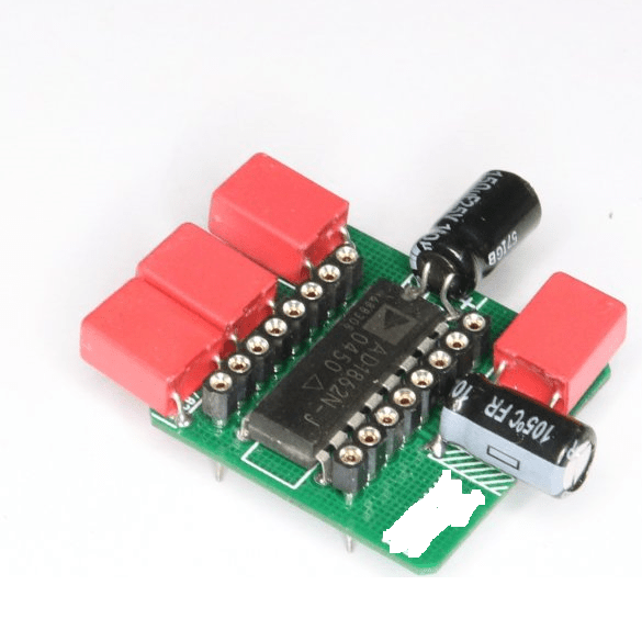

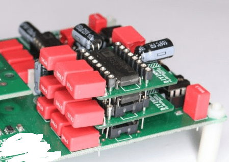

If I want to double up the output from AD1862, pile the dac chip will be good option?
View attachment 1154100View attachment 1154101
It should work, but I have no experience 🙂
- Digital Line Level
- DAC AD1862: Almost THT, I2S input, NOS, R-2R
