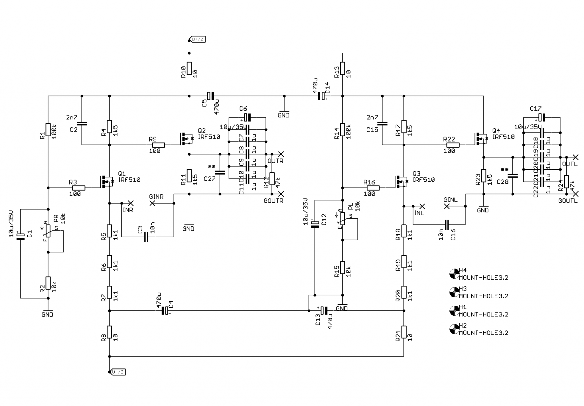

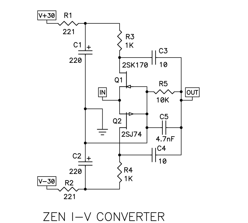

Yes, plenty of choices: p Rogic, T Loesch (tubes), Pass, Jocko Homo, Patrick (commercial pcbs at ZEN), Moglia hybrid emitter follower, etc.
Wondered only if Zen Mod had made a little buffer that recaptur the Yamaha/Sony beloved transistors hack he usually designs for his PassAmps... but for a discrete dac buffer.

I need to try Nelson D1 ,in a wizard on analog :wiz:

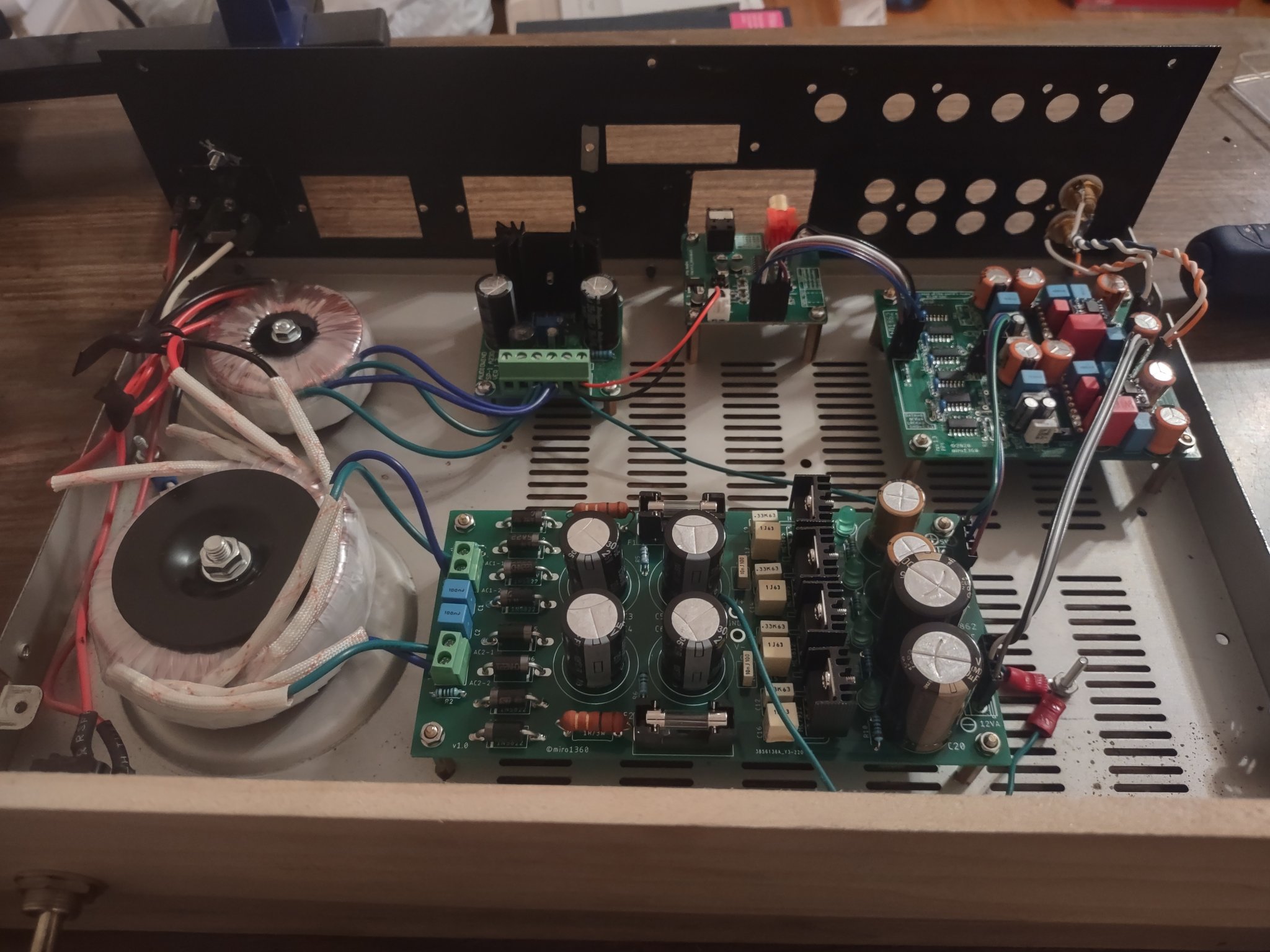

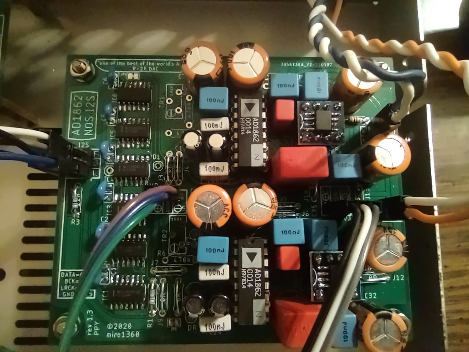

Another one lives! I finished it up on Friday evening but didn't get a chance to spend some time with it until today. And I like what I'm hearing 🙂. I'm using a DIR9001 based spdif receiver board and a Pi running Moode upstream from that. No boutique or fancy parts. Although I went with the datasheet minimum of 1uf/10uf for the noise reduction caps, as Wima makes MKS caps in these values small enough to fit the board's footprint. Currently using OPA1655 for I/V but would like to try one of the discrete options out there. Thanks to Miro for putting this together. And Paddy for supplying the chips. I'll definitely have to come up with a better enclosure because this one is not doing Miro's DAC justice!

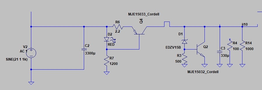

The PSU for TDA1541A ends up as a separate PCB 🙂 There is zero chance of doing any "best" PSU from my side.
I found only one nice testing of different PSUs: https://docplayer.net/154771090-A-c...y-regulator-designs-with-listening-tests.html
and that is why I created my PSU 2 PCB (LT1963A/LT3015). Also the shunt regulator (with mosfet) was not amaze in this article (because phase is rotated from 1kHz? ... not sure). Sad that the 78/79xx were not included 🤣
Simple shunt with ccs from bjt+LED (instead of mosfet) can be a nice candidate for my PSU 3, it is very linear with low impedance, although not very noiseless 🤔
