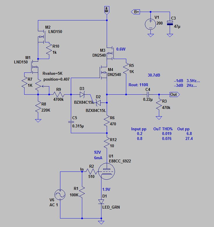

ECC88 hybrid Mu follower aka Moglia Gyrathor, alternative to a pure CCS.
courtesy of @euro21 fellow for the TDA1541 in a thread where he helped me. Should work for the PCM63, I will never know for this last having not PCM63 or K grade either (but will not work for the AD1862, I/V resistor R is needing adaptation). D3 & D2 needs maybe to be reversed ? Not sure here ?!
Something near with a 6NP23-EV should work too before the wall is being reconstructed.

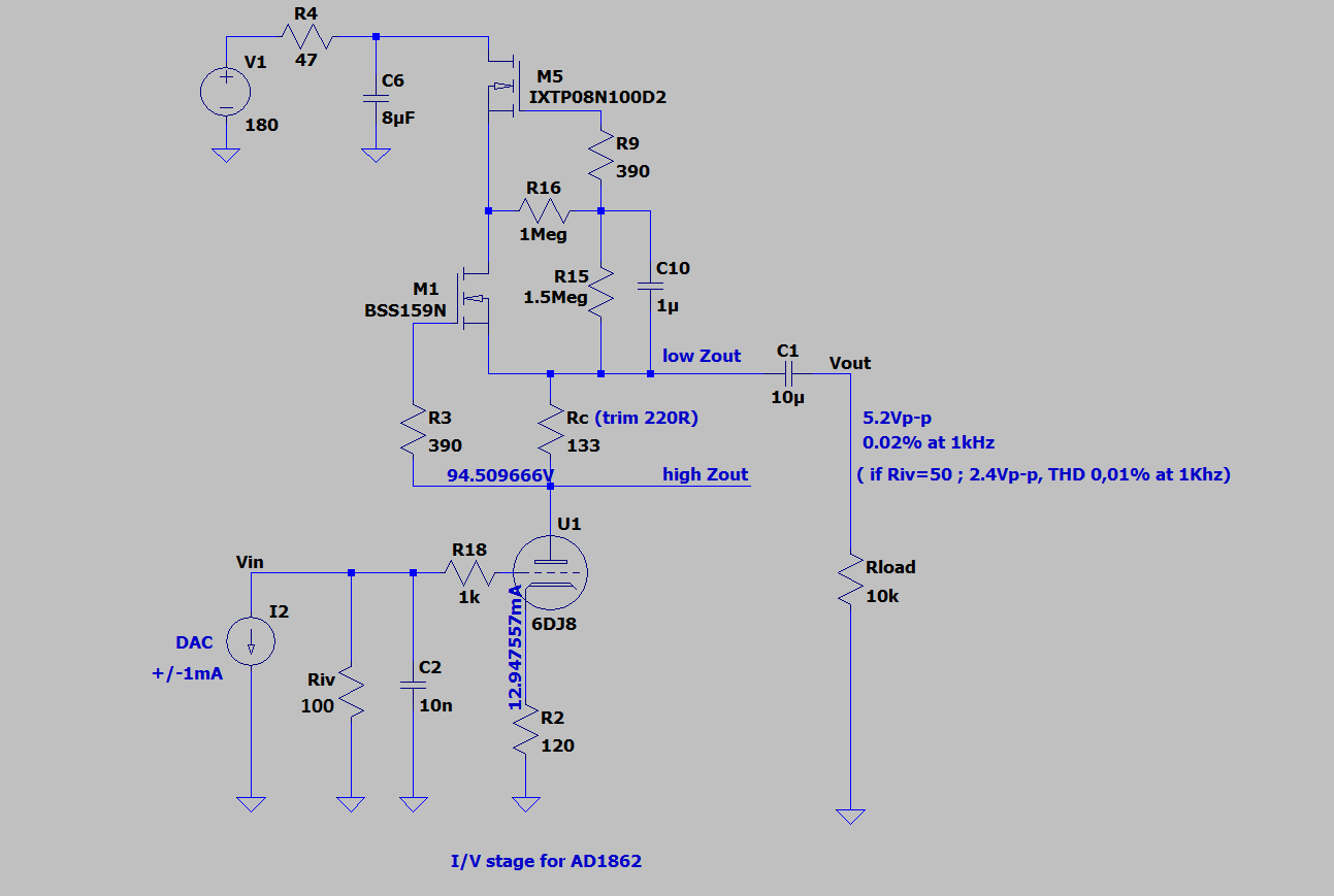

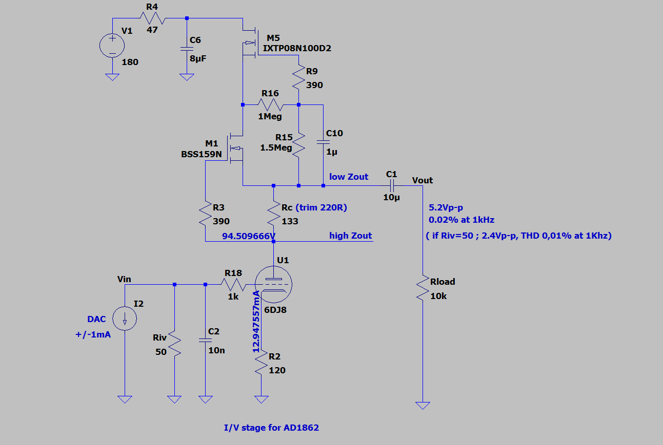

I'm not a fan of SRPP itself because it has to be calculated for a specific load resistance and as such is not suitable for a universal driver. The only solution is another stage (buffer) behind the SRPP, but then there is no need for the SRPP when the classic anode amplifier stage can do it with higher gain and lower THD.
With SRPP, the bypass on the lower Rk increases the gain, reduces the output resistance but increases the distortions.
Thorsten Loesch did not use bypass on Rk, while Zoran counted with bypass.
For example in LTspice for ECC88 if Rk1,2 =1K, Riv=100R ,Idac=+/-1mA , Rload=100k (Rload=10k)
without bypass Vout=2,4Vp-p , Zout=1,5k , THD=0.036888% (0.008638%)
with bypass Vout=4,5Vp-p , Zout=300 , THD=0.146965% (0.146965%)
It can be seen from this that distortions are 4 times higher and Zout is 5 times lower if the bypass is on Rk. However, if Rload=10k(in brackets), then the THD is even 17 times higher if the bypass is over Rk. This clearly shows us the dependence of THD on Rload at SRPP.
Why make it complicated when you can make it simpler, in the end it comes to the same thing. This is just an idea for now. R2 and Rc should be tuned a little more to get a lower THD.
