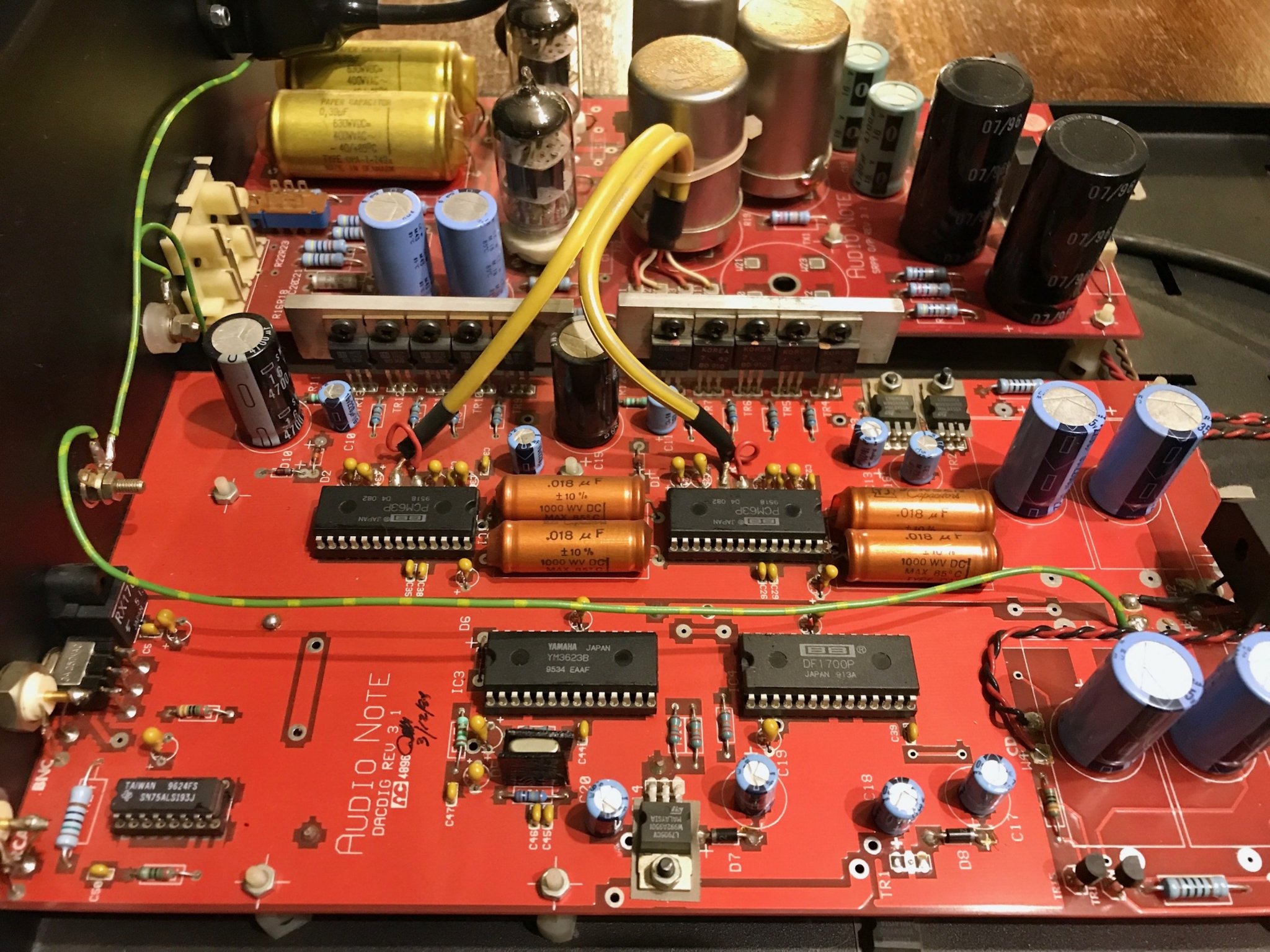

Beauties have arrived 😁

Happylistening, did you read the Loesch paper i linked in the thread about a circuitry with that tube and that chip (that talk about pcm63 and tda1541a etc as well)?
You should be happy with 100V for B+ and something 75 ohms if a lot of gain in your pre amp, to 100 ohms as I/V. Cathode 10 ohms? Hummm better to read the paper.
Put a Grunf reg for B+ et voilà
You can refine it better with a srpp, full tube or hybrid mu follower or even pure CCS.

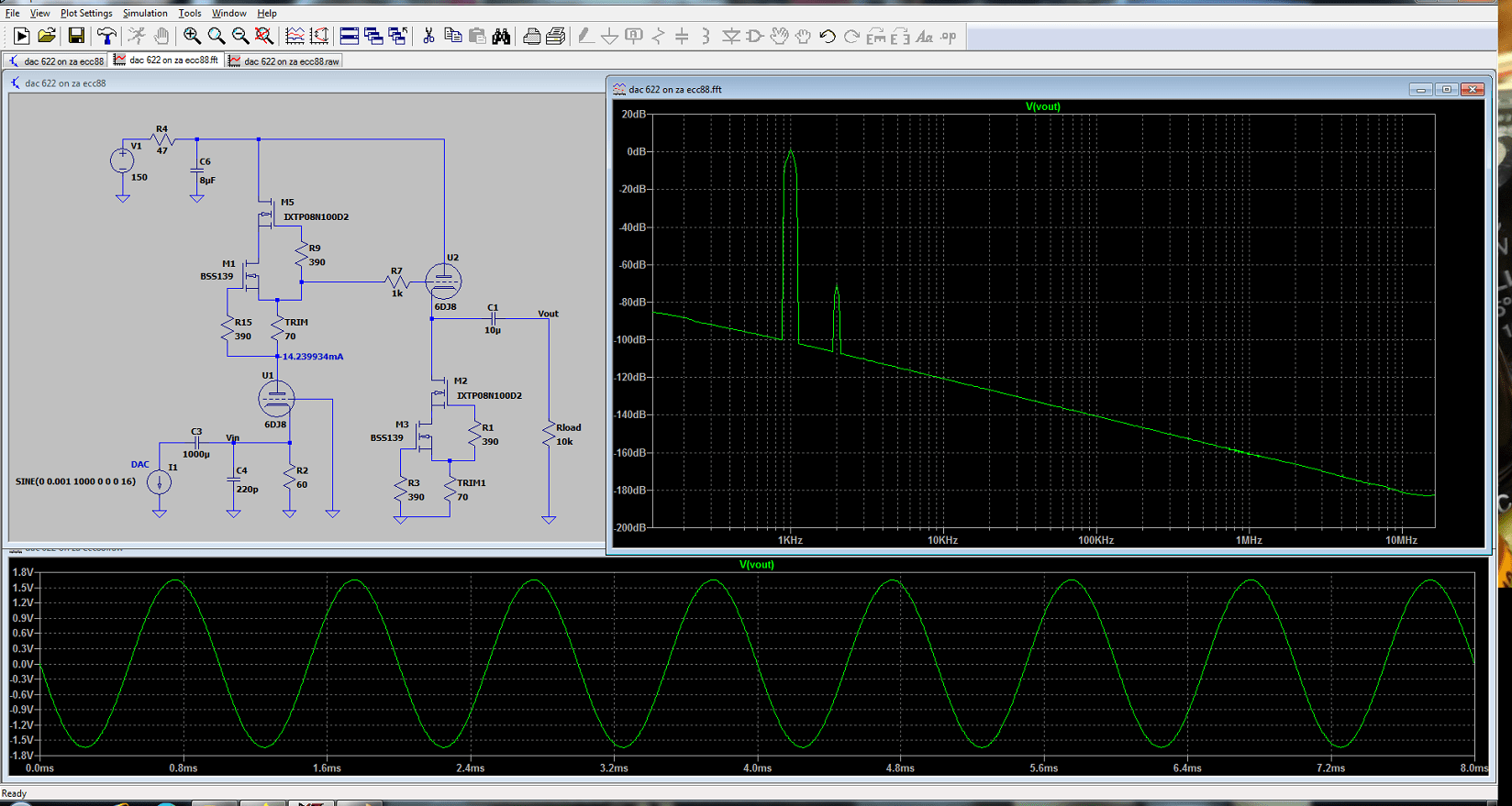

may I ask normally how many gain
Hi grunf,
the ad1862 dac chip provide 1ma current, using 50ohm IV resistor, 50mv output signal will be provided. If 1.5vrms output required and using ecc88, which Vdc value of HT anode supply and ohm value of cathode resistor, the 6.3Vdc of filament provided.
Thank so much
Happy

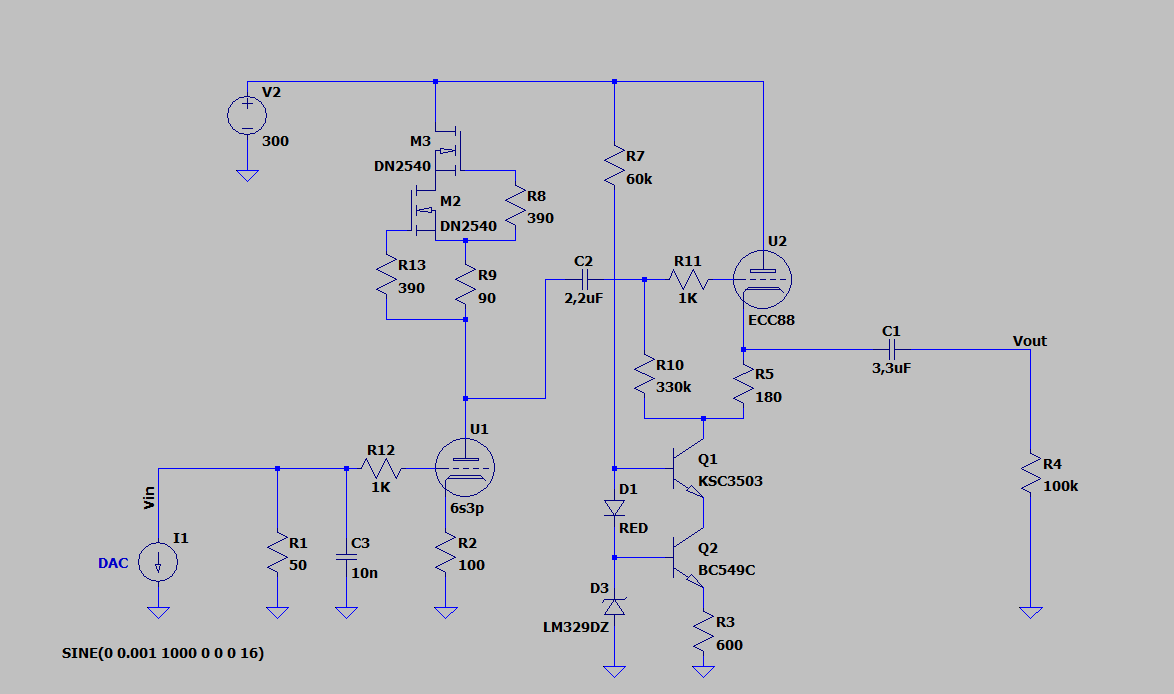

This is just an idea for now, it needs to be tweaked a bit more, but it could be a good solution.
One ECC88 per channel, one half for the ground grid and the other for the buffer.

50ohm I/V resistor and current +-1mA, then you have max. 100mV PP equal to 35mV RMS at the output. You will need a lot of voltage gain to get to about 2V RMS (57x). For that you need something like ECC83, ECC81, 6N2P...

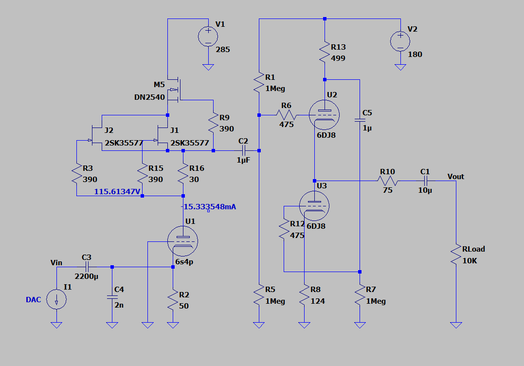

In this case tubes like E180F or 6S3P-EV could be used ( Mu 50-60 depending on application ) ?
Does anyone have some schematics / examples with 6S3P-EV triode ?
6S4P and 6S3P are the same tubes, the only difference is that 6S4P is designed for ground grid and therefore has a different layout of pins and slightly different input capacities.
I used the 6S4P for a long time, it's a great tube.

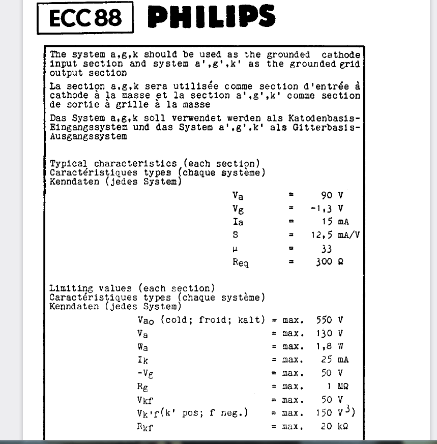

14+mA per ECC88 triode ....... pretty much on too hot side
14mA is not a problem at all for ECC88, it only plays well at higher currents, 10mA is too little to get the maximum out of it, but at higher currents there may be problems and it should be treated like an RF circuit. DIYers can fall into that trap and then say that the ECC88 plays worse at higher currents.

The tubes have specific anode curves and other important datas.
Design must be exclousively be with this datas. For each specific tube model.
Totally wrong way, repeating for decades, is guessing.
followed with generalisation, and wrong persumptions.
It is a real mistery 🙁
"No one bothering with datasheets and graphs"
inspire of that it is not a rocket sciense to choose, calculate, and build
a very good design within already present and given manufacturers datasheet informations.
for needed purposes in the equipment
That pretty much agrees with what I wrote. It is unclear to me how to practically implement Ia=6mA and -8.5V grid voltage. A very high B+ there. I would like to see it practically through some schematics. They did not provide a diagram of the assembly in which the measurement was performed.
this is not complete information set because it is not stated amount of input level signal, input source resistance, anode load, load at the output and other factors that impact the performances.
