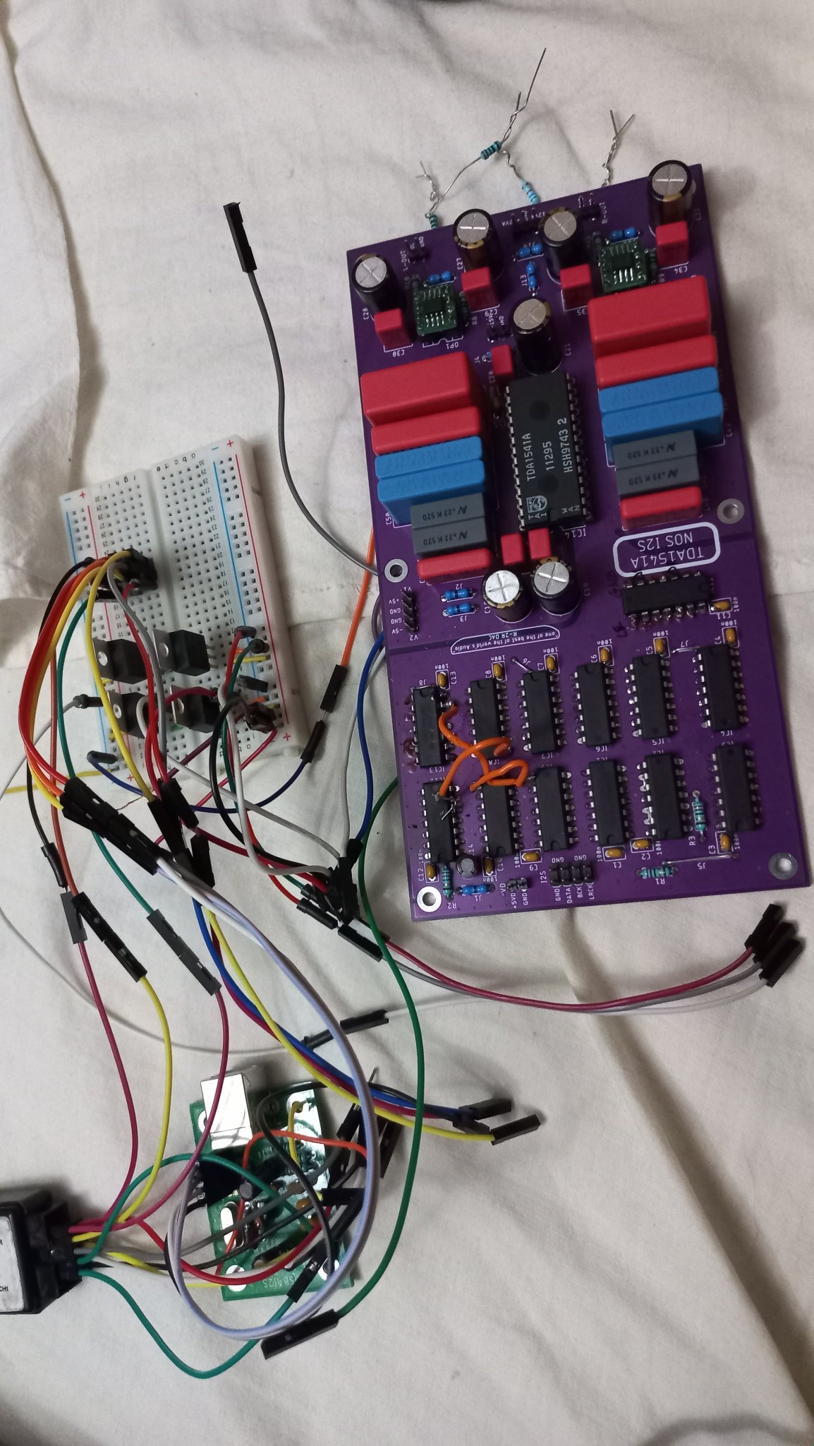

My prototype of the TDA1541A plays quite well, nice clean output
Time to buy out the whole eBay and rise the price of this DAC even more LOOL 🤣
- no digital filter, NOS
- full THT with glue-logic to maintain the nostalgia
- simultaneous mode (I2S input)
- big foil capacitors
- power supplies will be on the PCB (78/79xx regulators)
- opamps remain for the I/V
My prototype of the TDA1541A plays quite well, nice clean output![]()
Amazing. Another great DAC design, that you also found time to build. Nice TDA1541a chip too 🙂
I hope you dont mind me asking the usual silly question: do you think you can hear differences in music intrinsic to the TDA1541a vs AD1862, despite all the differences in power and output stages?

That's great news. There are not a lot of good tda1541 pcb's with these specs. around exept for Ryan an Pedja. I have a S1 waiting.
I now it's a proto but the uf.l are not critical?
Same for the AD1862?
Btw. what would be the size of the pcb circa? I'm now building a ad1862 "streamer". It would be nice if i can change boards without changing the lay-out of the rest of the parts to much.

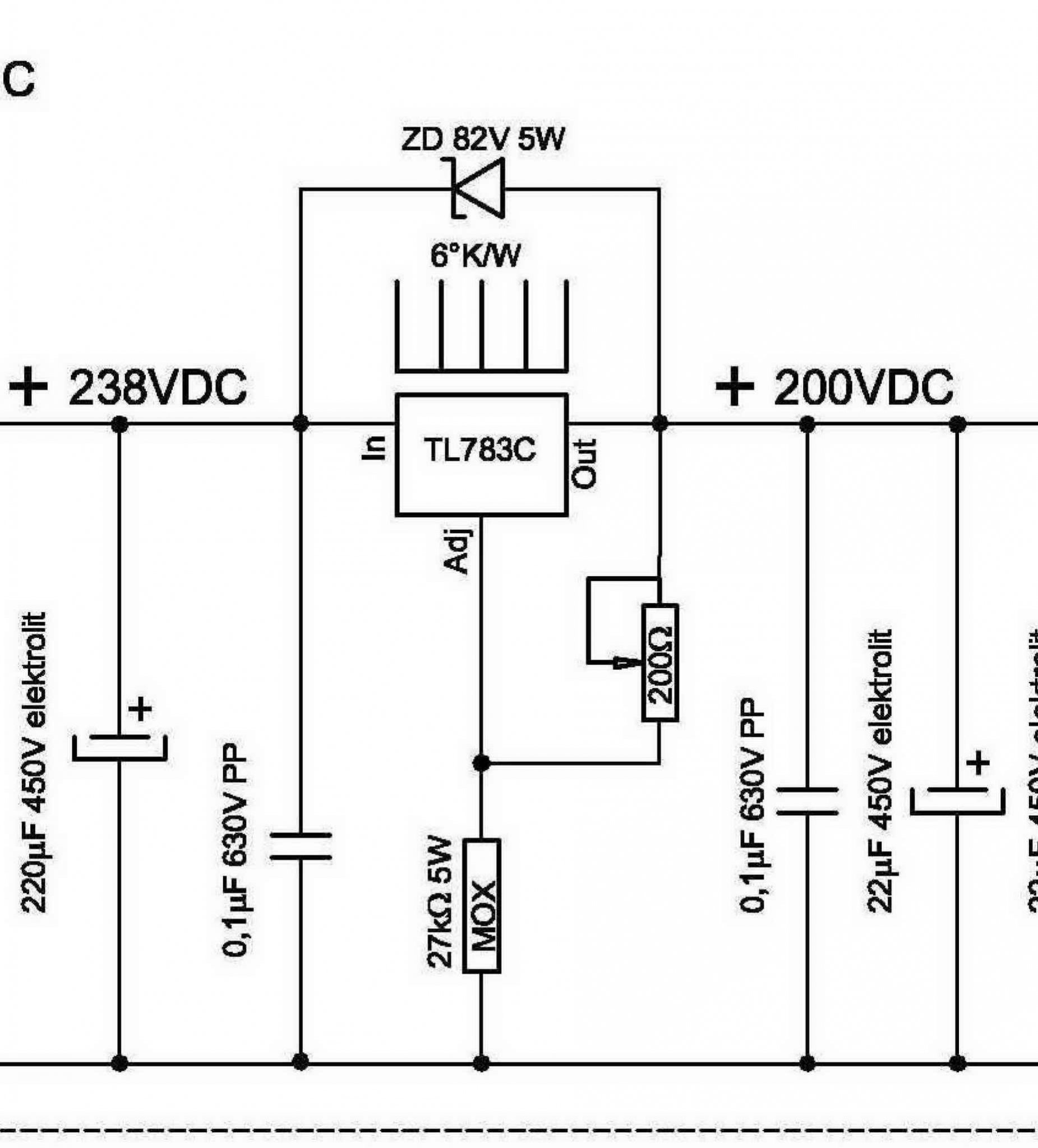

TL783C, if you find original one somewhere, because it is no longer made.Hi grunf,

The implementation is simple, like the LM317. A protective zener diode (80-100V 5W) is required. In front of regulator I suggest a CRC and a transformer with a secondary 230VAC 0.15A (for 265V DC).

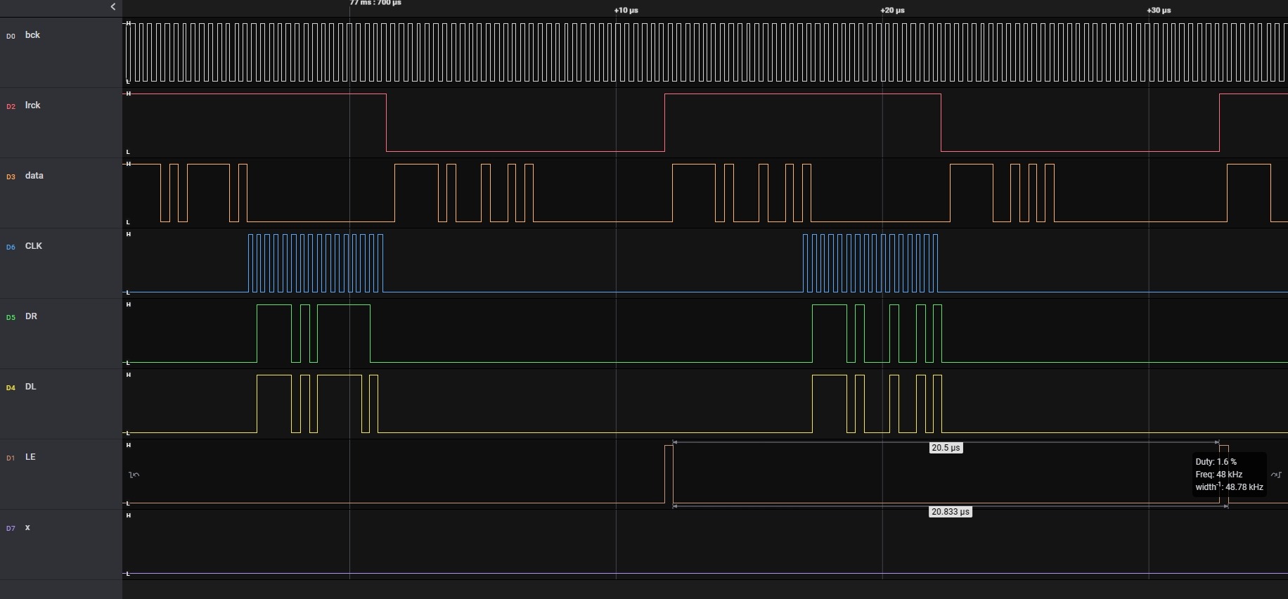

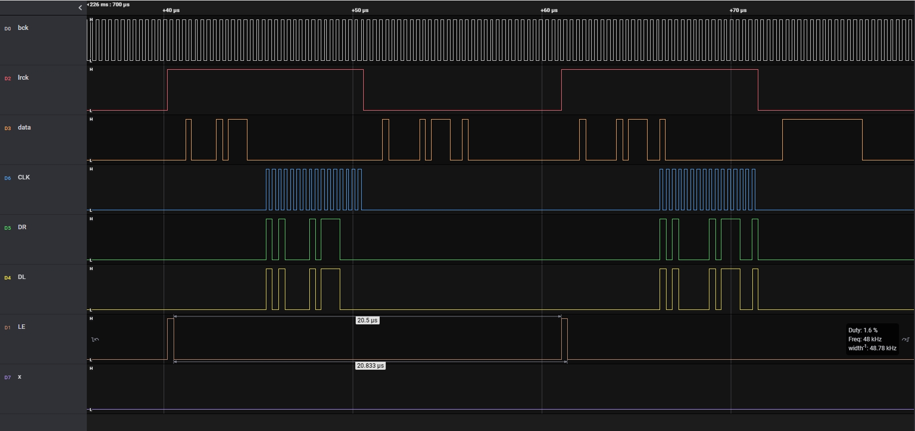

I am finishing some universal logic ICs I2S format interface to almost "every format".
Could be used for diskrete DAC R2R ladder too.
- data in the middle position between the LEs
- Stopped clock opperation
- MSB inverting option
- inverted data
- 14bit to 32bit word option
note in the datasheets that for TDA1540/41A TimeSim format
- BCK is inverted and conversion starts when 0 to 1 transition of LE
- MSB must be inverted
- BCK not inverted rising edge for MSB and conversion starts when LE going from 1 to 0.
_ MSB remains the same value

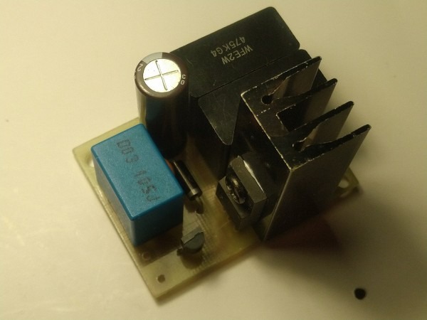

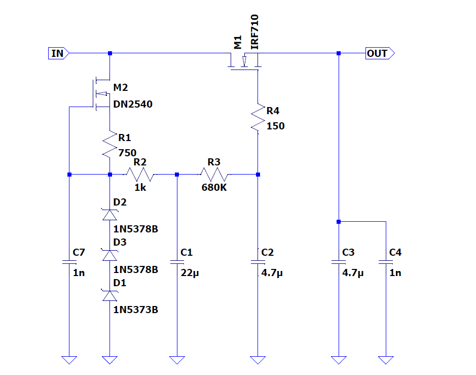

Try the ECC88 instead, the 6N6 has a lower gain and is better as a buffer or line stage.Then the supply voltage will be lower (180V). I recommended the same to Vunce.
You can make a simple power supply or regulator according to this scheme, the sum of the zener diodes should be approximately the output voltage (Vzener=Vout + 4V) , I made it on a small PCB with smd resistors, the DN2540 can be in a TO92 case. M1 can be any n-mosfet for voltages higher than 400V and for lower currents .This reg is made for the ECC88 in my DAC.
You can also add protection diodes to M1 and a film cap of 2.2uF (or similar) to the input of the regulator.
It's too early to say, but I think AD1862 get nice competition. The battle will be very subjective and very interesting 🤣 ... this DAC has something in it, it really sounds nicely 👍
@Arnolddew
The size of the PCB is minimum: 190x90mm without power supply, or 190x150mm with power supply (can be more or slightly less). uf.l may be on the PCB.
@Zoran TDA1540 is slightly different from TDA1541A ... BCK is inverted for both, but TDA1541A must see the stopped BCK on the 0 (TDA1540 is 1), otherwise the LE is not accepted (this took me a few days to figure out because I used the BCK logic from TDA1540 and it did not worked even though the signals were aligned) 😉

If you decide on TL783C, for 265VDC change 27k 5W to 33k 5W and trimmer 200ohm to 150ohm (or serial connection of 100ohm resistor & 50ohm trimmer).
