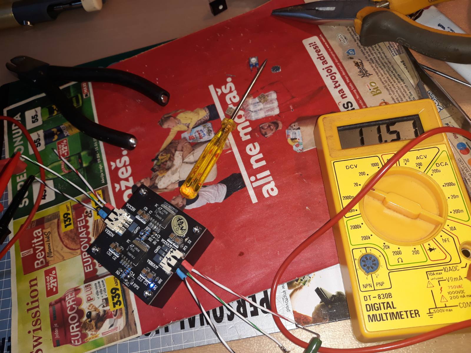

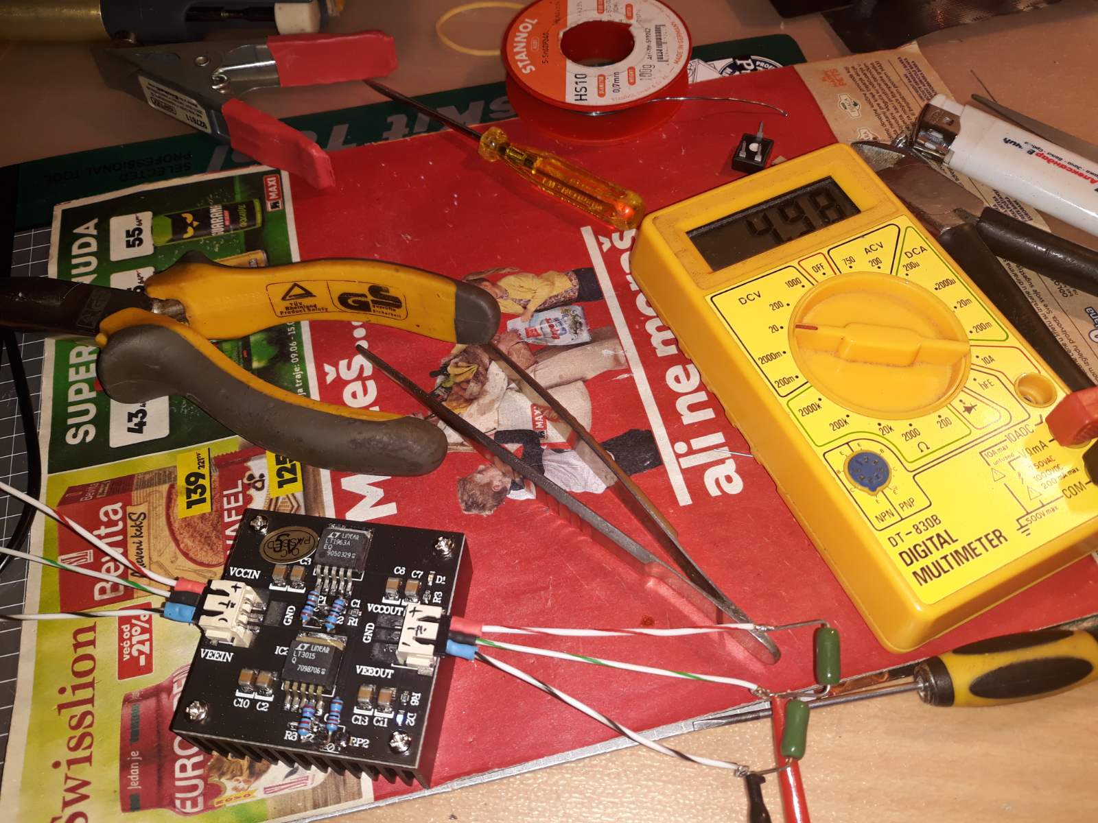

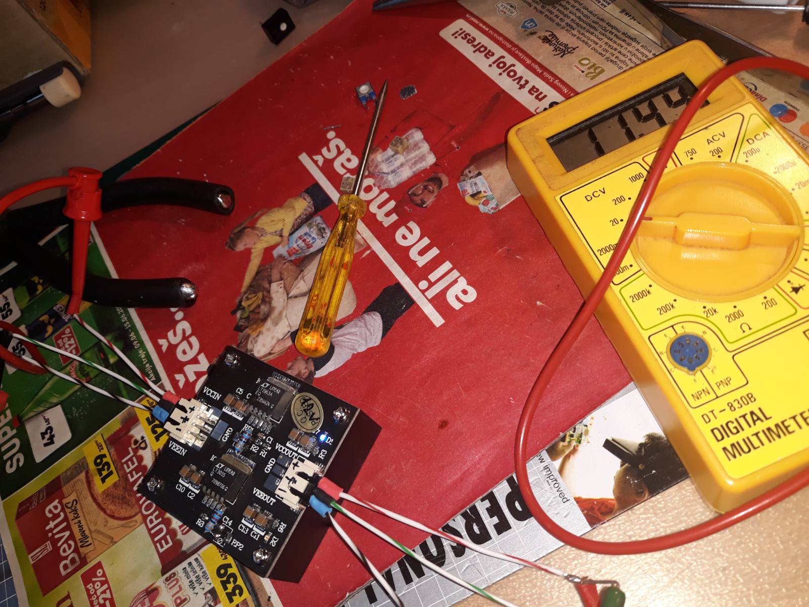

I used fixed resistors that I had. I achieved +-4.98V, +11.44V and -11.51V. I can adjust more accurately, but I don't care if it's 12V or 11.44V/11.51V on the Sparkos.
Here are the pictures. All values are the same for positive and negative LDO. I removed the silly little SMD trimmers and put in fixed resistors.
