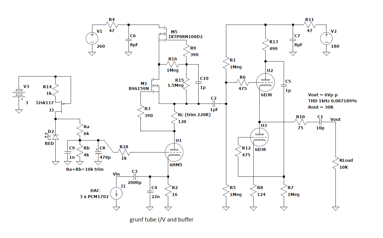

I didn't know that, from the last posts here I got the impression that tubes are a taboo topic. My apologies.
In that name, I am attaching the scheme that I currently use, and it is certainly two spears better than the one you posted. It is true that it is a little more complicated, but the effort is definitely worth it.

No No Grunf, don’t stop tube talk!! I’m currently working on a 6n6p output stage and experimenting with an SMPS for HV/Filament power.
There is more than one way to skin a cat as they say, tubes are just another flavor 🙂
NO with SMPS for HV/Filament power
Soon I will publish the scheme of the HV regulator from my DAC, it is not simple, but honestly all of it can be heard in the final sound. I have been playing with it for years and so far three have been made and two of them are used by my friend for phono and for DAC and he is very satisfied.
