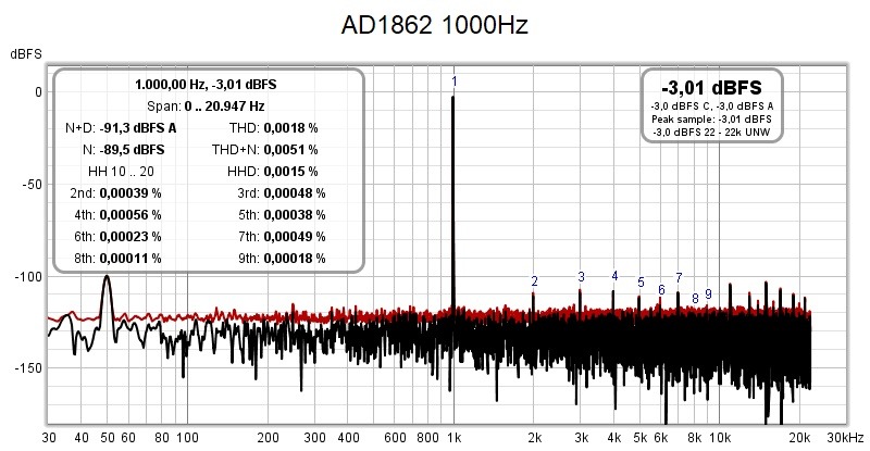

I did some distortion trimming with my AD1862 and got some nice figures - brought it down by not far away from 20 db 🙃.
Ernest, I‘m hoping to get some clarification regarding your MSB-trim distortion reduction test results. I presume that your chart shows the DAC’s distortion AFTER the nearly 20dB of reduction due to MSB trimming. So, the AD1862N un-trimmed distortion was nearly 20dB higher. Do I have that correct? Thanks.

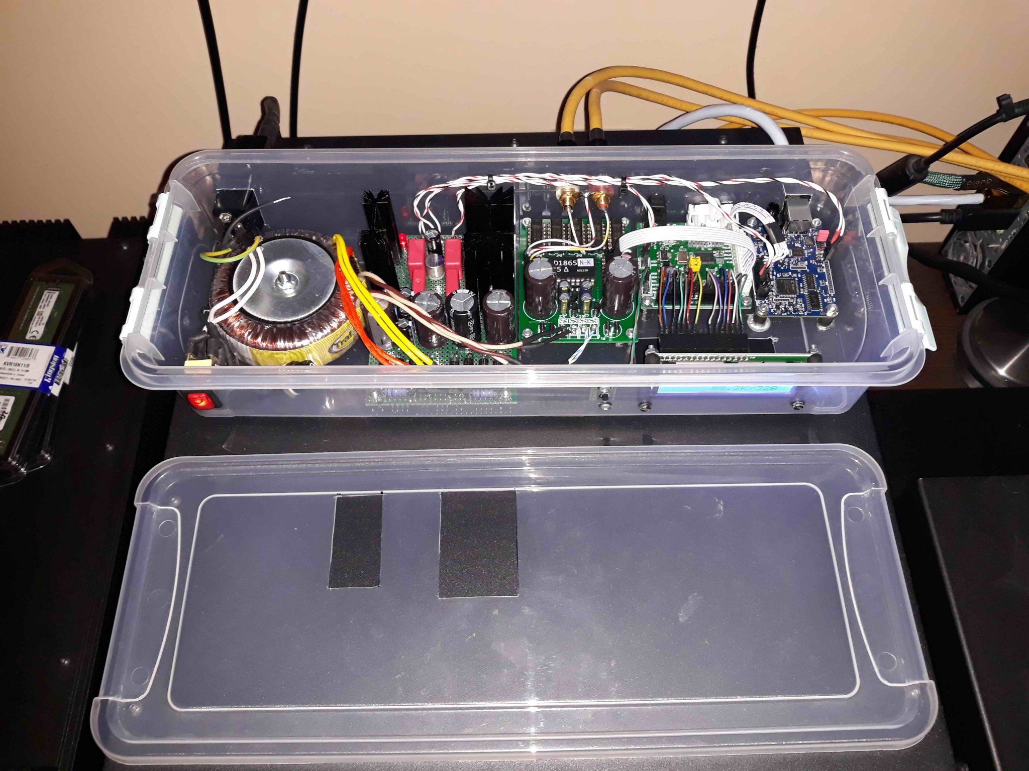

Let's say what can be done for around 250eur without the box. I packed this as is for fun, just to hear if it plays well. Pavouk AD1865 with I2S input, JLS I2S over USB board, AK4113 SPDIF/I2S board from ebay, power supply with two LM1117T-5.0 for JLS and AK. So I have two SPDIF inputs, TOSLINK and USB inputs and a small display that shows the active input, frequency and bitrate.
The AK board has an I2S input that is selectable by a button (key 1), and I2S output. SPDIF/TOSLINK inputs are selected automatically according to which input is active. The board should be able to be set so that the SPDIF/TOSLINK inputs are selected with a different button (key 2), but I haven't tried it. Powered by +5V - 50mA.
https://www.ebay.com/itm/284351999799
The sound is not at the level of Miro DACs, but the price is really low and it can be listened to without getting annoyed.
I also got a Bluetooth 5.0 module on ebay with I2S output, to try how it sounds (I will install it instead of JLS). The plan is to build a cheap Bluetooth only DAC (or AK4113+Bluetooth 5.0) with the Pavouk AD1865 DAC board.
https://www.ebay.com/itm/284170951663

Hi Ken, you are perfectly right. Yet my nearly 20 db for sure was slightly exaggerated. Initially it was slightly more than -90 db and after the procedure it went down to what you see in the attachment. K3 might be at -107, K5 just below -110 db. So probaby "went down by 15 db" would have been more correct, yet I was so happy by what I saw. I will follow up this in the answer to Patrick. Cheers, Ernst
Then must be something wrong with the chip, or the distortion analyser.
When using K grade, we have had practically no gain in trimming.
You can compare K grade spec to yours (whatever grade they are) in datasheet.
And only changes H3,5,7, ... etc.
Patrick
Patrick, a few things I want to mention:
The distortion analyser was REW, interface was Focusrite 2i2. A second try was done with ADI2PRO and it gave roughly the same result.
I did not measure the DAC without the resistors and the trimmer. So the naked DAC might have measured better before.
The chips were used and did not come from rochester - I had ordered them via ebay, as long as they were available well below 10 Euro. I had ordered 4 and 3 of them were working examples, even they were not look promising.
My chips from Rochester I had put into a design, which does not allow trimming. Their look was much more trustworthy.
After the trimming - apart from PSU noise - the DAC is close to the spec in my eyes.
Cheers, Ernst

Okay, thanks. I must say that I'm surprised that there was such a significant improvement for -3dBFS test signal, as the data sheet suggests there would be little to none for a test signal so close to 0dBFS. Do you happen have the distortion improvement charted for a -60dBFS test signal, as prescribed in the data sheet for MSB-trimming? Also, were the test signal samples 16-bits, or 20? Thanks, again.

Ken, as Patrick pointed out, I should have done a measurement before soldering the trimming circuit in order to do a meaningful comparison. My bad. Yet a good day for learning something new 🙂 The same could be said for the -60 db signal level, which I didn't respect - haven't read - didn't know. Will do next time - either with lifted resistors legs or with a newly built DAC. For me at least the figures and the sound of my DAC are good enough ;-)
About the bit depth. I think, it was 16 bit, as I used the java driver within REW. At this point of time I wasn't aware of FlexAsio. And after my info, the Java driver is just 16 bit capable.

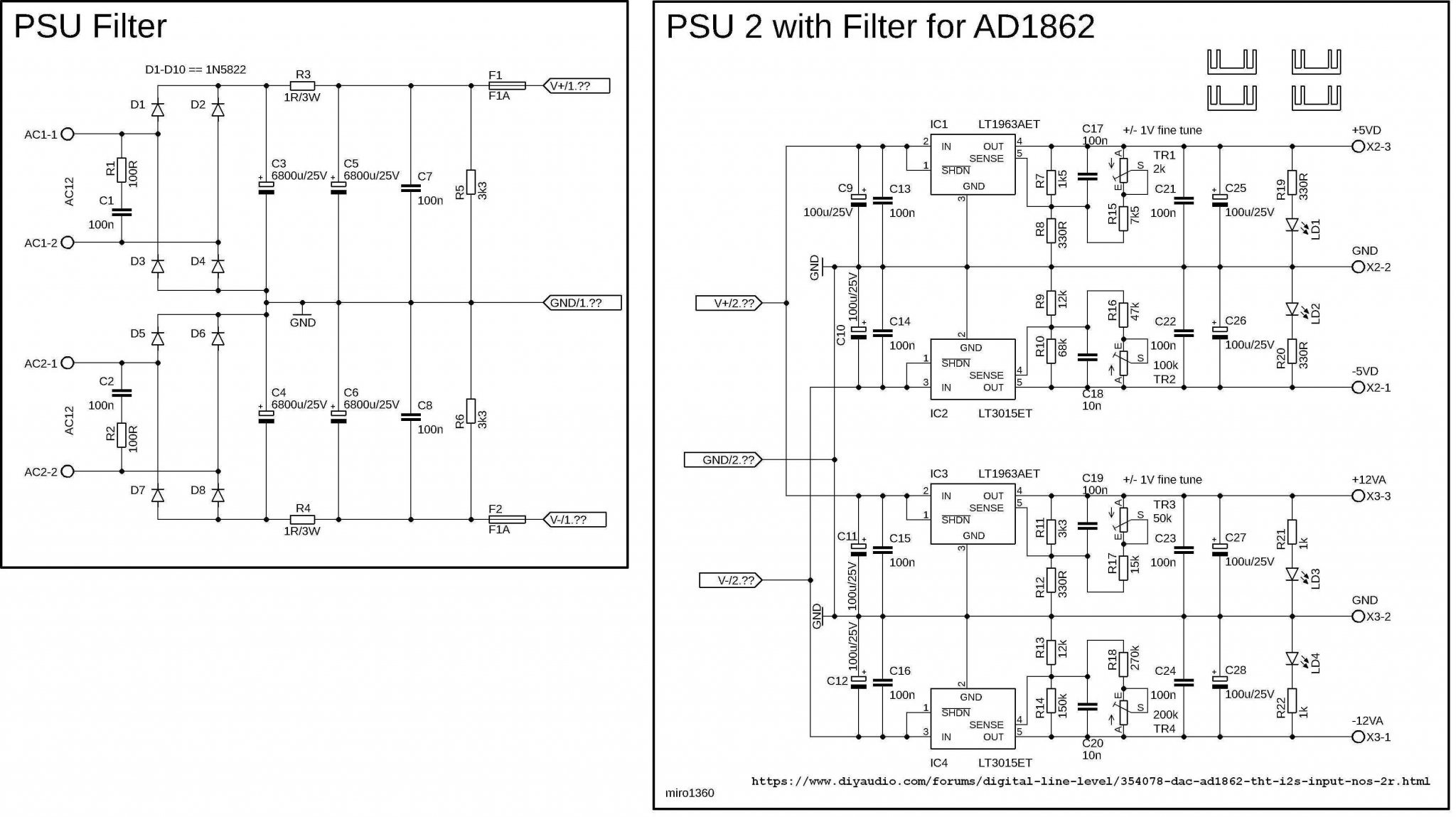

On the PSU2, resistor and trimmer values are not the same with LT1963 and LT3015. Can I use the same values for the plus and minus sides, with all values as for the LT1963?
At iso voltage output these two ic do not need the same resistors values, hence the difference. On the PSU 1 or 2 you can of choose two different symetric outputs with the rigth resistors values plus the rigth trimming pots.
E.g, : 2 x +5/-5 V ; 1 x -3/-3 V and 1x + 9v and -6V as there is a zero ref and the ref is shared with the load. Symetry or not is up to you and you can feed a non symetric load, each lt19 and lt30 is independant and share just ground with the others pairs.
With the PSUII miro's bom you have a margin of around 1v with the trim iirc. For different voltage see the datasheet of the ics. Is it what you are asking ?
