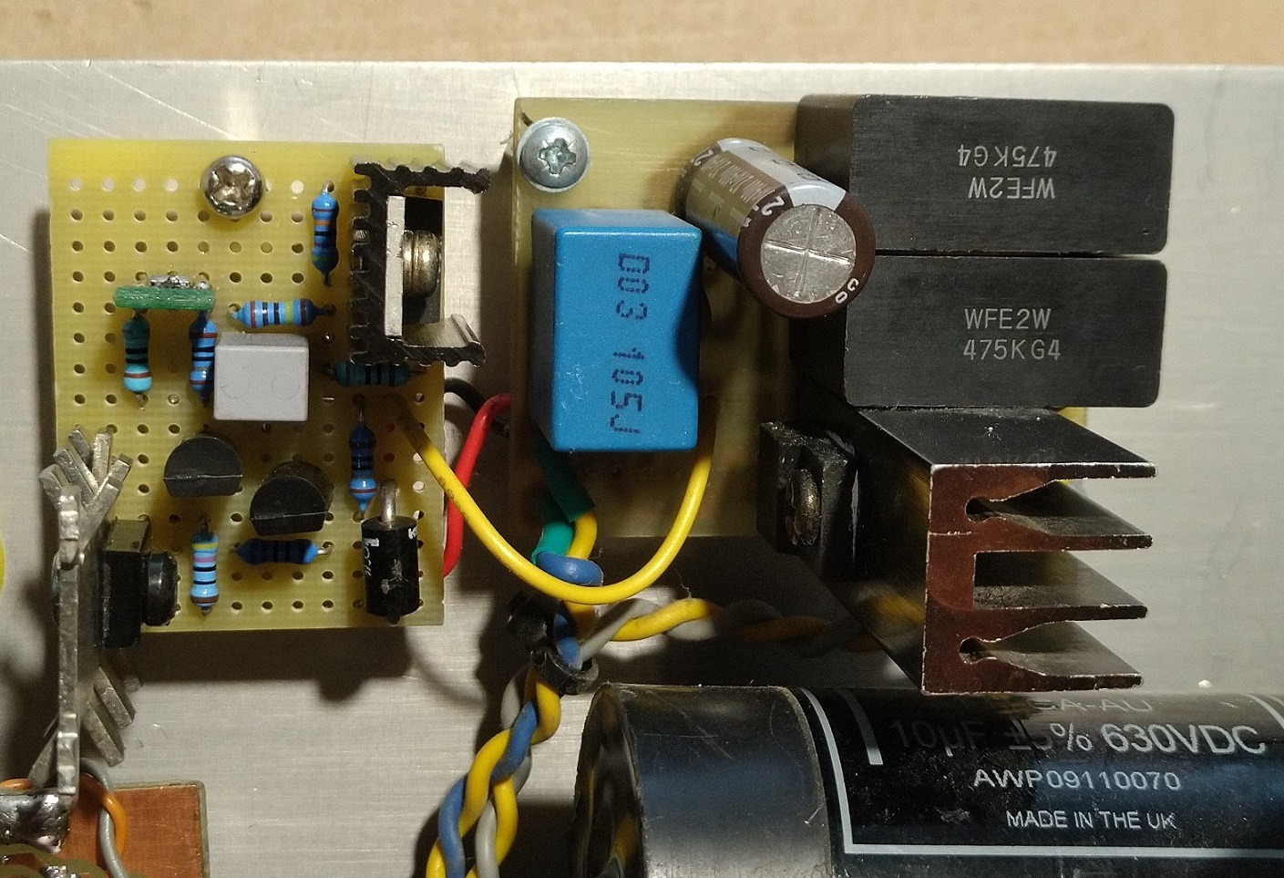

PSU 2 not only for AD1862
PSU 2
is based on LT1963A/LT3015 LDO regulators.
Why I chose these regulators? Letting DIY people only on 78/79 regulators would not be fair, so I was searching and found an inspiration in this test:
A-comparative-overview-of-power-supply-regulator-designs-with-listening-tests
In the basic configuration, components are set to output the +/-5VD and +/-12VA for AD1862 DAC.
These regulators are adjustable and are set via resistors and fine tuned using a trimmer.
Again, the output power and heatsink is a DIY question, but since the AD1862 DAC consumption is small, it should go without heatsink :cold:
PCB size is 75x150mm and is universal - you can solder components for any other DAC voltages.
It can be cheaply ordered from jlcpcb or any other PCB manufacturer.
(it was not tested at the time of writing this post)

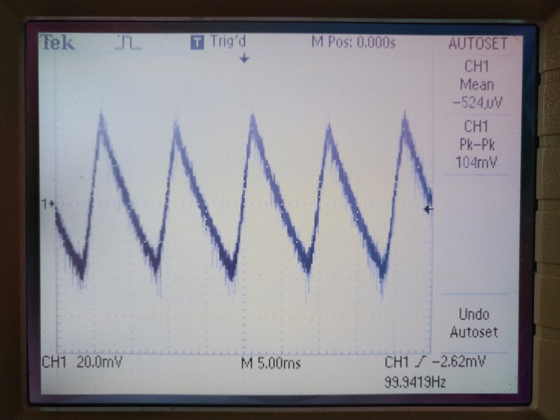

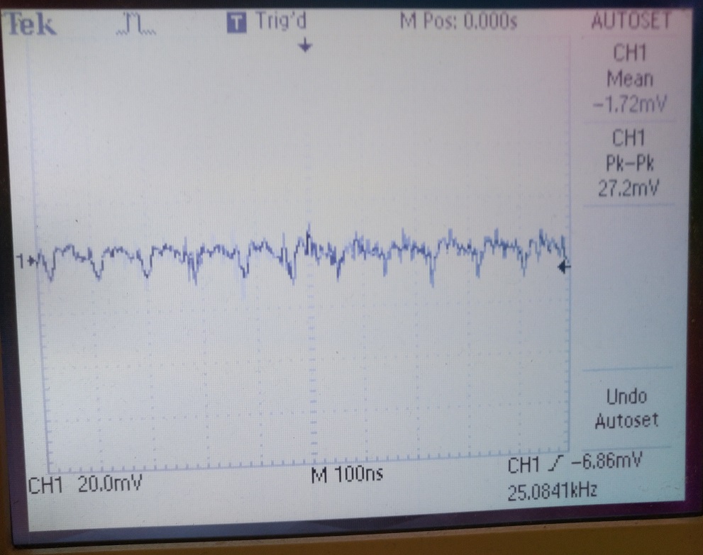

For example, I would insert ADP7118/ADP7182 on miro's PCB instead of jumpers in the power supplies and keep the original power supply with LT3015/1963, which would then be pre-regulators or put a CRC filter in front of LT3015/1963. Below is an example after adding the CRCRCRC filter before ADM7151 in my DAC.
How many tube I/V stage can you make? 😉
right now, with the tubes I have, I could make 4 sets of I/V stage 😉
