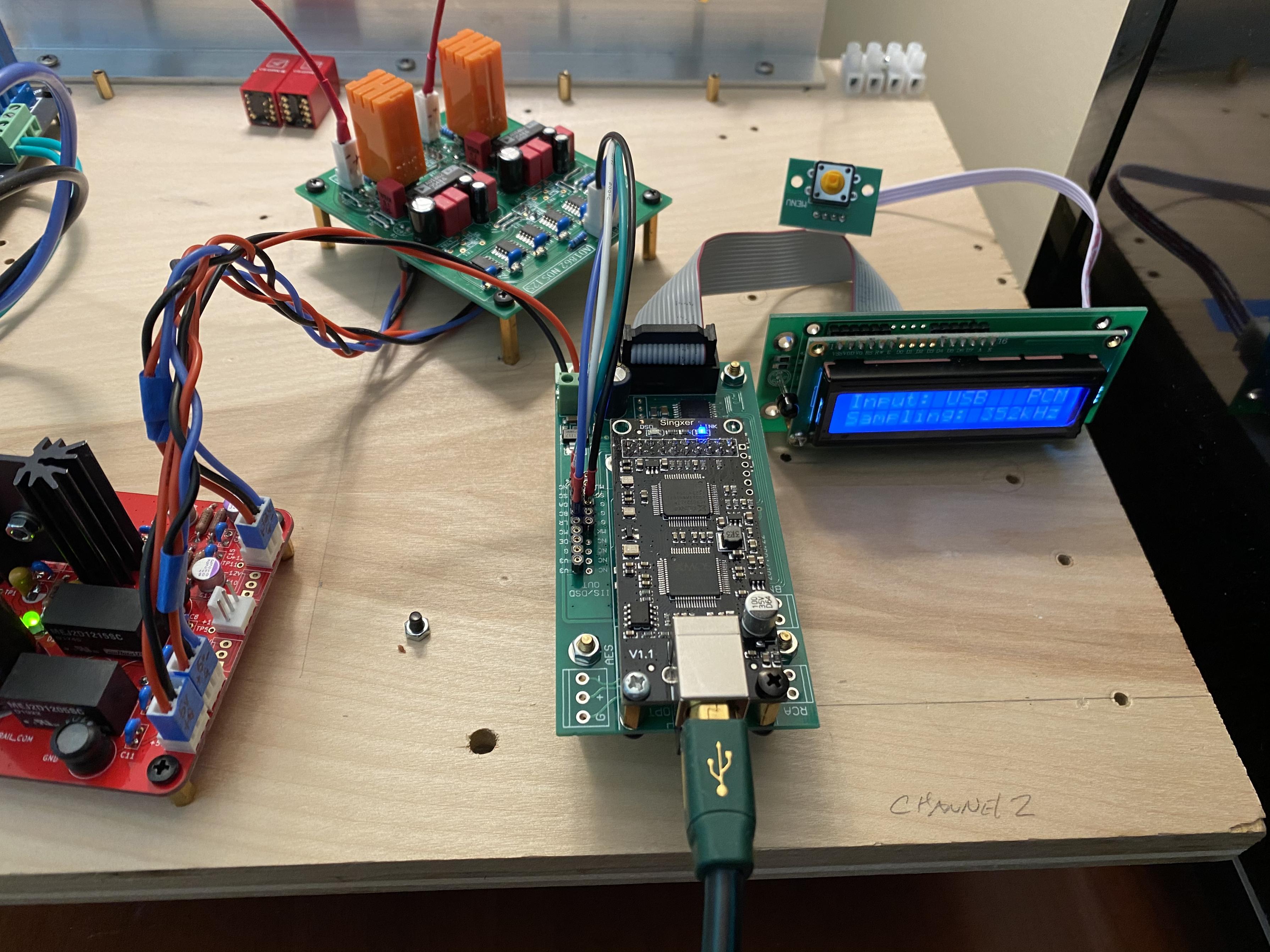

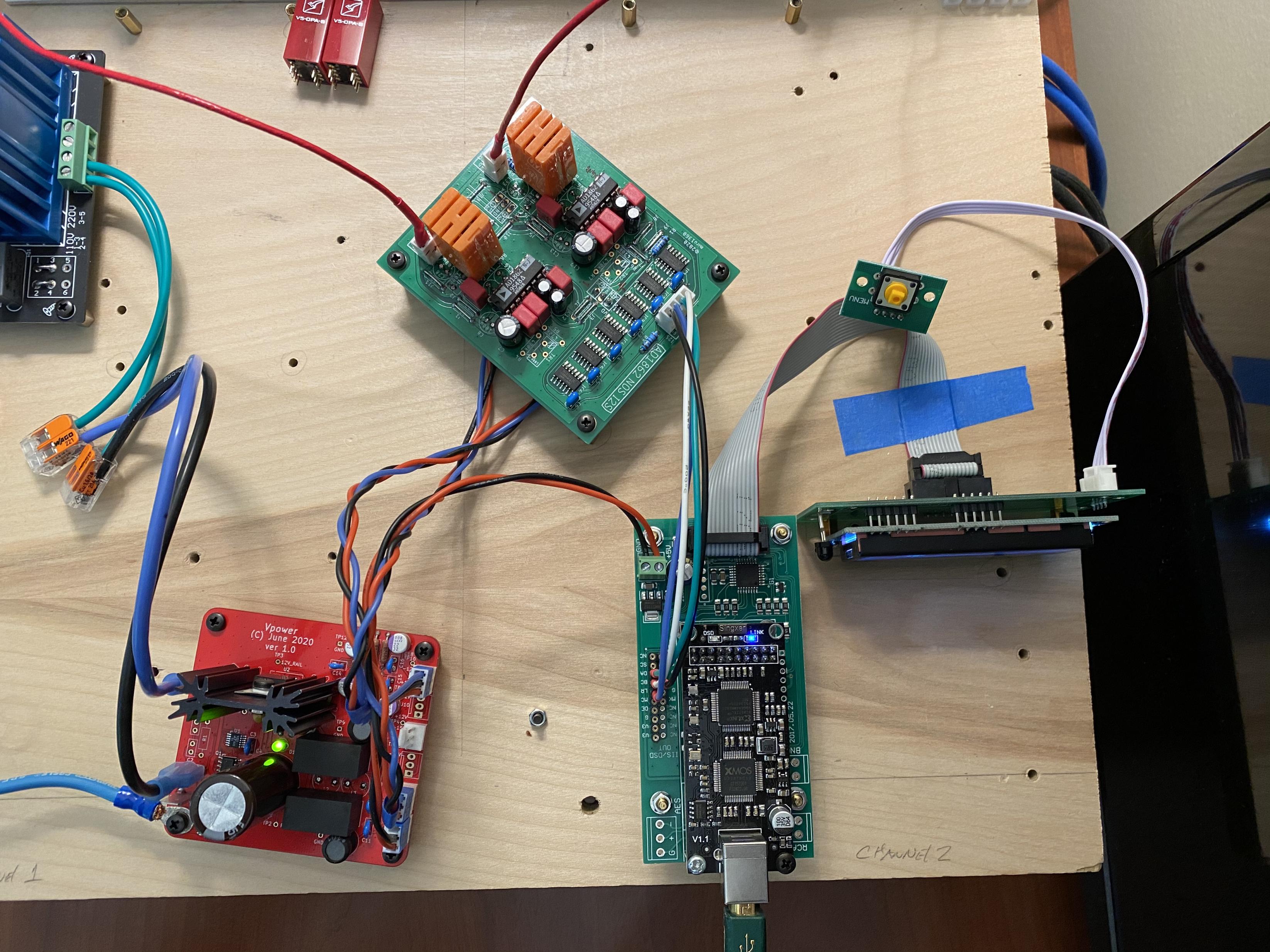

The Digital input selector based on the AK4118 chip arrived. It has SPDIF x4 + USB x1 inputs to I2S output with a screen that shows locked status and sampling rate. Works very nice! No pops/clicks when switching inputs either 🙂

I got this set-up fired up at 2AM 😱
I only switched between optical and USB and listened for a short time to confirm all worked as it should. I’m also curious if there is any sound degradation between SPDIF signal and USB to I2S.

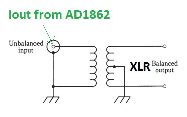

The trafo also needs an I/V resistor, either in parallel with the primary or secondary of the trafo.
Not sure of the advantages of having it on primary or secondary, I think if the primary winding resistance is too high the IV resistor must be on the primary.
My trafo does not have centre tap on the secondary and it can still drive a balanced input, not sure if thats possible with all trafos though.
The trafo is an awfully expensive option and probably wont outperform either a passive IV resistor without a trafo or op amp IV, simply has its own set of compromises.
The trafo is probably the most ''natural'' sounding but the least transparent option to my ears.
Actually ''least transparent'' is not really accurate, least consistently transparent would be more correct, it depends a lot on the music how well it performs.
