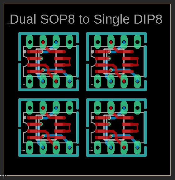

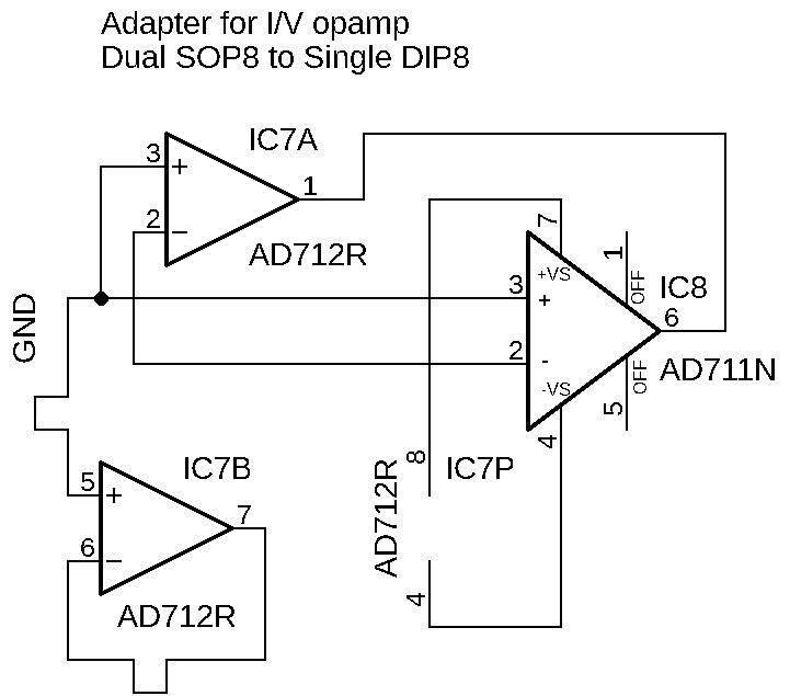

OPA1688 is dual, use a dip adapter dual to single
Bloody hell, you're creative as says JosephK 😀 ! Where can I find this marvelous adaptator you're talking about please ?
