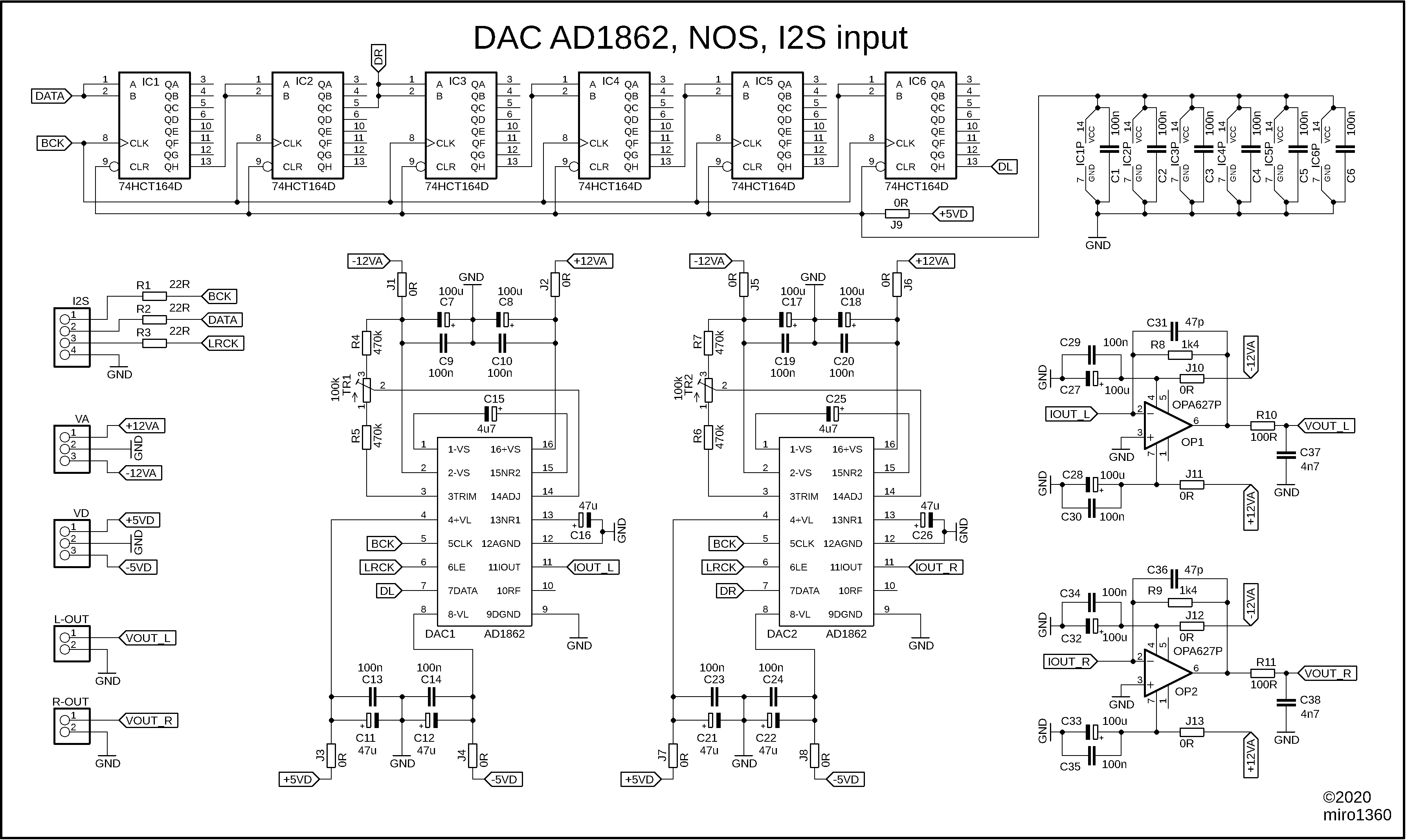

DAC AD1862: Almost THT, I2S input, NOS, R-2R

AD844 can be experimented with this pcb. Only thing to do is 'not populating i/v components and soldering 1.5k&1nf cap from pin5 to ground', using ad844's internal buffer from pin6.
Output offset can be easily trimmed with 20k across pin1,7,8. if its necessary..

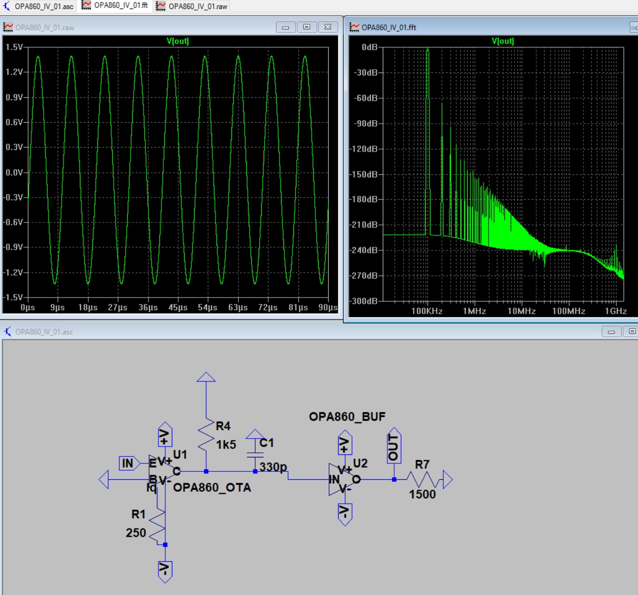

I’m getting background hiss from the speakers that can be heard from 4 feet away, no hum. Possible oscillation? DC offset is very high 100-120mV. With music playing there is audible distortion. When R4 was increased to 2K4, there was no increase in volume output.
I checked and double checked for errors with my implementation of the OPA860 circuit, it’s good, No shorts or solder bridges.
I will try a different location for R4 &C1 GND point. Currently they are tied into the vacant C37/C38 ground pads.

I haven’t given up yet though, I will try to bypass the onboard OPA860 buffer, essentially making it an OPA861. (Those are also on the way 😉)
But, OPA861 IS a high speed circuit and care should be taken
"The 860 does get hot." - - A tale telling sign..

Also, the input stage base would need some hundred ohm (called Rs in the data sheet). (if You look carefully, the datasheet prescribes these 'damping' resistors at both places (Rs - 20ohm-250ohm), at the OTA input stage base; at the input of the buffer stage.

Then, try to place a small smd ~10nF (or 100nF or between) directly on top of the smd chip, between - Vee and +Vcc (+_5Vpins, pin7, pin4).
All these things are needed, in reality, to maintain good stability..
