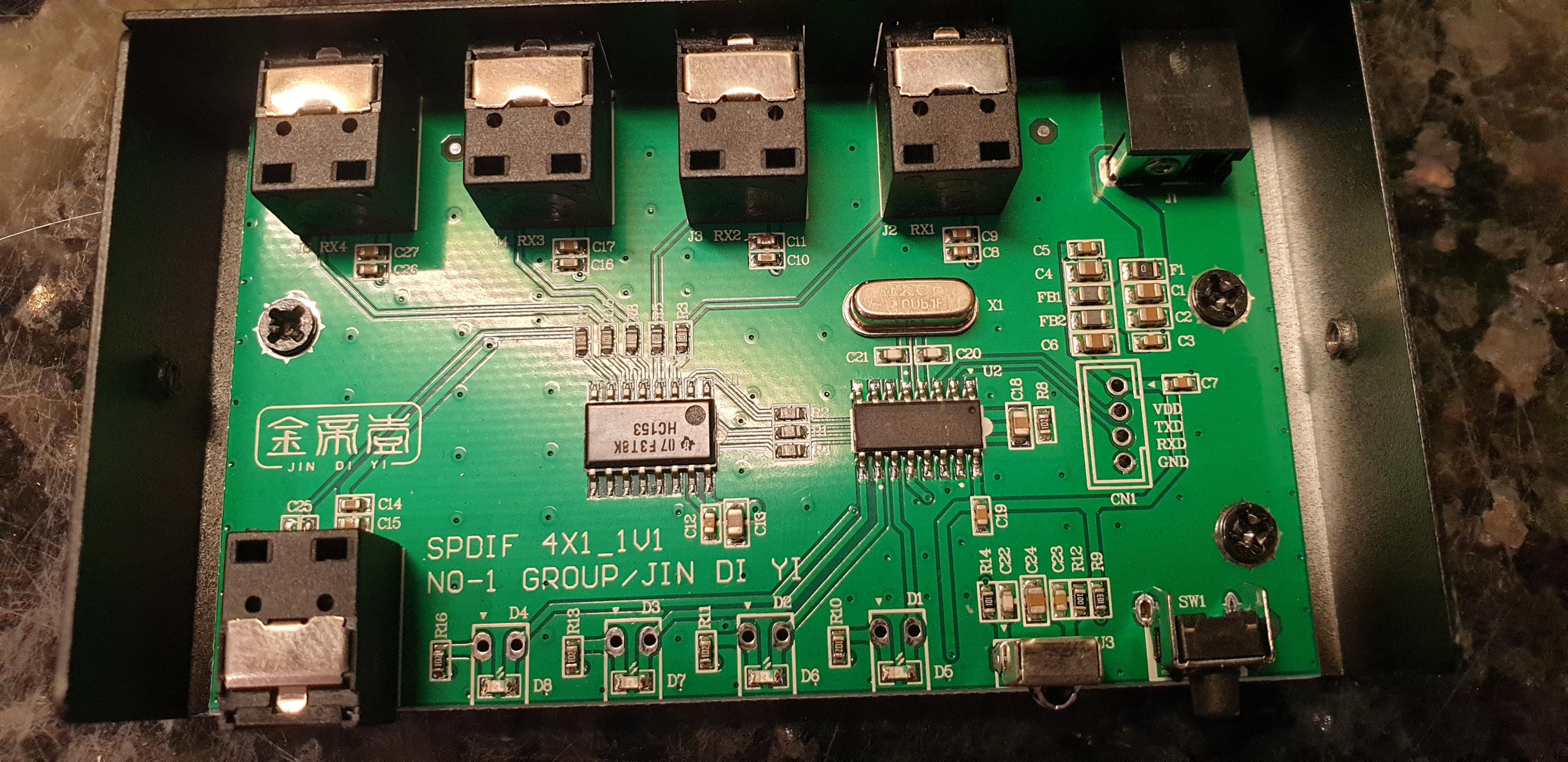

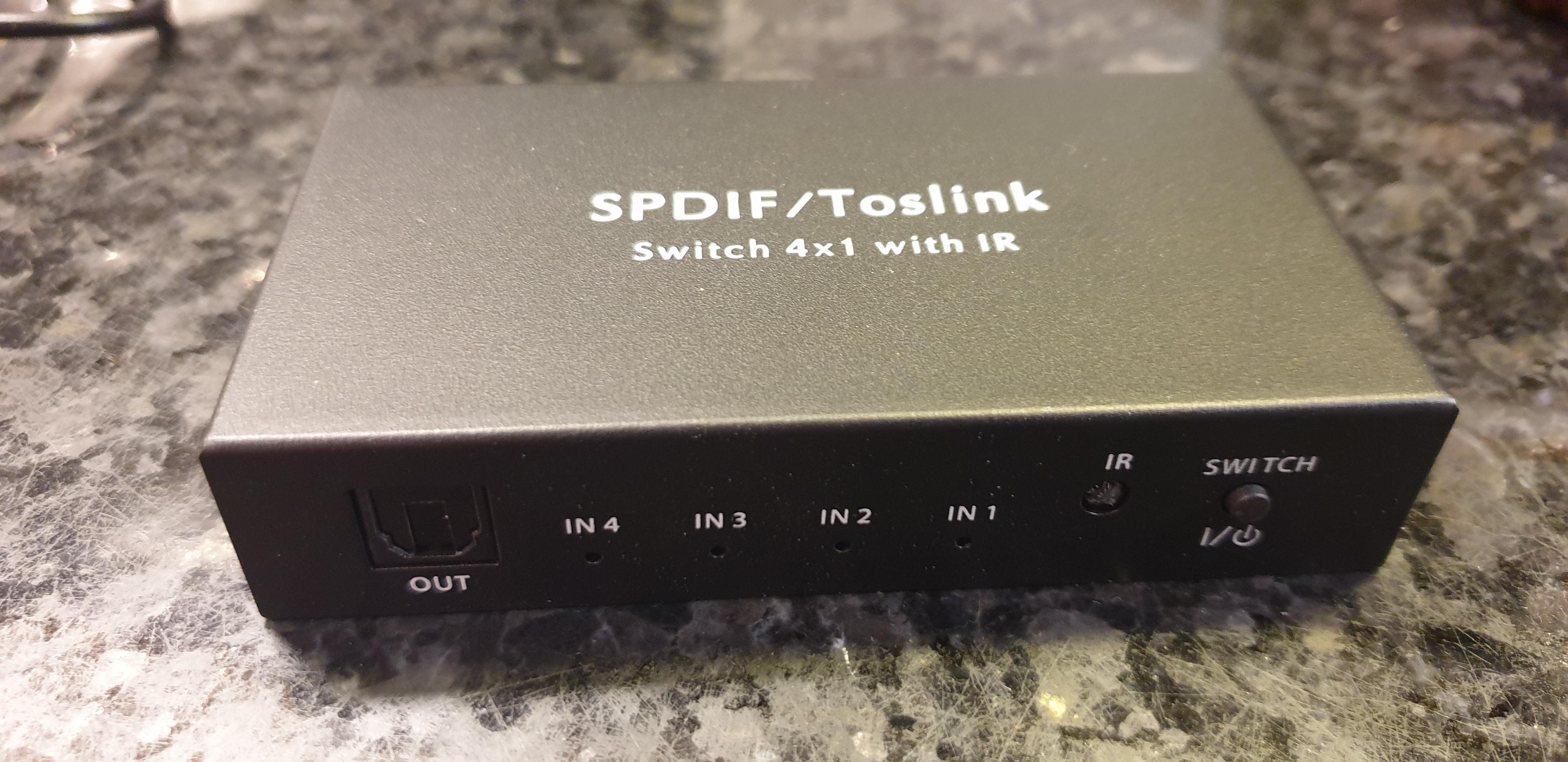

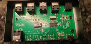

Further to my multi spdif input query I have just taken delivery of this from Aliexpress. Cost me £13 GBP . It has an HC153 'thing' to do the 4 in 1 out. Takes 5vdc.
I wonder if I can adapt some of them to coax inputs.. there are 100R on the 4 inputs so maybe change to 75R for coax.
Untested apart from it powers up ans cycles through the inputs correctly. Comes with a remote and does appear quite nicely made and even in a metal case....no plastic!

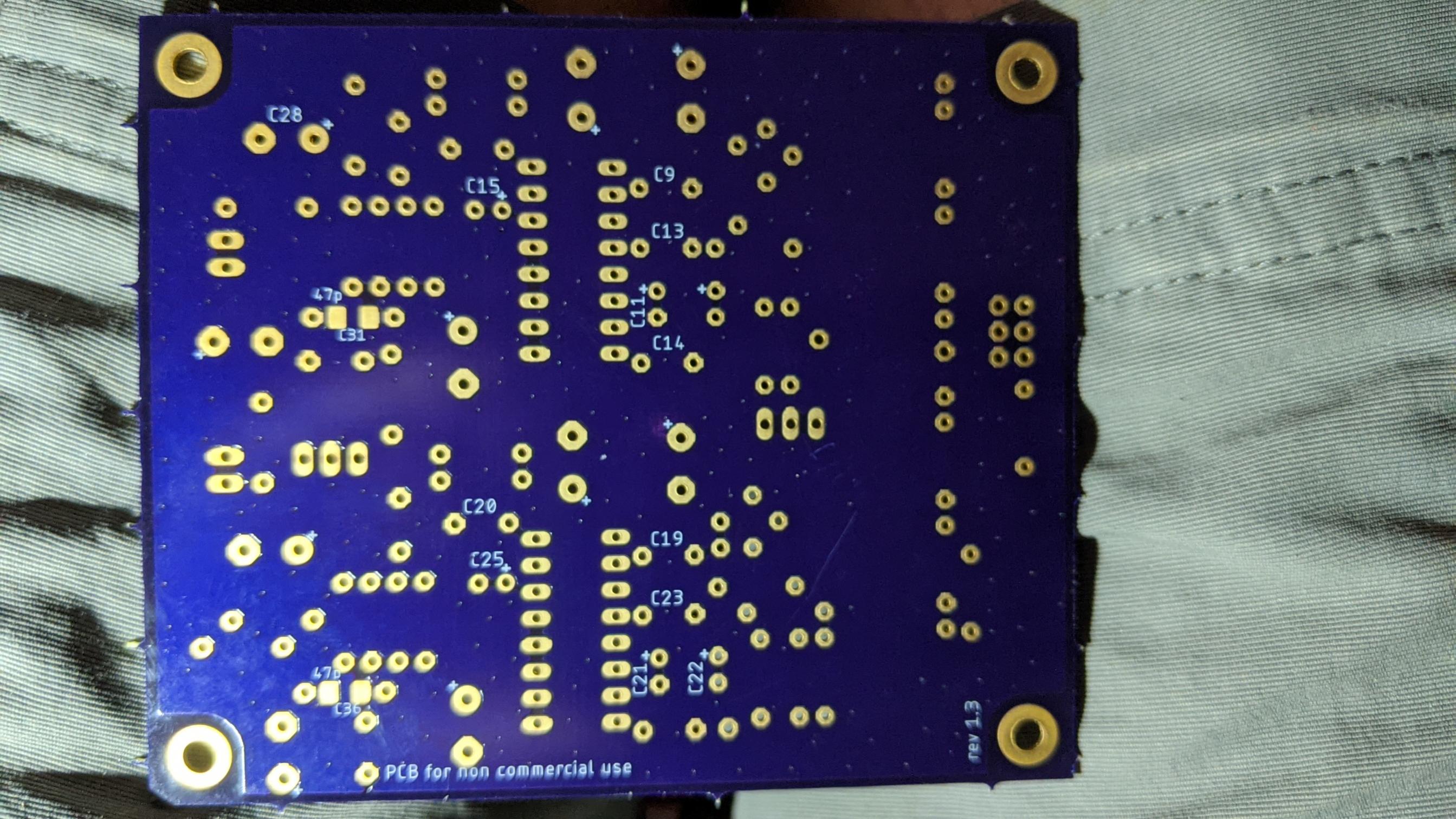

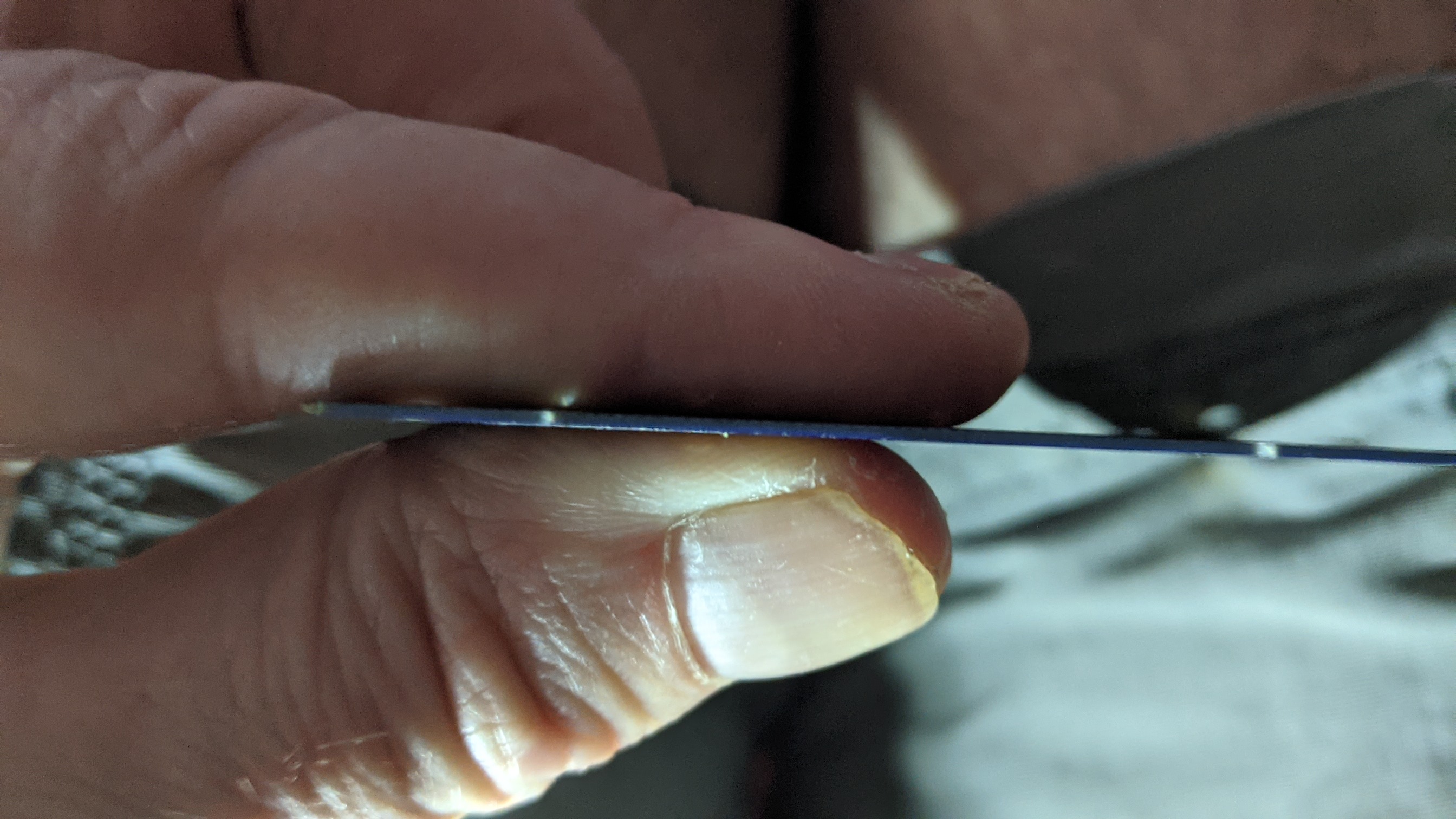

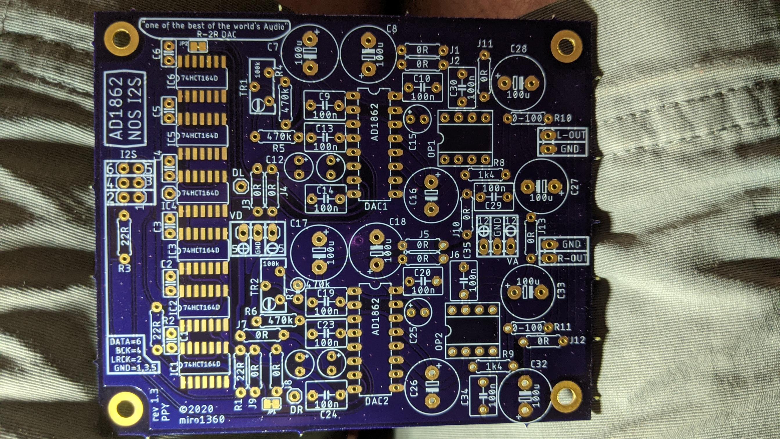

I just received my boards from OshPark (an effort to support US business) and I am ready to get building. Does anyone have a recently working Mouser or Digikey cart? I'm not lazy, just have been filling BOM's for other projects and the joy has gone from looking for alternates for every 3rd item.
The boards were ordered with 2oz copper and so came as half thickness .6mm boards. With a small amount of effort they could be sharpened to a dangerous level. For anyone else that goes with Osh I would stick to the 1oz copper and be prepared to wait and pay far more than you are used to for production. ~$50 and three weeks plus.

22r in i2s lines
Indeed thin boards.! Nice in ENIG. I applaud your loyalty in keeping it on your home turf but $50 is a bit spendy for me. Well done though.
I have started on the Miro SPDIF board and got the 8804 soldered on last night. Scary but went well when I got the correct tip and technique.!
I proceed with stuffing the R and when I came to the 22R realised I had none. Then I got reading into series resistance in the I2S lines. Seems they are better going near to the point of transmission than at the other end. I already have the 22R on the DAC board so should I omit the 22R on the spdif board.? Or stuff those and jumper the ones on the DAC? I assume we don't want both sets.!

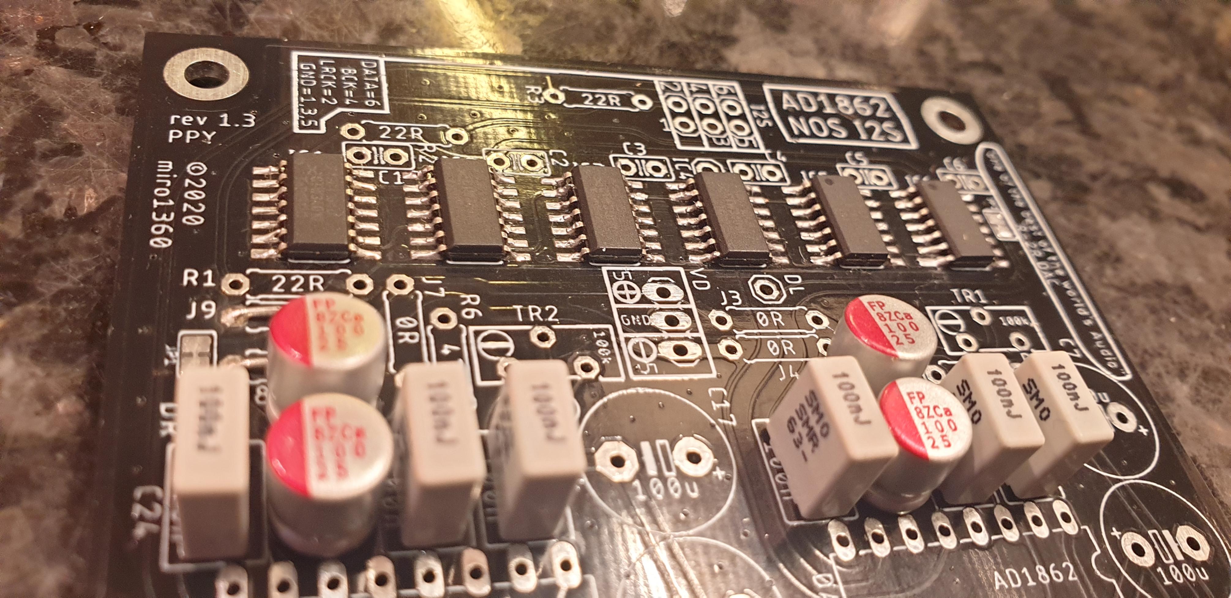

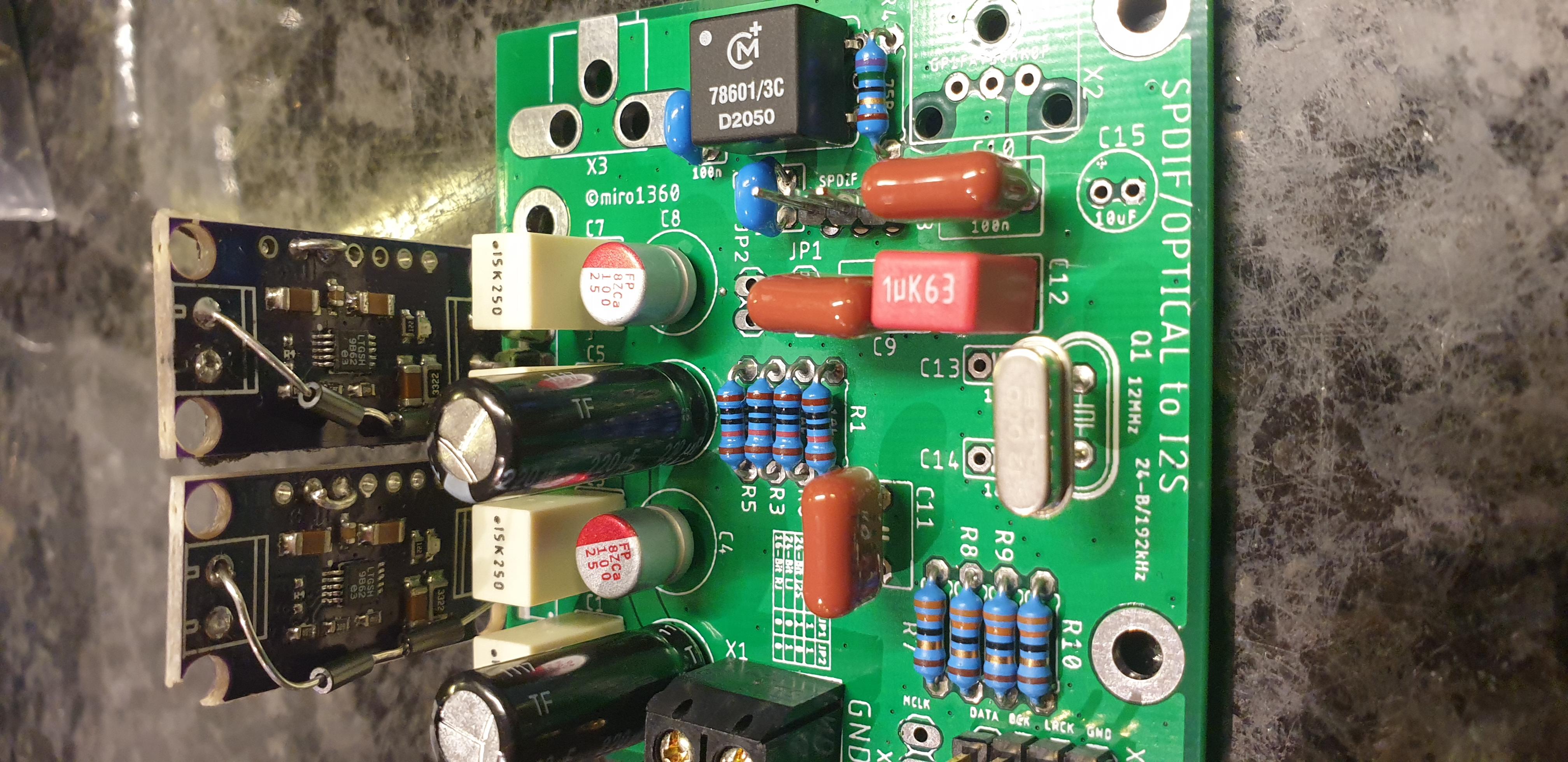

Some work on my 2nd dac build and also the wm8804 spdif input board.
Using some different components than the 1st dac build. We will hear if there is any difference. Using SMR bypasses and 'oscons' on the digital lines. The spdif board is using a pair of Chinese lt3042 boards that I wasn't using and they are supplied via ferrite beads. Polymer hybrids on the output of the regs

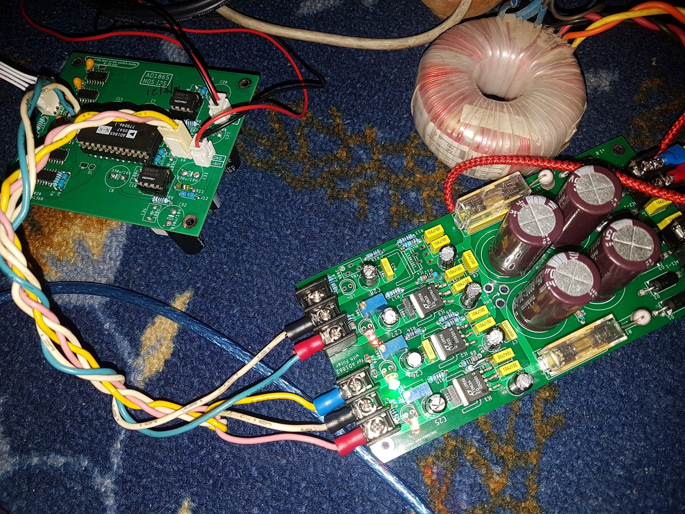

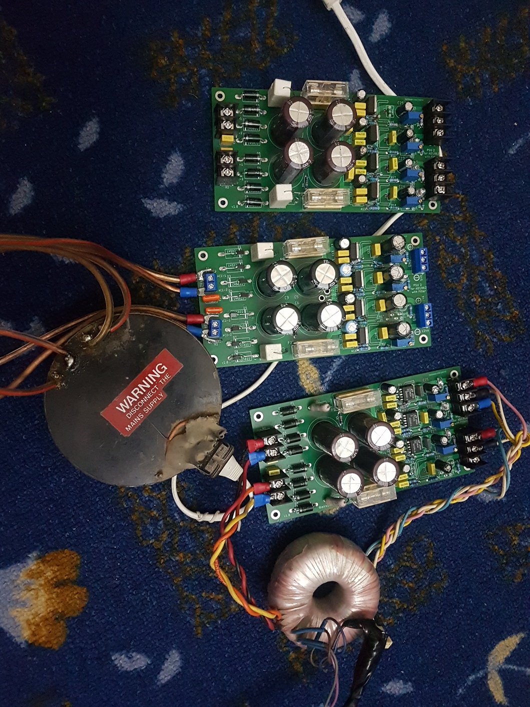

@miro1360 as mentioned in my last posts I had enough time last week having 5 days off to populate few more PCBs for PSU.
Finally found out the reasons for erratic behavior of one LT1963 which at startup would show voltage of around 5 volts (give or take) but would drop afterwards to around 2 volts (give or take). PCB in the middle with SMD IN5822 is the one. Other two populated PCBs did not have the same problem they had their own share of minor issues but nothing major like this one. Took me a while but finally found out that one of the via for R2 (adjust to ground was damaged) so fixed that by soldering directly at R1 and ground on the bottom side of the PCB and it has fixed the problem.
So now I have three working PCBs with rest of the two (out of 5) are being populated, not that I would ever need so many DAC board but I can repurpose this PSU for other projects like my version of Turntable Pre Amps like Bugle 2 and Emerald and a few others.
