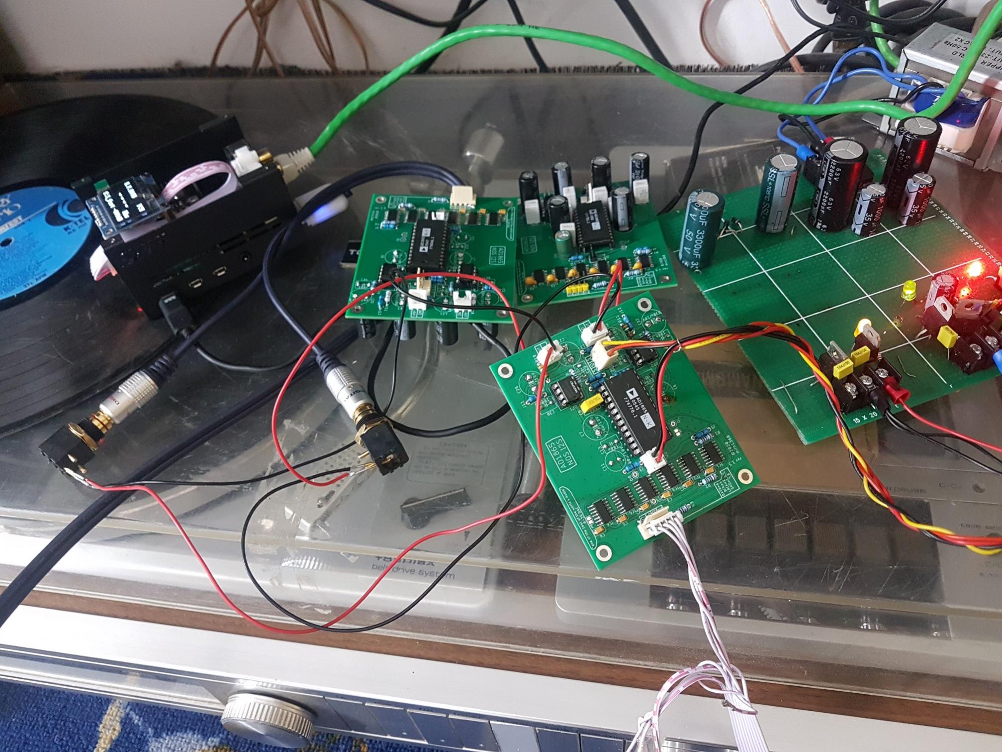

Despite fixing everything that one was still causing problems since I am not very patient when it comes to trouble shooting, making a new board is relatively easily thus threw that one away and made a new one.
Now I have three working AD1865 (miro version) DACs. Next stage is testing it with different operational amp.
Have been building another version of AD1865 based upon Pavouk's work this one uses Vout instead of Iout, sine I still have 6 other AD1865 lying around may be will make them as well.
Any suggestions for casing, my initial idea was to throw away the DAC section of "Rod Rain DAC" the DAC section is ES9038Q2M, use the casing and amanero board but this PCB (miro's) is wider so have to find some other casing.

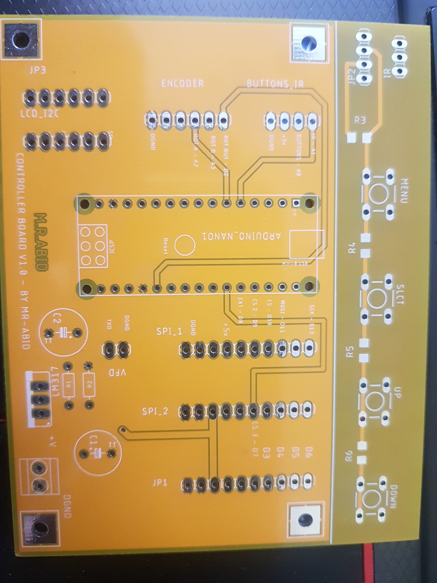

My idea is to add amanero, may be in the later stages an SPDIF interface, a LCD/OLED (though I still have a couple of old VFD_HD44780 compatible but they are power hogs) to display track bitrate, flac or DSD,a mcu for input selection USB/SPDIF etc.
Made this modular controller board a while ago around arduino it has all the necessary I/O I think I'll use it as well.

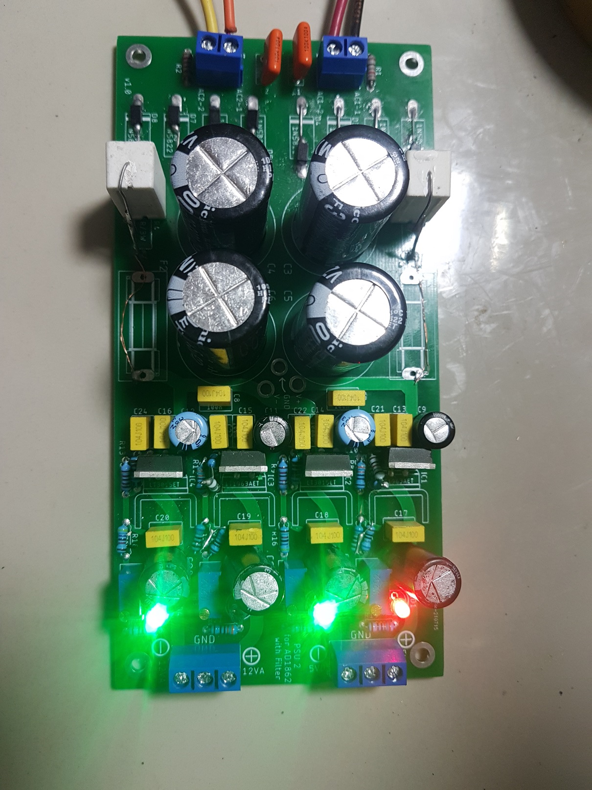

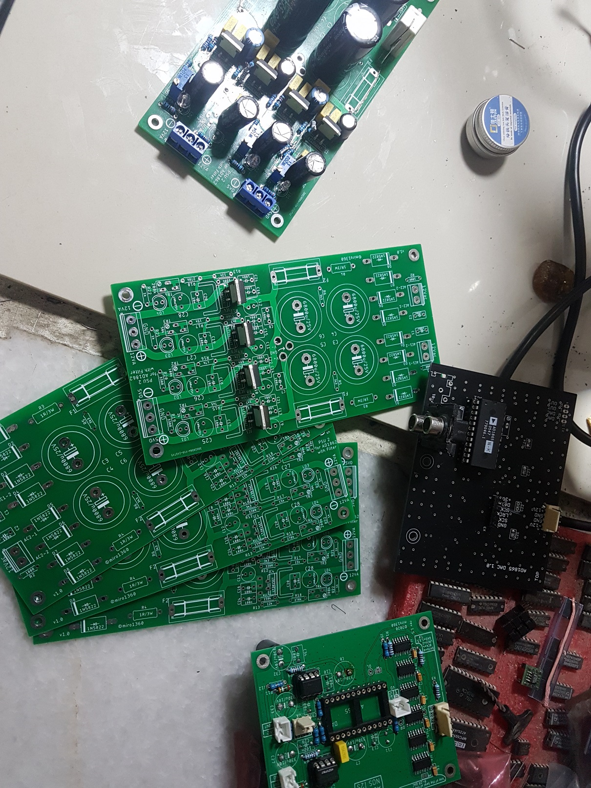

@miro1360 PCBs for PSU arrived on Friday evening and I decided to populate couple of them started with one, since I am using AD1865 thus changed the value of resistors on 12 volt rails for 5 volts.
However I am running into a problem one of the rails the positive side analogue supply side, when I switch on the PSU the voltage at positive analogue rail starts off at +5.05 volts then it starts dropping off and stabilizes between 1.96 to 2.02 volts that's when the LED turns off as evident in the pictures and video.
Frankly I have never used LT1963/3015 combination, always preferred using 317/337 combo, I have no idea whether the problem is with LT1963 or something else I have removed the trim pot and the optional resistor, after a few tries fixed the R2/R1 combo at 1.18K and 330 ohm but this weird problem is prohibiting me from using this PSU.
Any ideas/suggestions will be appreciated.

I purchased it from AliExpress the part No# LT1963EQ its a TO263 packing and not TO220, I had to improvise to put it in the pcb.
One LT1963 is giving a fixed output of 5.05 volts with the trim-pot or experiment with R2/R1 combo it gave me a range of 3.8 to 8.6 volts on the rail, but the other one is just behaving strange, I don't know whether I have to replace all the capacitors on the rail, check diodes or tray and replace the regulator, what I am curious is about the odd behavior of the LDO.
BTW I am using a toroid of 6+6 volts with the bridge rectification minus forward biasing compensation the voltages are around (8.3 - 8.6 volts)

On the LT1963 remove C17 - goes from adjust pin to output I think going from your pcb pic.
The LT1963 is different to the LT3015 and does not like to see any capacitance across this adj resistor.
The LT3015 is different & adding a capacitor across that adjust resistor reduces noise.
I got caught out the same way & wrongly assumed the LT1963 was the same.
Recheck the LT1963 data sheet & you will see there is no mention of a capacitor across the adjust resistors.

The interesting thing about this C bypass is that in the non-adjust version (1.2V) adj pin is joined internally to OP.
There is likely some lowish value resistor that can be inserted at Adj pin whereby allowing stability with bypass C. The problem with not bypassing
(R2 on data sheet) is the noise multiplication. This can clearly be seen on P9 data sheet, even at 3.3V OP the noise is more than doubled. If you use the
reg for say 15V, there will be a huge noise multiplication at OP.

I have given consideration to all your suggestions part of my professional life to remove all doubtful variables and try and come to a conclusion with highest probability so here goes:
1) all LT1963 are from the same batch it means if one LT1963 is providing a stable output of 5 volts then the other should also.
2) Capacitor same issue it is true for both LT193 one should not be behaving differently from the other.
3) resistor mismatch
4) Problem at the diode level
5) faulty large capacitors
6) problem in the PCB
I think I have pretty much ruled out first two but will explore rest of the 4 possibilities, hopefully will be able to populate the other PCB for comparison.
My only unsolved question is why the output starts at 5 volts and then drops to stabilize between 1.96 to 2.xx volts.
