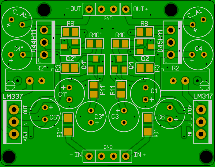

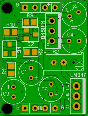

Hello everyone, I see Kammrada reportedly there are strains about buying high-quality power stabilizers. Once upon a time, I did draw scarves in Sprint-layout for my needs based on the so-called "Behemoth" stub, from the audio perfection site.
If anyone is interested, I can throw off the gerberas, for the manufacture of the stabilizer, the components are all readily available. Perhaps there is something to correct in this board drawn by me. There is also a drawn version of the bipolar stabilizer (just for our needs).
According to the author's measurements and the simulation, the stabilizer is very good, I recommend it. I use them myself with a DAC from Pavel Pogodin DSC-1
There are also drawn shawls of the so-called "Nazar Stabilizer", you need to try both of them, perhaps it will be better than microcircuits from manufacturers, in any case there are no problems with the purchase of components, all are readily available.

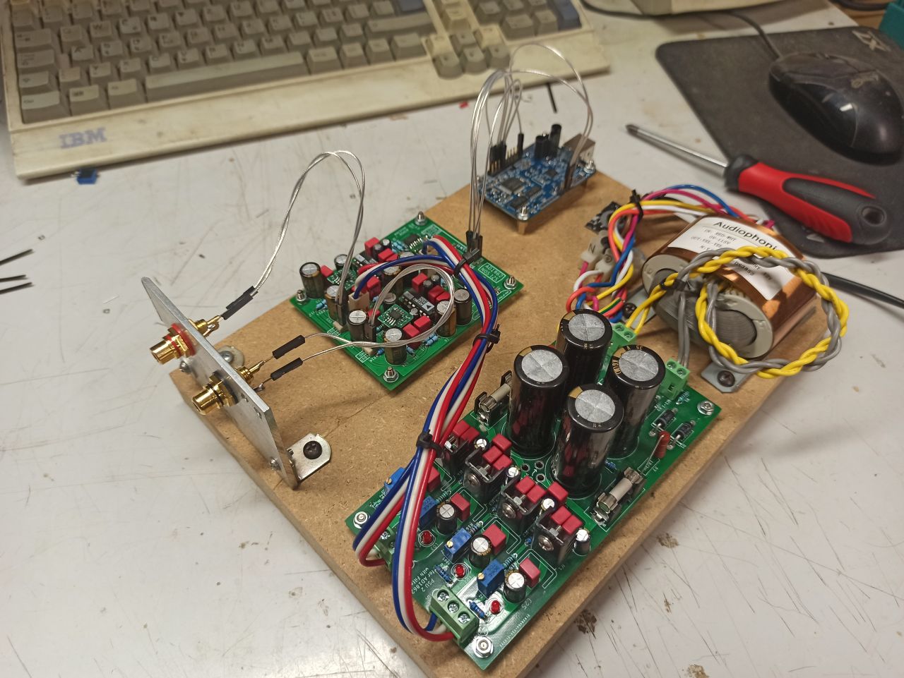

The basic connection is simple. You can create a prototype from 2 single boards. Invert Data to the second board (with SN74HCT14N). Left current output on the first board and Left current output on the second board is dual mono left channel, similiar for the right channel 🙂
