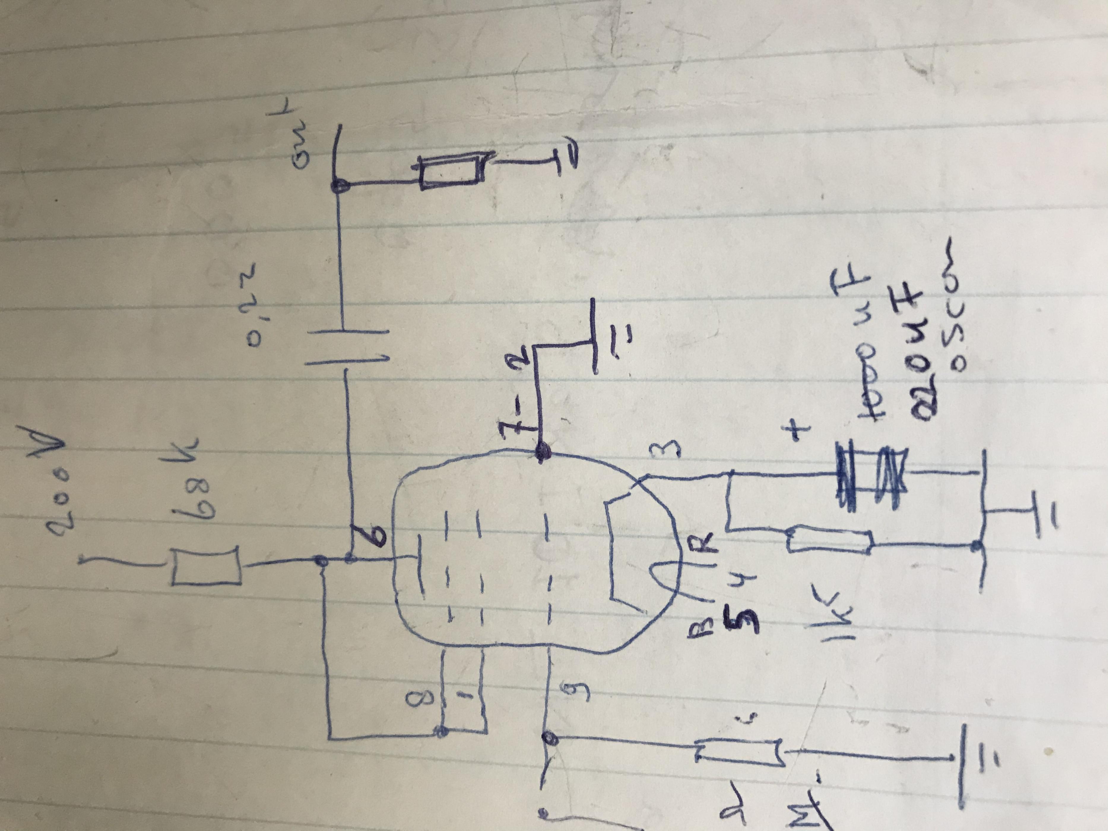

I made a simple ef86 as triode connected single tube stage. First want to try 200 ohm iv resistor, but with only 1 ma trough tube I search some other bias values
Output cap is now 2,2 uF ERO mkc with philips KS bypass cap

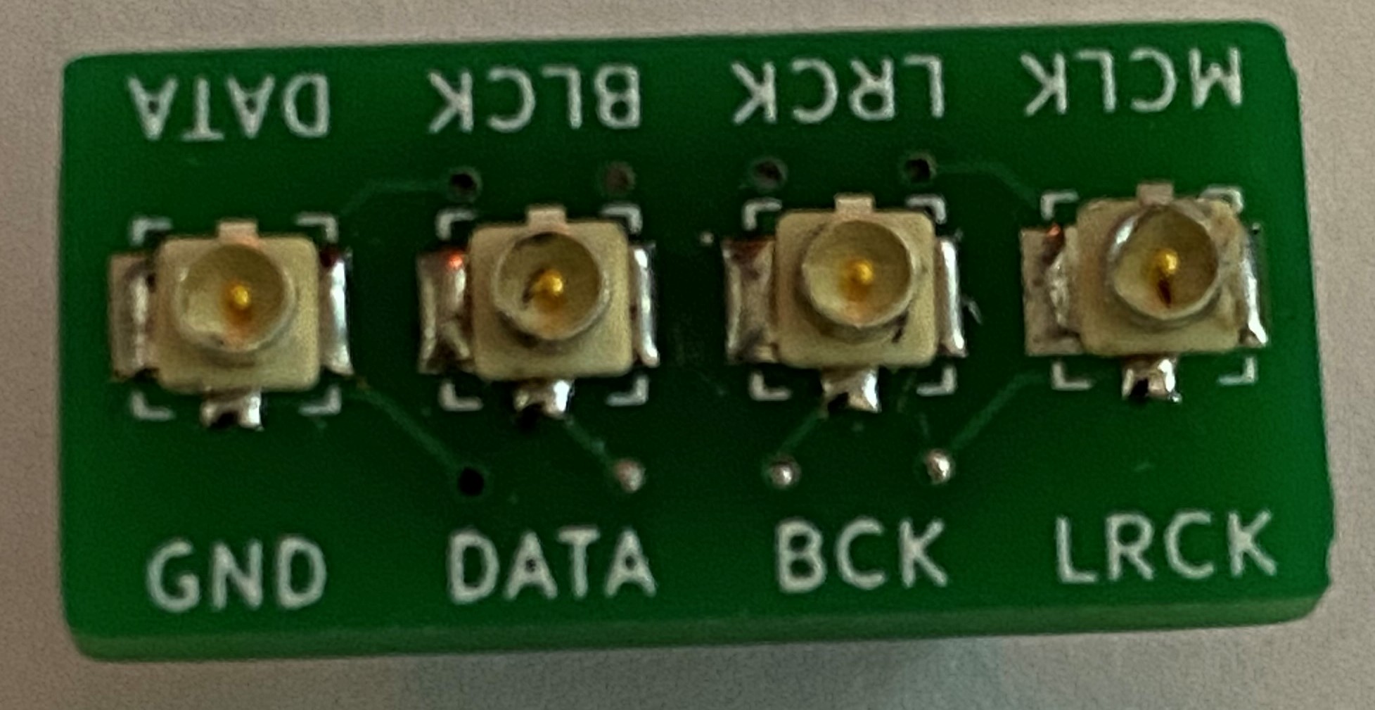

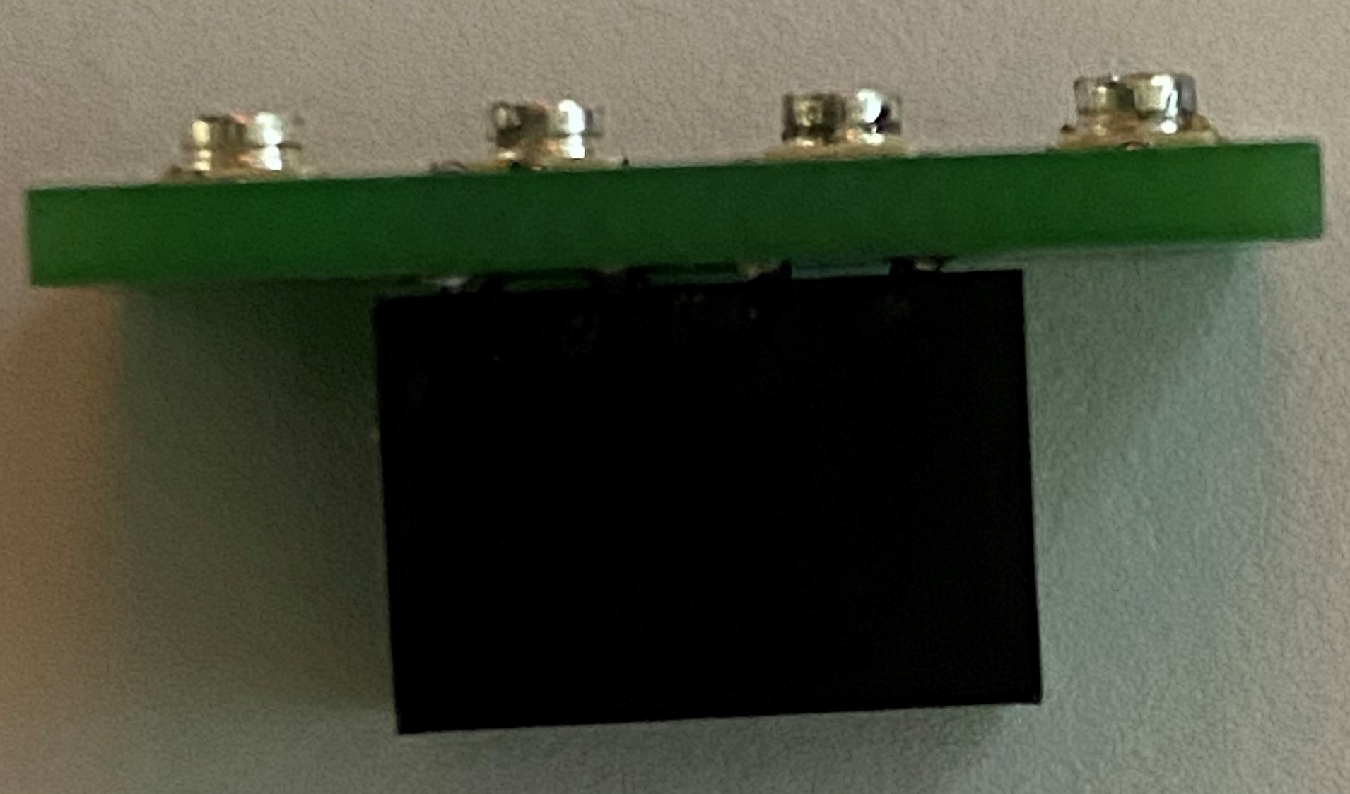

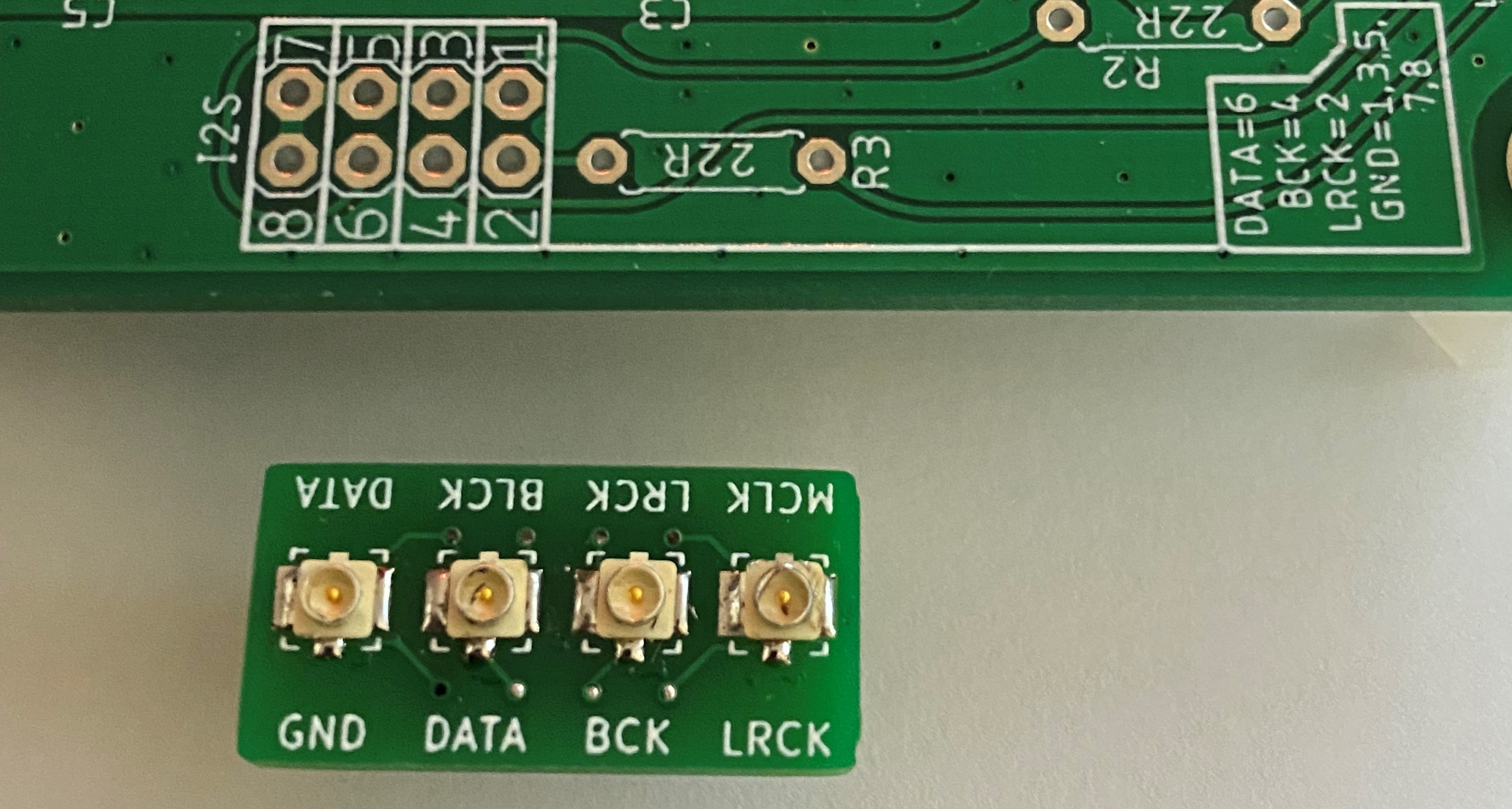

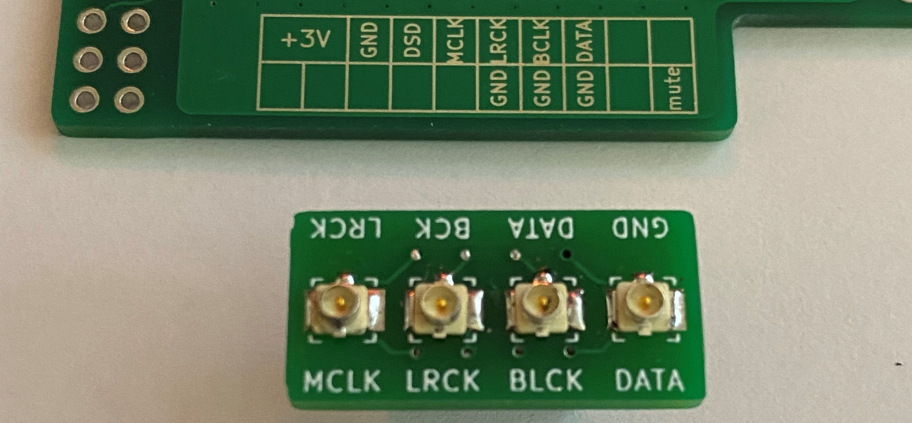

Guys, I created a little board for myself to leverage U.FL connections between Miro's boards (for existing builds) and an I2S source with normal header connections, in my case PPY's re-clocker for Beaglebone boards.
I added labels to the different connections so that it can be oriented to line up with the respective board (Miro or PPY). However, it's a straight through connection to the bottom header, so it can be used in any orientation.
I'm sharing the Gerber files if anyone else every needs a similar solution. This is my first attempt at designing a PCB, so I'm sure I did everything wrong. 😱 The good news is that it does work! 😀
Mouser BOM
x 4 : u.FL - 798-U.FL-R-SMT-110
x 1 : Header - 710-61030821821
  • uFL adaptor.zip
    uFL adaptor.zip

Thank you. This is what I wanted to know. Do I need to put a resistor for AD1862 ? Do you have any pictures please?
I intend to use a 6CG7
Mu is too low :umbrella: imho, same problem than Tubee = more difficult with the too big I/V R value = distorsion.... that little dac chip has only 2ma compliance if my memory serves me well which is not perhaps 🙄 ! (Or at least use drop the I/V R value and use more gain with the pre after ?)
If I may, you should cop an already established design (I gave a name above in a post) or simply go the route of the op amp which is less dangerous than playing with HV if not confortable at reading a datasheet 😱. You may have a better result with the LM opamp than going tube route that way, imho... way safer for the health and sound ! Of course YMMV, but someone had to alarm you on that risks. (no offense).
Safer to follow what Fran already experienced if you want to follow the tube route or read the article of the guy I talked about (which means working with higher Mu).
just my 2 cents.

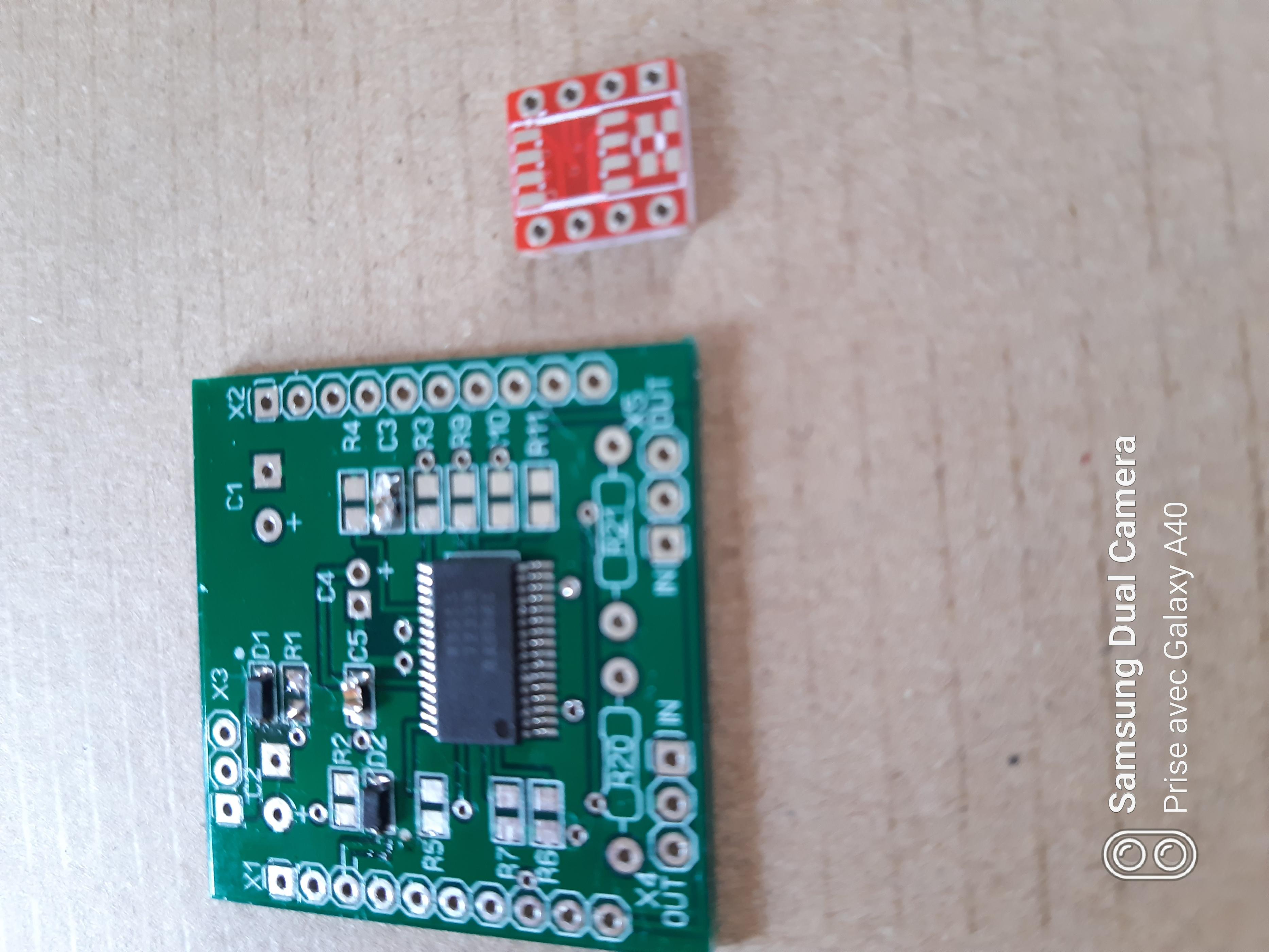

Hi Vunce,
How please one has to populate the adaptator C1 value? According the oap datashhet ? Do you populate the top R two aeras ? How much R please ? With Fca acrylic cap it must change the game on the right side vs x7r I don,t like.

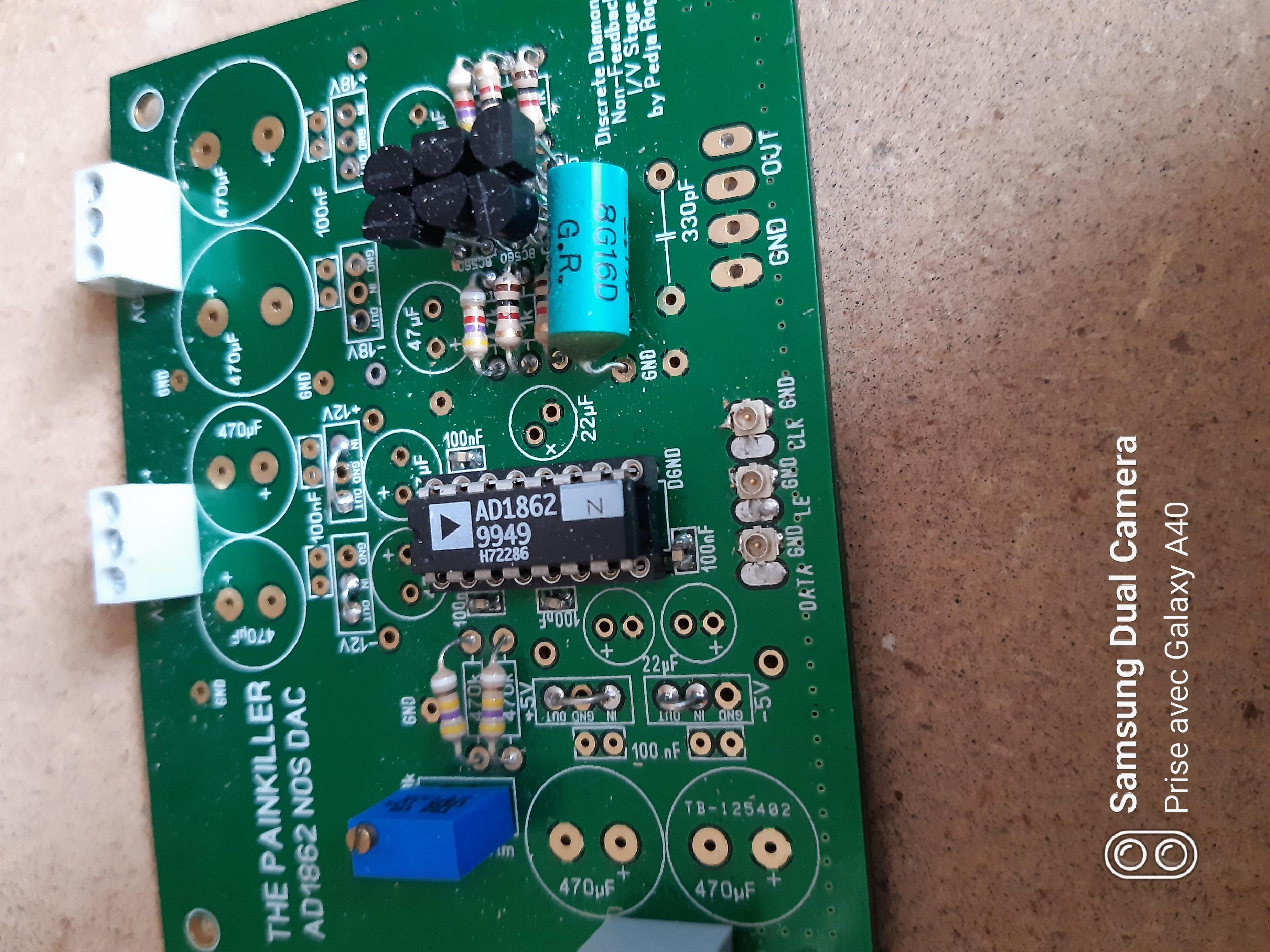

Here your board near Meldano member 's Muse volume control board...rhe littliest smd I soldered...yestzrday during the french national day firework...just in case of scream, yell, nervous breakdown to hide the spl volume of your servitor....was ok with flux.
@ Aleev Edit...have to show you later Rogic mirror on the painkiller member ad1862...To package are so close I surmise there is a thermal coupling and at the end each transistor must have perhaps the same temperature...
Is it the problem you highlight ?
Aleev, I found an old picture...look how the diamond Rogic arrengement made by Painkiller member is compact 🙂...4 layers board.
@ Miro...as I asked to Painkiller a SGSGSG I2S arrengement...I successed to hack the througholes with uf-l pads in between...lol. Notice the good Rhopoint at the outputt I/V...just 1k...the pre after is doing the job enough 🙂.
