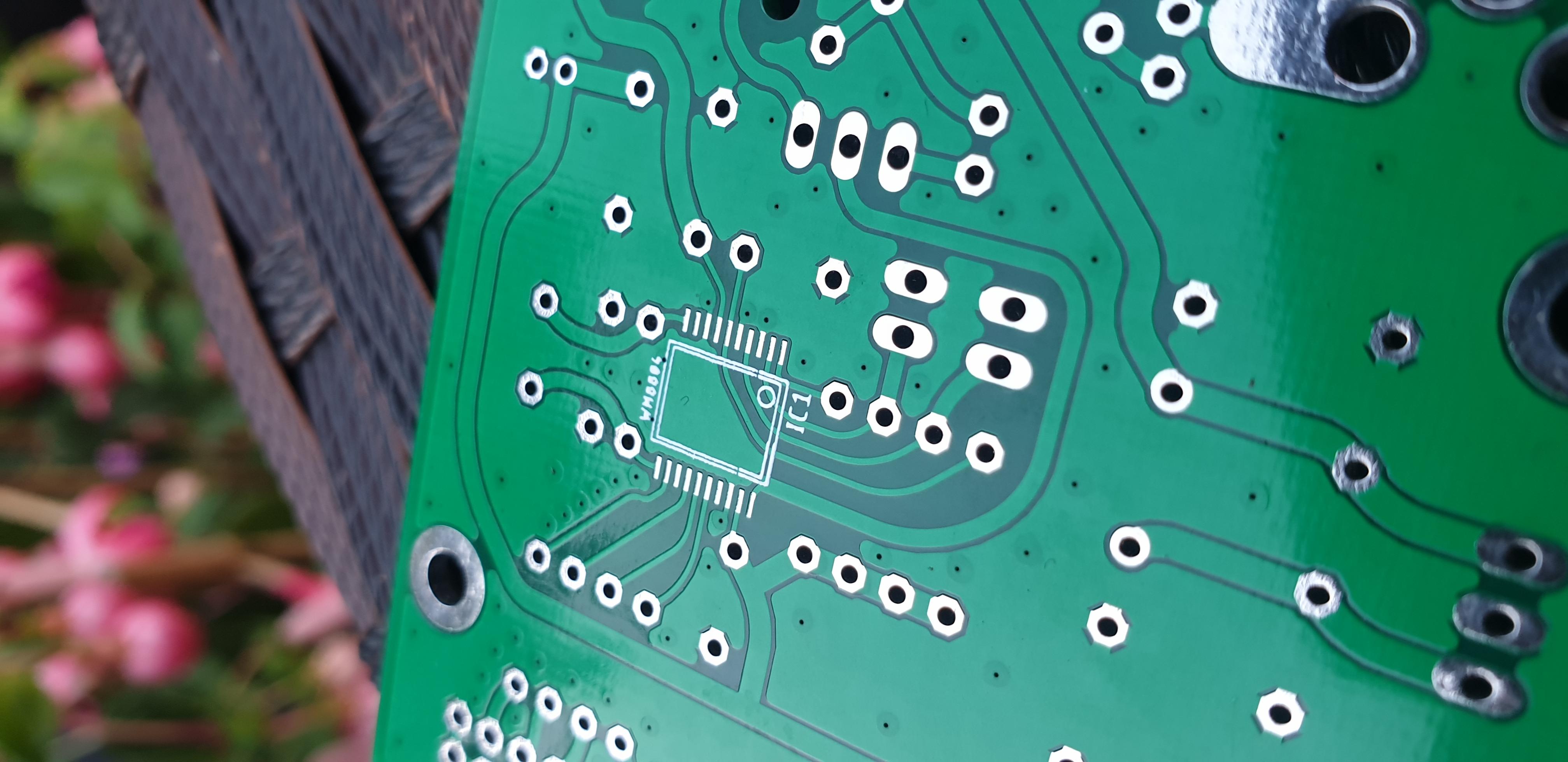

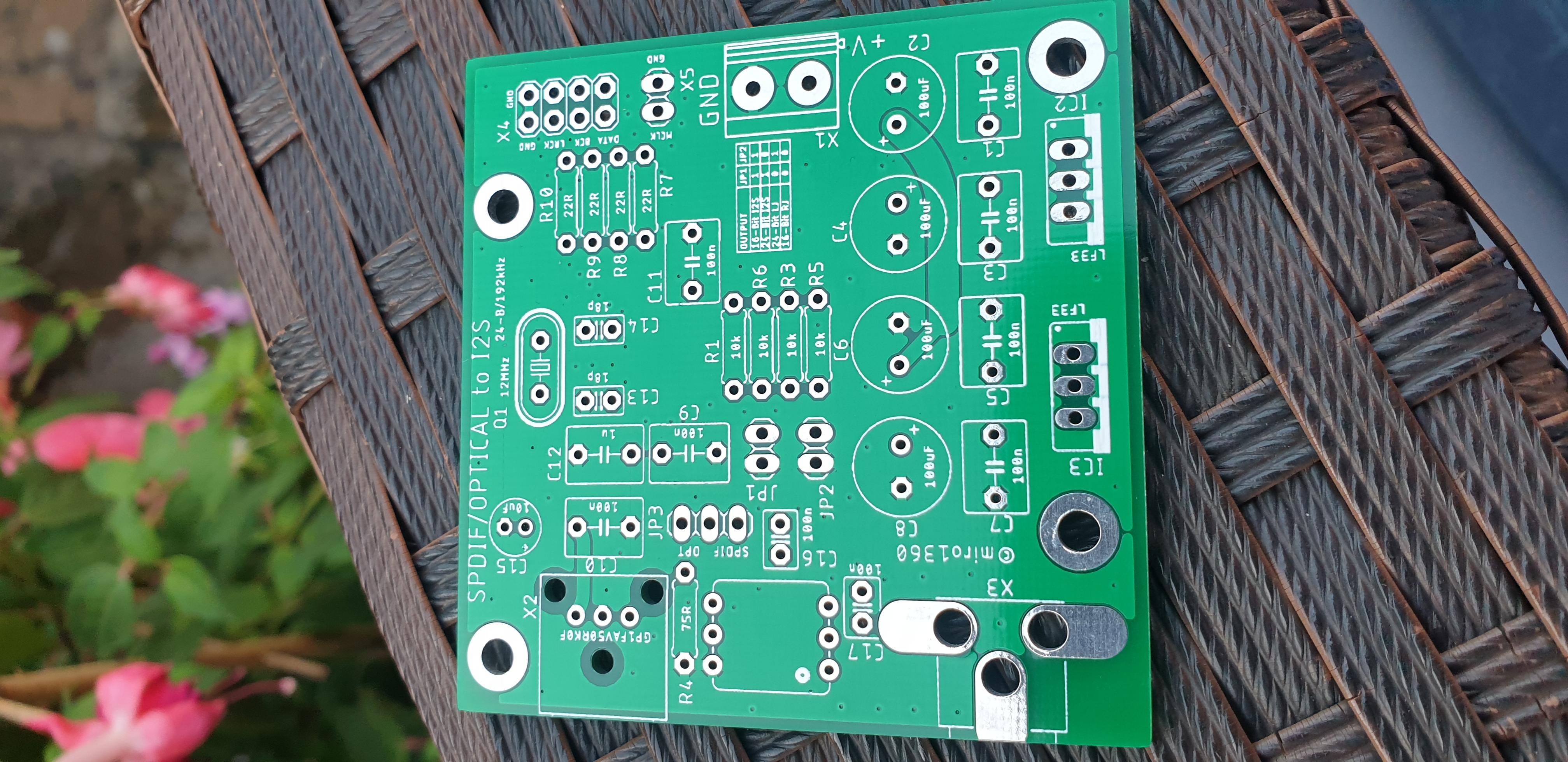

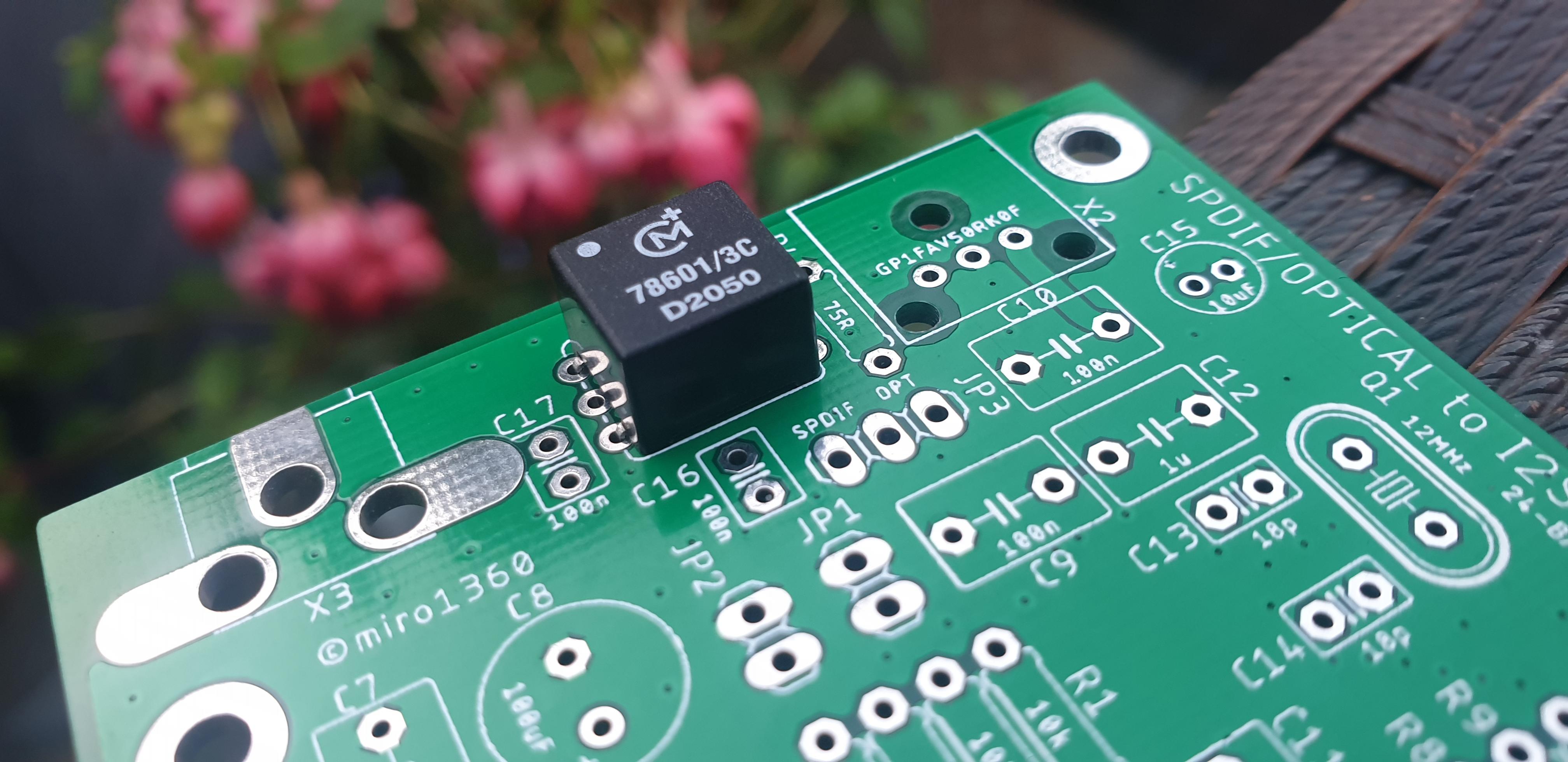

I got the small spdif optical boards today. Those 8804 will be fun to solder. That will test me. I've just done the 2sk209 fets on the BA2018. They seem easy looking at this!

@jimk04 Be sure you add enough flux (rather more than less) and carefuly with the solder (rather less than more), with flux it is really simple 🙂
Hopefully everything will work properly, prepare for possible complications as you will be the first who is building it 😀

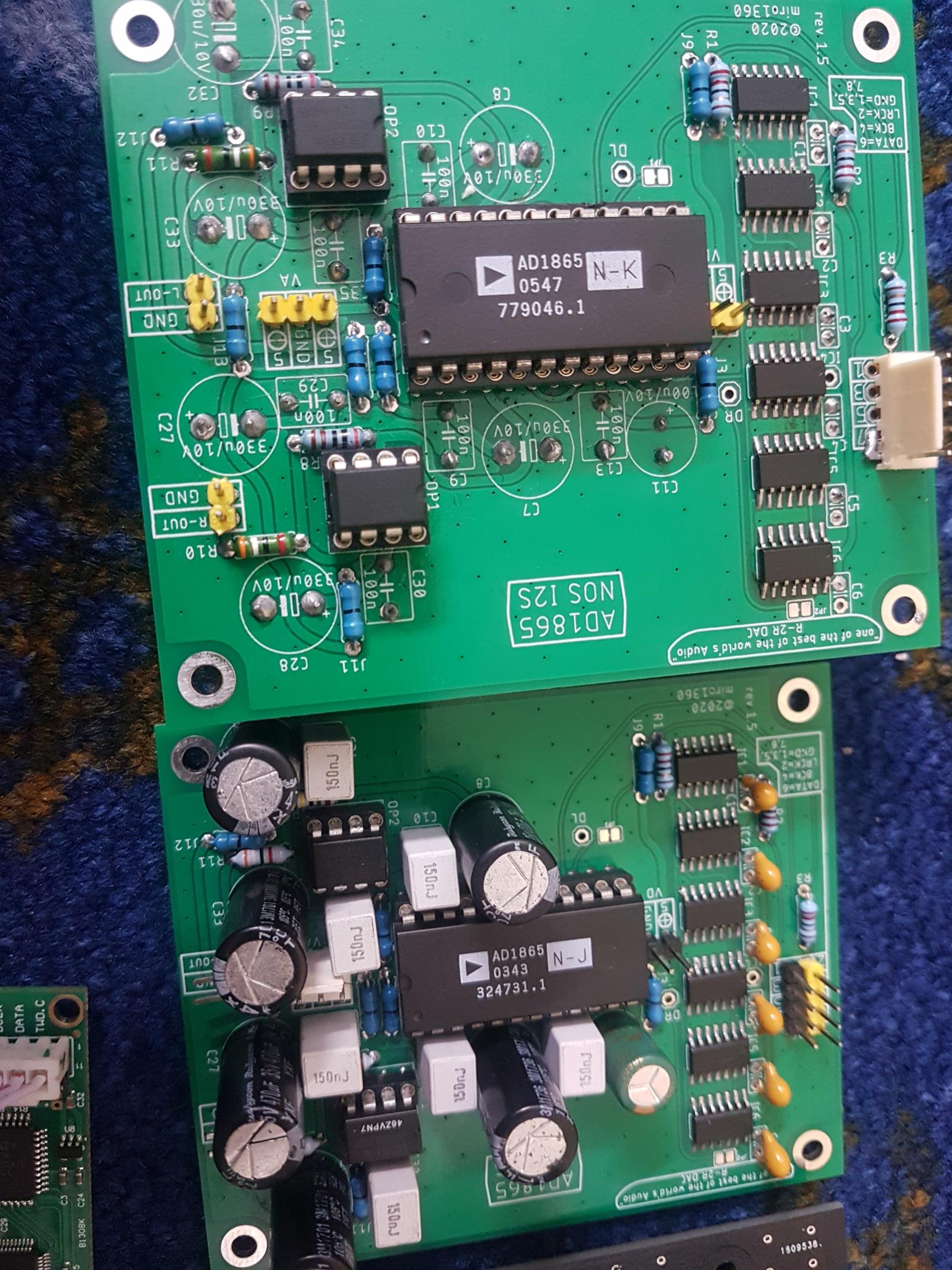

@miro1360 , @vunce I recently had time to build AD1865 DAC with the same PCB design and parts as mentioned in the thread, however I seem to be having one problem and that is I am getting sound out in only one channel.
Its very strange for me because its not just one circuit but two completed PCBs, using AD1865 and OPA627 from different batches both are original.
AMP is an older classic version Onkyo Integra 817RX, which I use normally with my Turntable. I have tried it with another AMP which is DENON PMA880R an A class mid level AMP which I use normally with my CD and Cassette player.
Just to make sure I am not doing something wrong I have used two different Amanero/XMOS boards but same problem.
Any ideas?
There is sound only in the right channel, left channel has oscillation, both DACs. On the sound side when I turn on the DACs with only the right channel working the sound is vibrant and "alive". One OPA627 in the right side DAC with white marking is really vibrant, this was the batch of 10 OPA627 which I bought from T.I official distributor, while ones with black markings I purchased from ebay by judging the output I think they are remarked.
Once I get both channels going I will test them with AD8610, Burson and Muse.
Could it be that I have connected the I2S in the wrong order?
I had a similar problem with a poorly soldered shift register on one of my boards and an inverted chip on another. The right channel data comes off the second shift register (IC2), so if something is wrong with registers IC3-IC6 the left channel will be blocked.

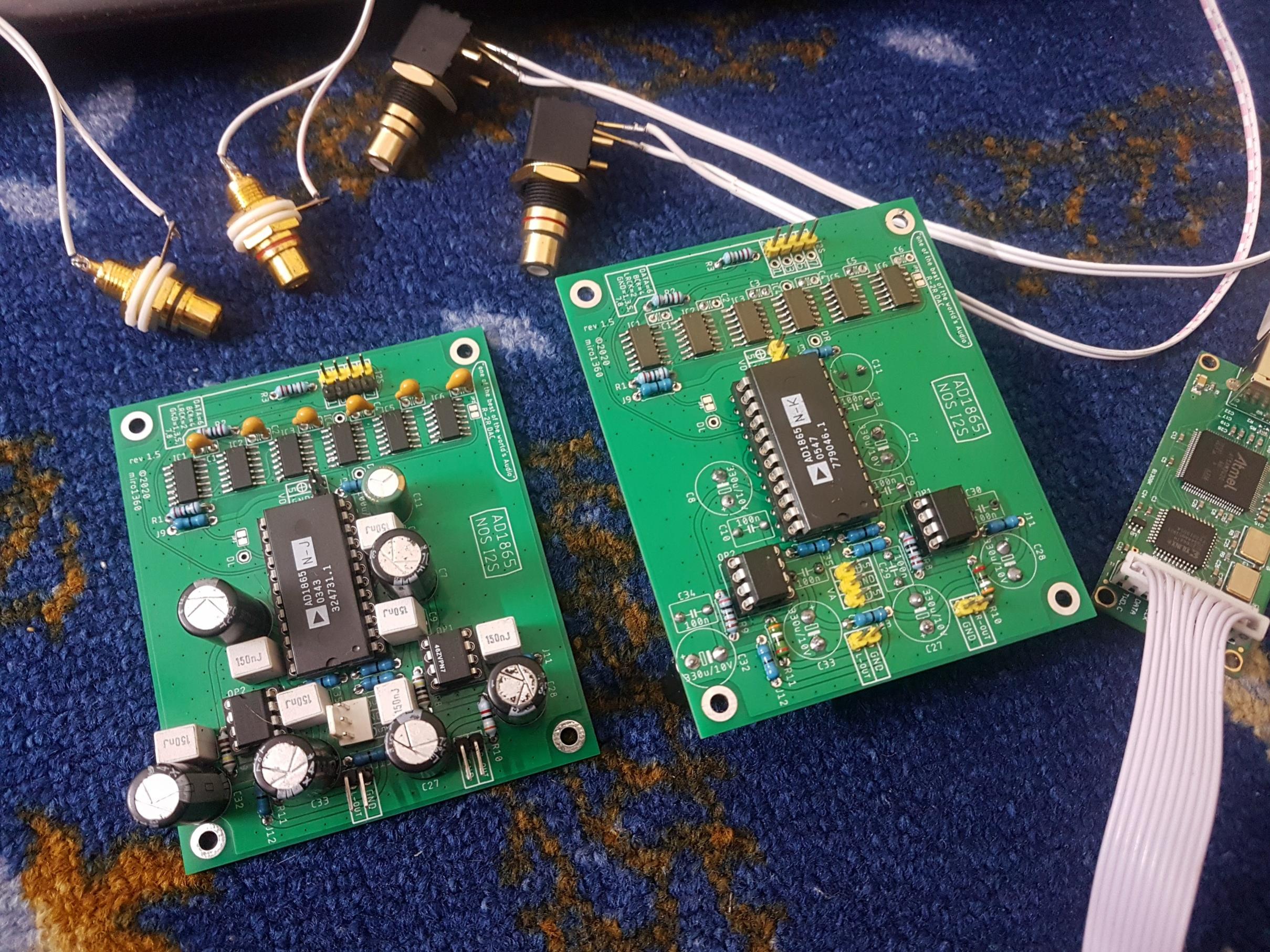

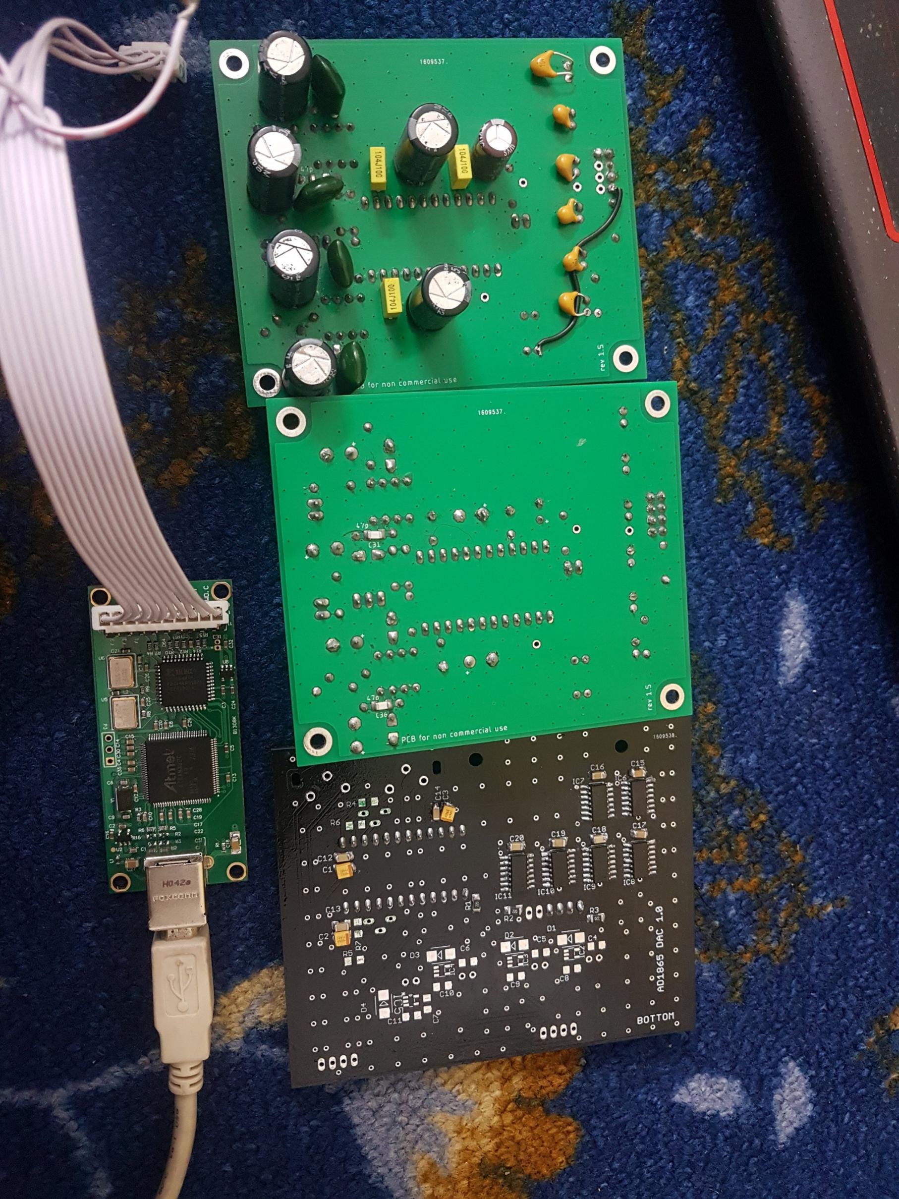

I reheated all the solder on the shift registers it, one feedback resistor on left channel had a problem replaced it and now at least one DAC had both channels working, this fixed the DAC board with capacitors soldered on the bottom side, but the other one still has problem, only one channel working. Will give Paddy Garcia's ideas a try, otherwise have got 8 other PCBs at hand.
Here are few pictures of Miro's DAC and another design which is almost complete.
Call it my stupidity, initially I soldered a simple 4 pin SIL, but later decided to put in a 5 pin connector removed the SIL with heat gun but in the process damaged the via, thats why the jumper.
Nonetheless, thanks to your previous post and investment in innova 3340 paid off, the culprit was a very small piece of wire underneath IC4, removed the IC cleaned the circuit, put in a new shift register and wow its working.
Thanks guys.
