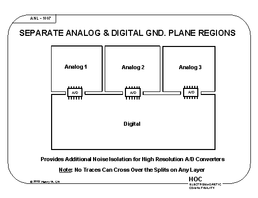

Looks like this DAC will be suspended for a while, due to a digital interference on the output 😡
Hard to say why this is happening :trash:
easyDAC is completely silent without interference. Perhaps a solid GND can cause this issue and the solution would be to divide the ground into analog and digital, and connect it under DAC chips (this is done in easyDAC).
Miro, what happen if you use the OPA861 pcb printed by Vunce with its buffer ? Still have distorsion ? Story to say if the culprit is after or before the dac chip before probing all the vias ???
Is it because of a chineese AD1862 which the distorsion can be seen more easily with the strong buffer ?
@diyiggy It is digital interference originating from the I2S portion.
I suppose when the power supplies share the same PCB and digital GND plane is not separated from the analog GND, digital interference occurs on the output :rain:
This is the last PCB where I didn't separate it, I will be wiser next time 😀
It's a 2 layers ? Where do you share the AGND and the DGND ? The Dgnd pin is not on the output side of the chip if I remember ? Humm I don't remember in fact. That's an interesting learning purpose I should try to understand... and looking at this new pcb ! Have the inputs USB chips a standalone voltage rail or did you share the 5V with the AD1862 ?
