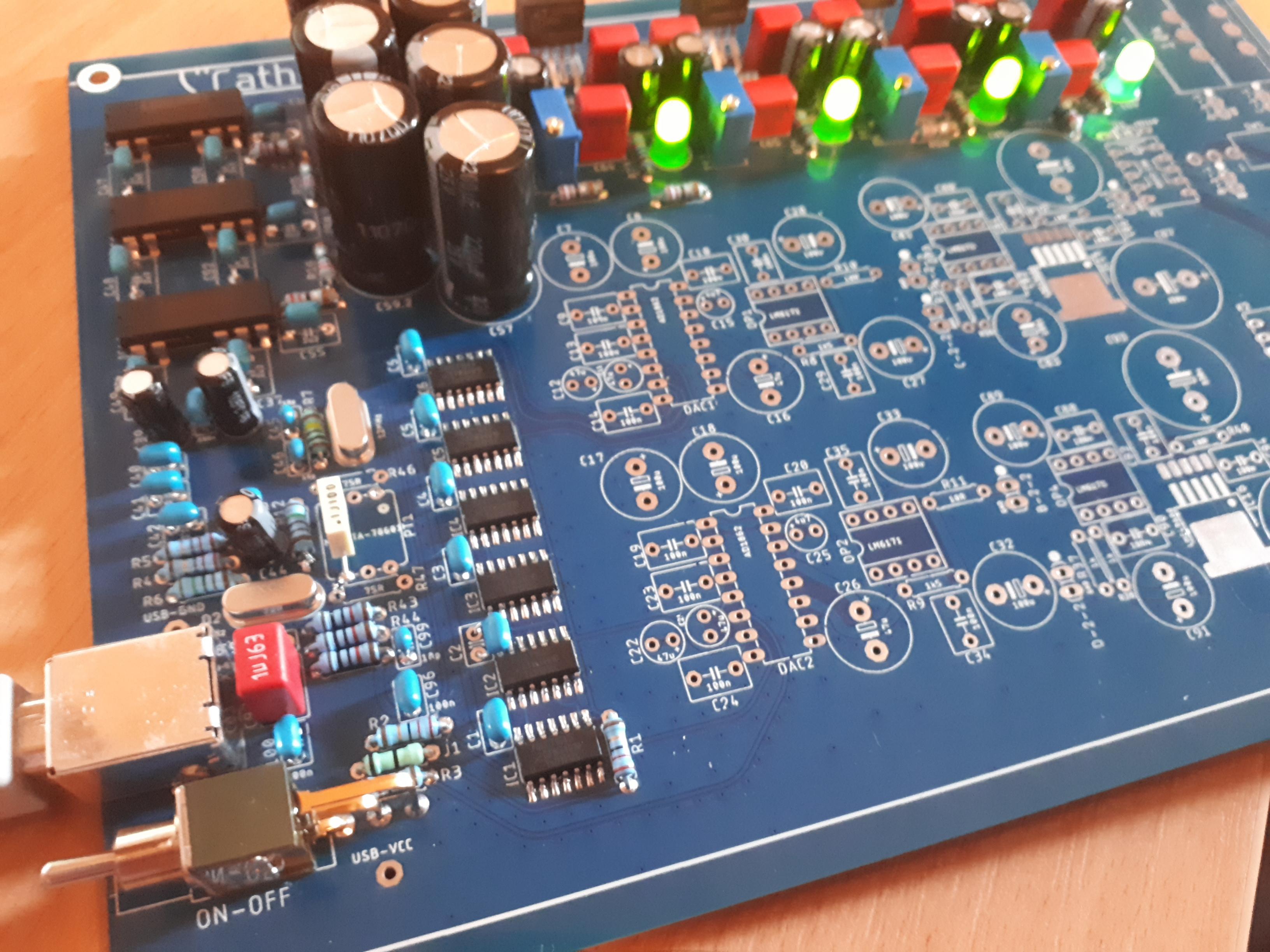

Last August I built my first example of miro's lovely little dac board. Last night I finished numbers 6 and 7. It's not as crazy as it sounds, though. The two bare boards came as gifts through the diyaudio stuff-economy, and since the chip sales haven't needed the spares set aside for losses and damage I had a couple of new AD1862s available.
With Jason's permission, you'll see these two as auctions soon. 100% of the funds will benefit diyaudio's preferred charities. The one on the left is set up for experimenting, with sockets for op amps and the audio-side electrolytics. The one on the right is Vunce-style with SOIC op amps and set up to plug in and listen, with LM6171s and Silmic II audio caps soldered in.

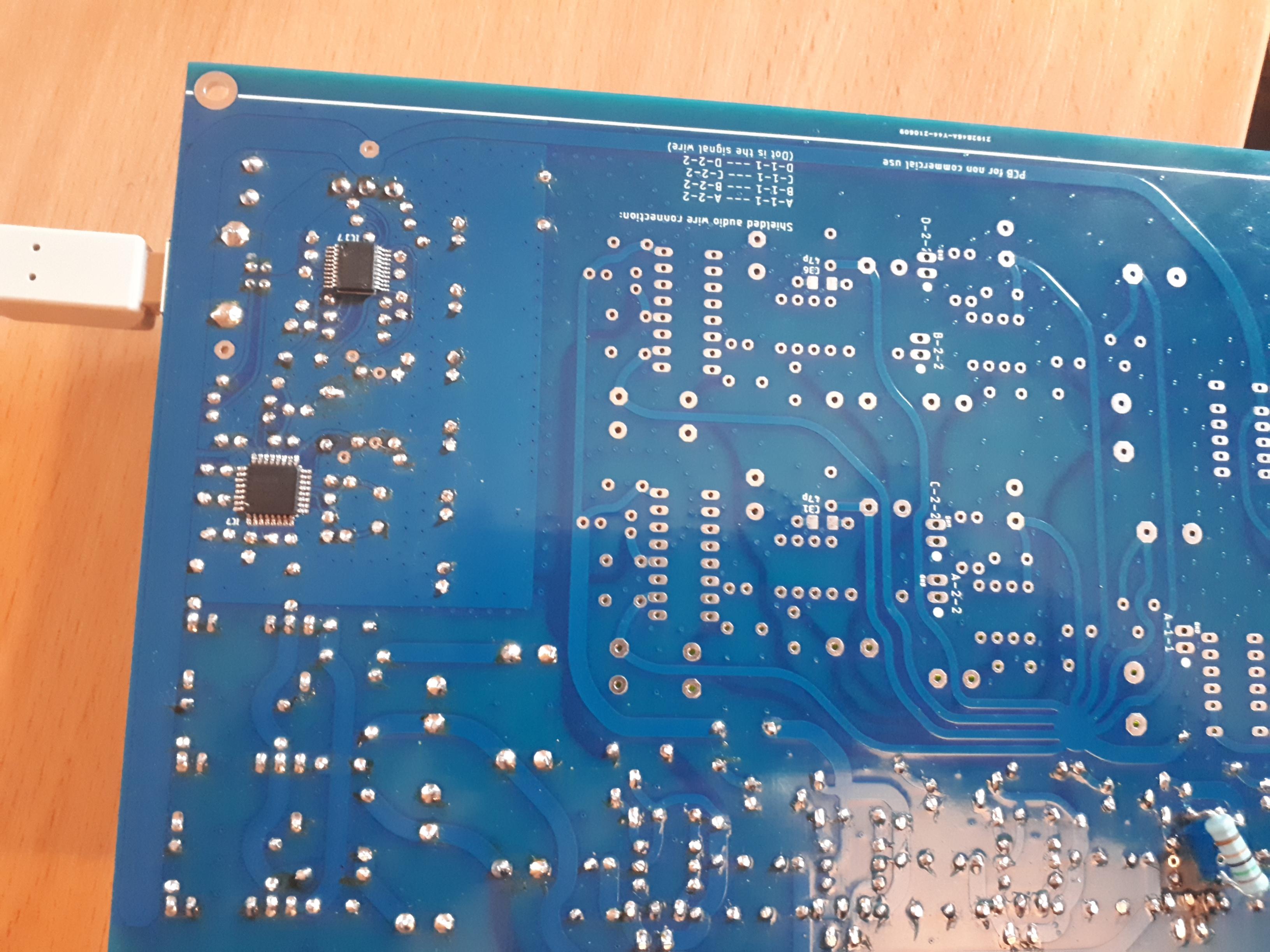

Almost done with my V1.1 board, a bit late for the party.

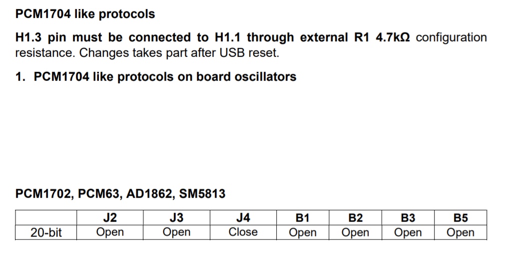

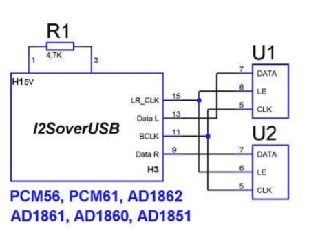

May i know how can i connect the JLsound I2SoverUsbiii to the Dac board without shift registers installed.
JLSound 4 wires out....
I2SoverUSB BCLK (H3:11) —> BCK Dac
I2SoverUSB DATA (H3:13) —> DATA Dac
I2SoverUSB LR (H3:15) ——> LRCK Dac
GND (H3:14...) ——> GND
5 wires into the Dac board...
DL
DR
BCK
LRCK
GND
Thanks!

🙂 cool assembling and clean job.
I assume the drilling on the Miro's boards was not easy. It is a good way to save space and/or make digital front end wiring shorter🙂, assuming the bigger height is not acting as an antenna in relation to the surroundings devices. I assume here casing is important enough, and not made of wood in an ideal world ?
I like the polymer struts more than the metal ones (because damping 🙂 ... I sleep better).
If you have the possibility one day, try a R-Core trafo, I often experienced when good enough made it adds more clearness, but smoother, without dynamic loss. At least that is what I experienced.
What are the big blue capacitors brand & model?
I figure out that the USBoverI2S can be piggyback on the Dac board, 3 holes out of the 4 mounting holes can be used (if drilled). I have not drilled yet but used a bit of glue to attach them. Not sure if any antenna effect, so far so good, nice, and smooth music at the moment.
I may buy some R-Core trafo from HK source to try out.
The blue caps are ELNA, it's from a past phono ps board.
