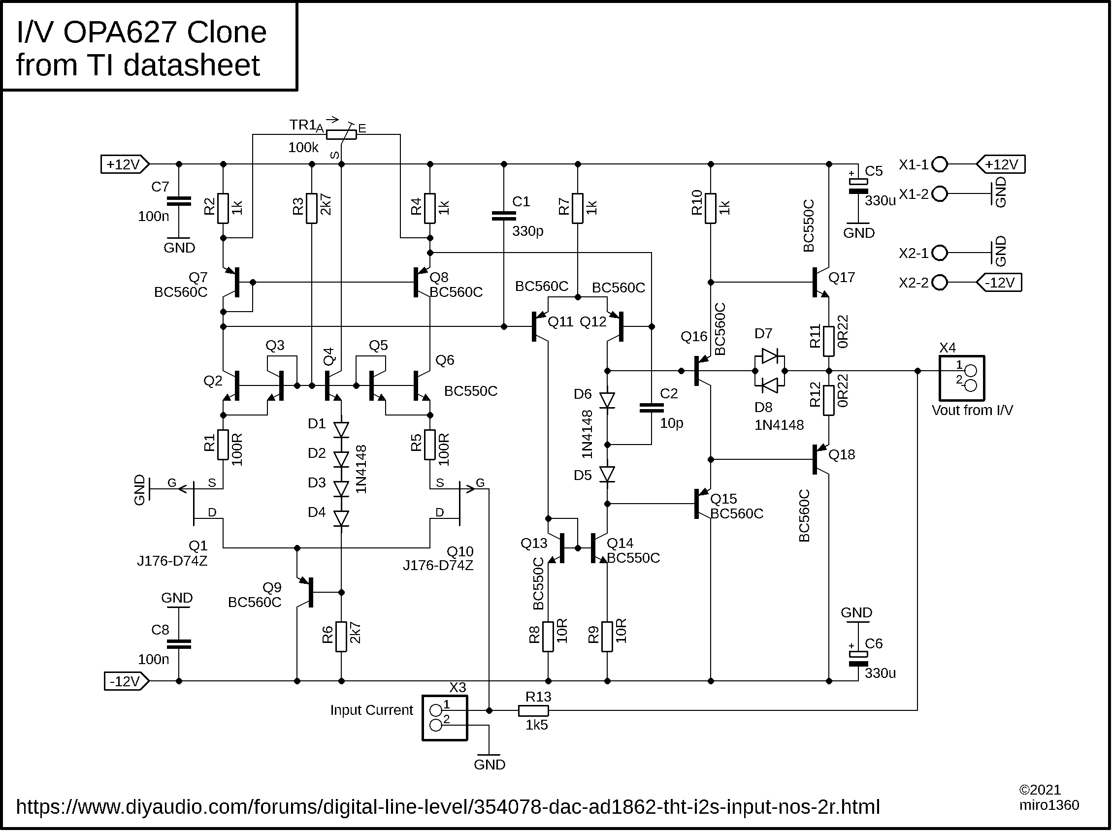

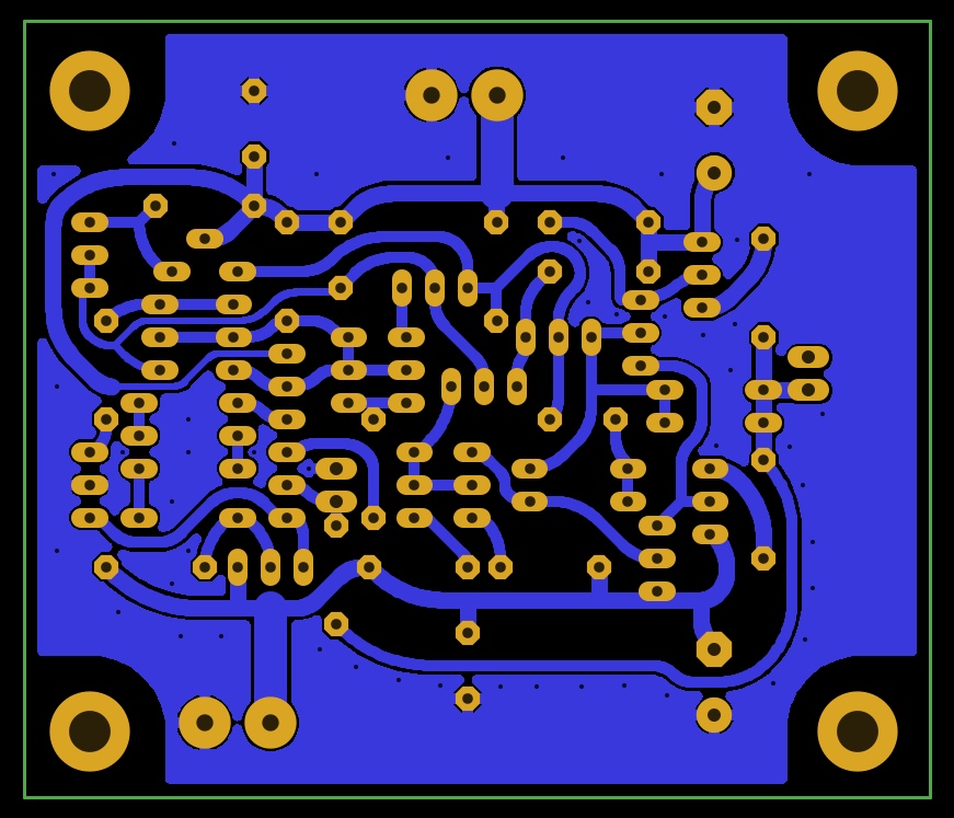

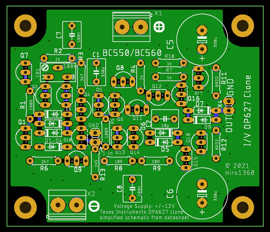

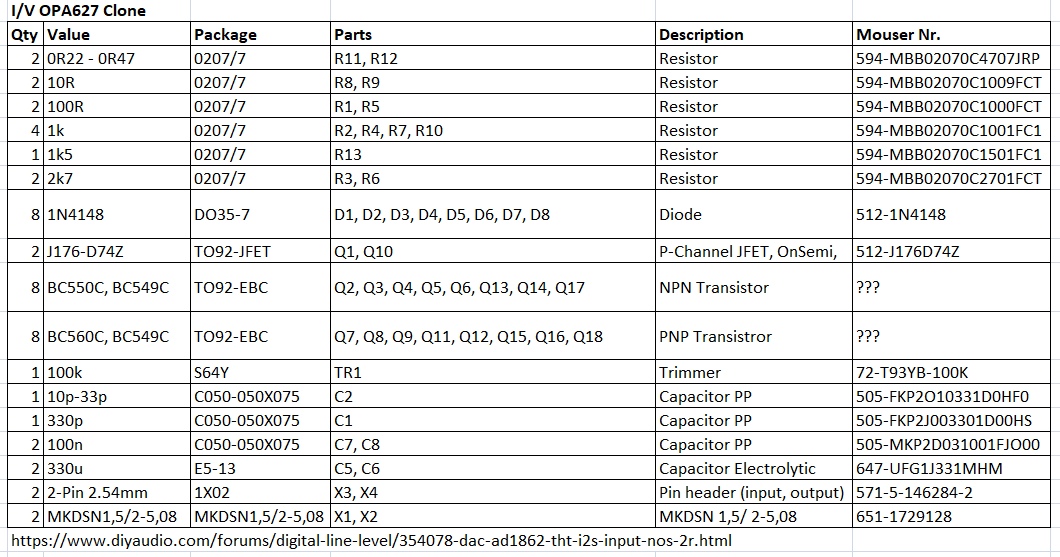

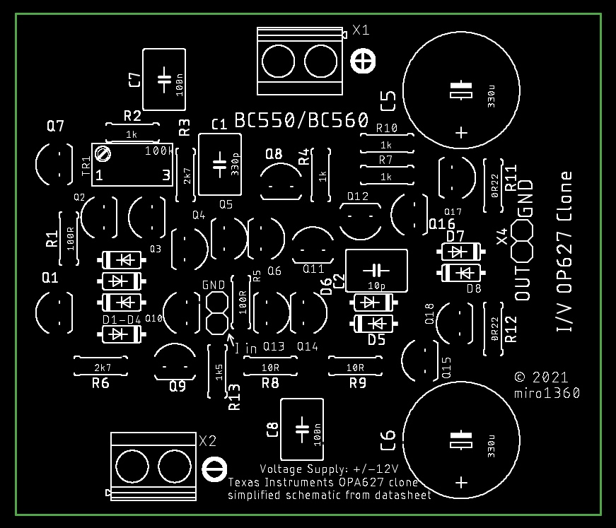

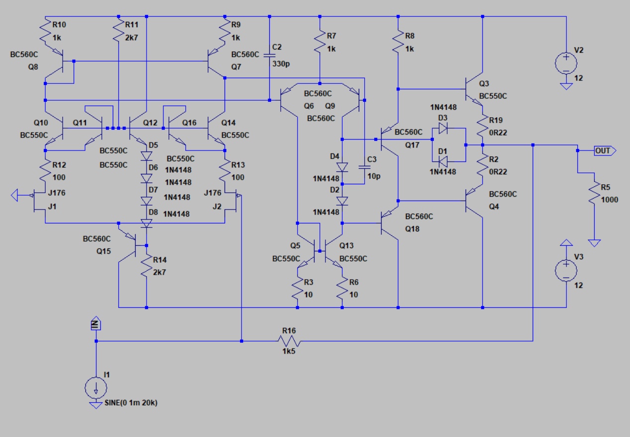

I/V OPA627 Clone
Today something different 🙂
It is cloned I/V from simplified schematic in texas instruments OPA627 datasheet.
LTspice simulation worked for me - it is difficult to say whether it will work in reality
The simulation is done with BC550/560 transistors -- similiar pin-compatible transistors should work. The output transistors can be paralleled for more power.
The feedback resistor is included (therefore it is necessary to disconnect the one on the PCB - if installed).
The necessary power supply is +-12V (not less).
I don't know what more to write about it, maybe just good luck because I didn't test it 😀

Hi miro - you could try with an SE classA output stage instead of the 'traditional' classAB. Opamps have to use classAB because the opamp needs to cope with all kinds of output load, but here you know the output load - or you can specify it. So you can optimize - the big advantage of SE classA is that there's no variation in PSU current draw vs signal. PSU noise goes away, at least to first order.

I took a look at the JFETs and found they're quite a bit noisier than those in OPA627 - the noise corner is rather a lot higher in frequency. So for example the 1kHz noise density is about 8nV whereas with the opamp only 5.6nV. Getting good noise data on FETs isn't particularly easy - the InterFET parts on Mouser just headline a number without any indication where the noise corner is. Makes me think they've something to hide.
It is well know that the J17x PJFETs are much noisier than the 2SJ74s.
There is nothing active that comes close.
The easy way round is to inverse polarity and use 2SK209.
And you can do the rest also in SMD.

Nice - I would change the OPS though to use a P-chan follower and CCS pull-up. That way the draw from the +ve supply is constant.
Personally I don't sacrifice noise for constant draw of one rail.

> To me, non-constant rail draw is noise.
If your circuit has no PSRR, maybe.
Want constant current draw on both rails ?
Use fully differential circuits in pure Class A.
As XEN usually does.
