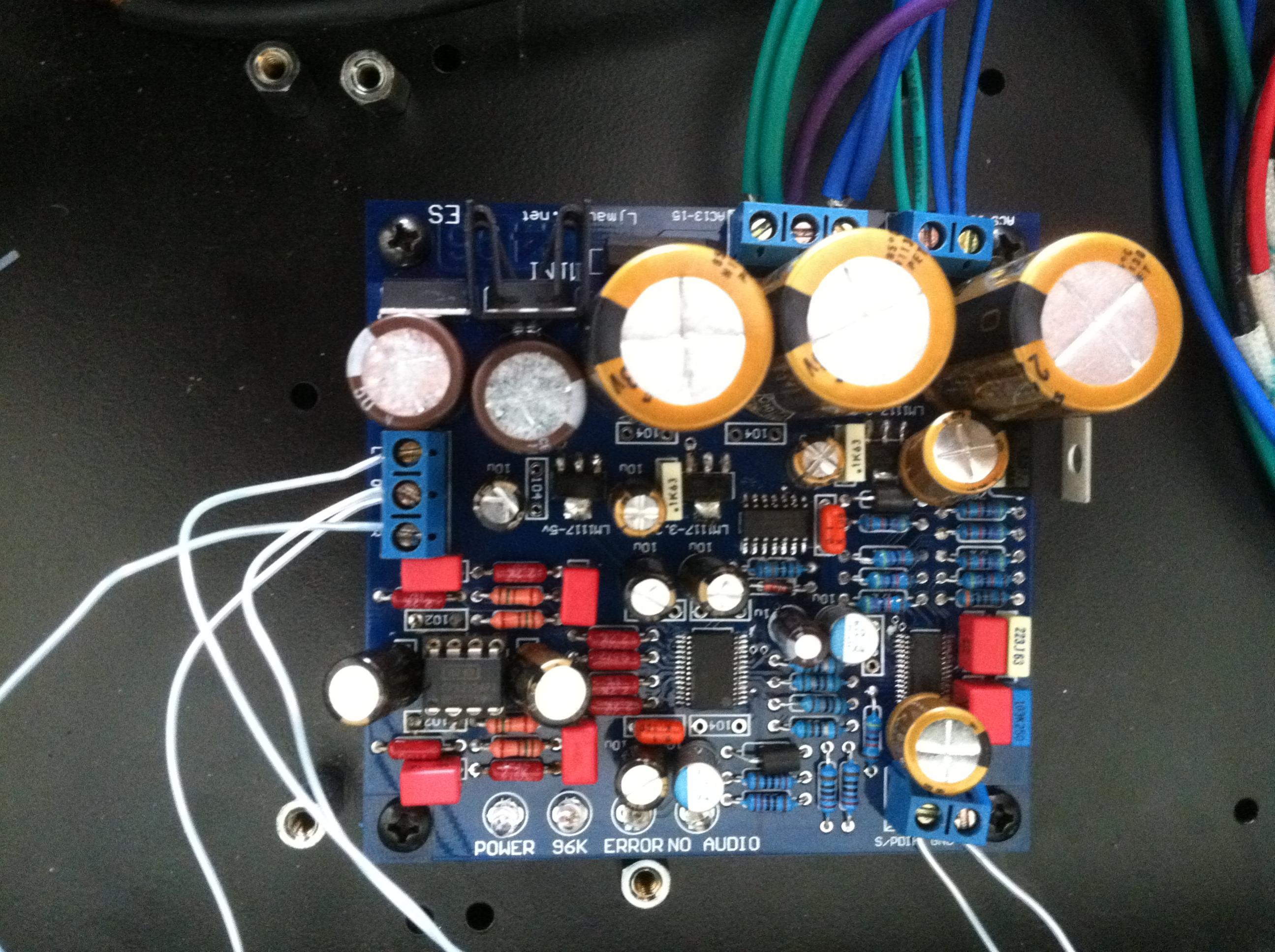

Use the 0-9v holes and solder a bridge see photo.![]()
Thanks for the info.
You could also use a centre tapped transformer if you wanted to keep the opamp, and bridge the same link.
Different board!
I am a total rookie at this!

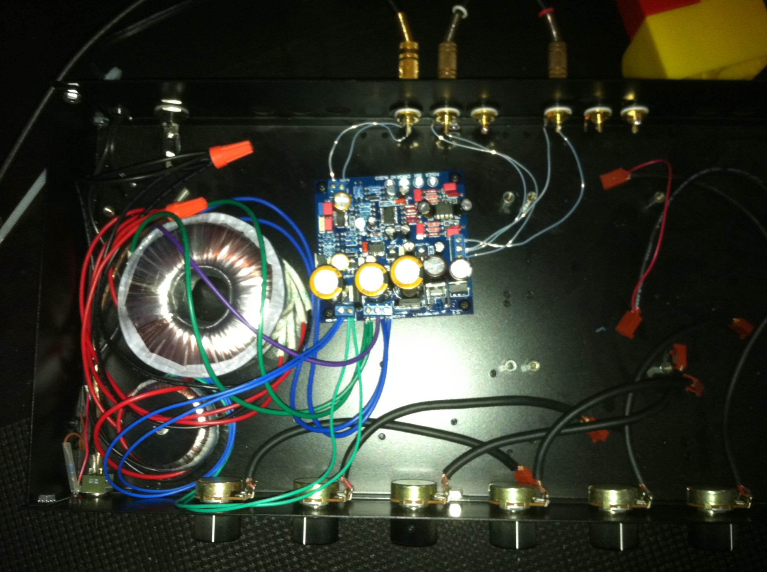

Hi Jfossb
Il try my best to let you know when the various op amps and caps arrive/are installed.
Ive tried to stick to Claves BOM as best as i could but a couple of my capacitor substitutions have had to be Nichicon Muse ones as they were easier to get hold of.
Ive taken photos for you to look at below.

Just got done popuating the board using Dario's BOM and I'm only getting 1/2 sec of output and the amp goes into protection.
I've been checking voltages, impedences, and even swapped out the OPA827 on BD, and it checks good (sounds really good) on another dac board.
I've also check component orientation, all check good. Also checked voltages at the 3.3 and 5vdc regs and they seem good.
Here's a pic. What should I be checking? I do get the power led on, but no other leds. 😕

4396 problems
I checked outputs at dac and its I'm not getting anything but hum out of dac. Again, I get a fraction of a second of output then hum. It must be a grounding issue, but why would it go into oscillation after working?
Here is a picture of my setup. I have one 15-0-15 and one 9-9 feeding the board. Again, everything sounds good until it oscillates and it's definately not the LPF section. There is definately a short because the board is causing the amp to go into protection, I get music until then. I have tried grounding everything, and removing all grounds and it still causes the amp to go into protection. Amp goes into protection regardless of whether or not my SPIF cable is connected or not.
Thanks!
Thanks!
I decided to wire a SLA battery instead of using the power supply. I dessoldered everything - 7812-912s, big caps, diodes. Despite passing through the regulators, I can say - WOW! Despite of using HD201 headphones, I could never imagine I could get a 3D imaging from them. The music has more micro detail, smoothed and good listening.
