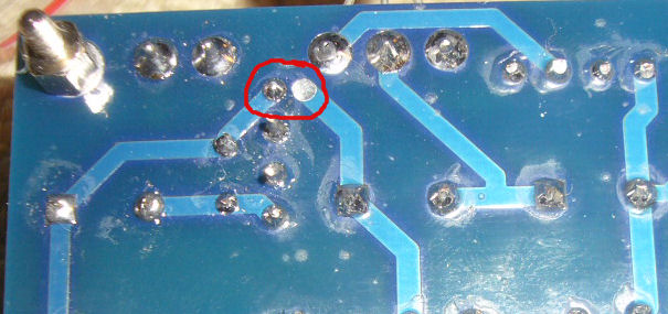

hi guys.. i just bought this ak4396 kit off ebay (a little too late, i know)
i'm just wondering, how do we connect the transformer to the 13-15 supply voltage if we only have dual secondary transformer (judging by the 3 holes, i think it requires center tapped model)? can we just put the middle + & - wires together?

It's not too late at all. Post a pic of your trafo secondaries and one of the guys will help you.
Use the 0-9v holes and solder a bridge see photo.![]()
You could also use a centre tapped transformer if you wanted to keep the opamp, and bridge the same link.

thanks for the reply..
i'm sorry, what i meant is the wires in the secondary output, there will be 4 wires. i was thinking maybe i can get center tapped by connecting the 2 middle wires?
this is my transformer: Buy Toroid Transformers Transformer,toroidal,30VA,0-230V pri,50/60Hz,2x0-15V sec Nuvotem 0030P1-2-015 online from RS for next day delivery.
or maybe i can just put 2 wires together and connect it to the + and - terminal, then pull a ground wire from iec jack directly to the board?

Based on the datasheet on that site, I think taking the yellow and black together will give you the 0 Vac point. Orange and Red are then the 15 Vac points.
Orange - Yellow/Black - Red

yeah, thanks for the hint.. i got it later last night 🙂
Maarten
i thought so.. thanks!

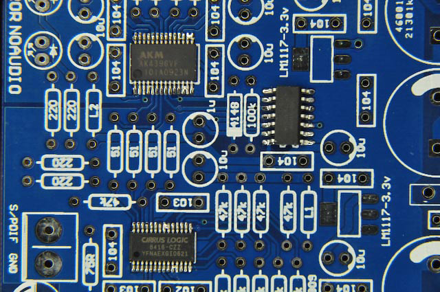

Hi Folks,
I was about to send this board back but I though to check the schematic and it looks like the shorted pins on the two IC may be intentional?
Can someone please confirm this is not just sloppy solder work?

Hi Bill,
don't worry about it, if you look at the schematic you'll find those pins are joint.
Thanks Dario - I saw the same bridges on my new board today and was suspicious. Glad to know the supplier is taking care of us. 🙂
See post #1077 for details of shorted pins.

Phew! Thanks Dario, and jnewbold,
If anyone is unsure as I was, check out the schematic
and post #1077.
