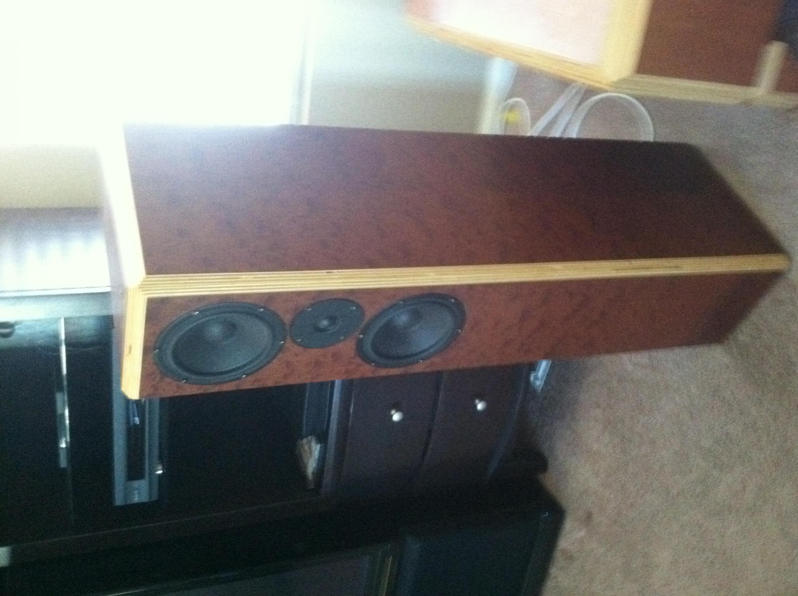

Yes, and with the OPA827 on BD this thing sounds goooooood. Just getting ready to put in on a larger rig. The picture attached is an MTM that I built, veneered in 1/42 makore.
See, speaker building is my thing, not line level stuff. But, I'm learning. 😕
That's a bdp-95 you see in the background. Let's compare them....
Wow Greg! 😎

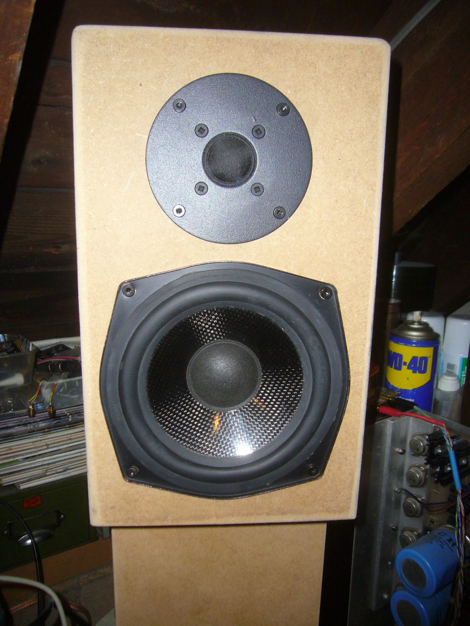

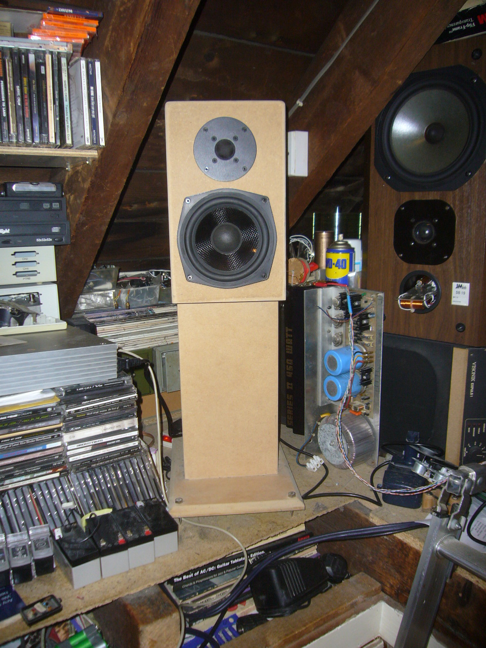

Just built these for a pal they love this little DAC.
Sorry Clave Off topic.
Thread is not mine...BTW very nice building 😉
I realised my AD827 was not the same after i posted it, however I don't plan to be using an op amp in the future as I much prefer a discrete approach these days. I had great success with Giorgios (from TNT Audio) output stage on my TDA1541 DAC Just a matter of time before one of these is hanging off the end of this little gem. 😉
