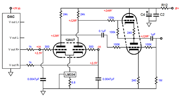

@ggetzoff, where did you see 1k value?
About the resistors, I only changed anode and cathode resistors. 150R cathode for the Broskie and 150R cathode again for the anode follower. B+ is 220V, anode resistor 11k.

The Unbalancer
Here's Broskie's schematic for VOUT usage and the link. Great article BTW.
