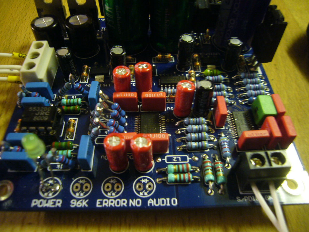

Wondering if anyone has tried The nichicon KZ in place of the Elna RFS, and ROA on the PS+ ?
I've tried also KZs and Cerafines are way better.
IMHO KZs are somewhat confused.

I´ve been listening some more,and I think this DAC sound a little darker then the CS4398.What do you others think?

Hey, thanks for the listening comparisons on the caps guys! I Will have to get some Elna Cerafines And Slim's! That PARTSCONNEXION website looks solid, thanks for the tip off. I should've looked harder. As far as removing and soldering the new parts whats the best approach ? I just got a 40 watt soldering pen and a hi Wattage Gun, I've never soldered or desoldered anything that I needed to be as precise, and also worrying of heat saturation of the parts! Last thing i need is to Burn up quality ordered parts. Hit me with your "Dont sweat the techniques", Your do's and don'ts of fine soldering please. All your info has been of great help, It keeps me from 2nd guessing everything until im in a tizzy!

Just heat up the joints and rock the cap until it comes off, I would suggest you buy a desoldering pump from partsexpress to clean up the holes before you solder in the new cap.
Desoldering Pump 370-030
Hi, buy a desoldering pump and hold it on the joint while you heat it with the iron.Just heat up the joints and rock the cap until it comes off, I would suggest you buy a desoldering pump from partsexpress to clean up the holes before you solder in the new cap.
Press the button and most of the solder will go up the pump.
Then you can heat up the joint and pull the cap if you need to.
Pulling a cap without a pump risks pulling the solder tab through the hole, past experince😡

I have both, CS4398 and AK4396. If using opamp as analog stage, CS4398 is much better. When I change to transformer output, I like AK4396 much more than CS4398. Both DAC sound very very good with transformer. But AK4396 has more detail and thicker sound.
I tested them with UTC A20 borrow from my friend. Now I'm using unknow 1:1 pair of Russian military transformer which I think be acceptable in comparison to UTC.
