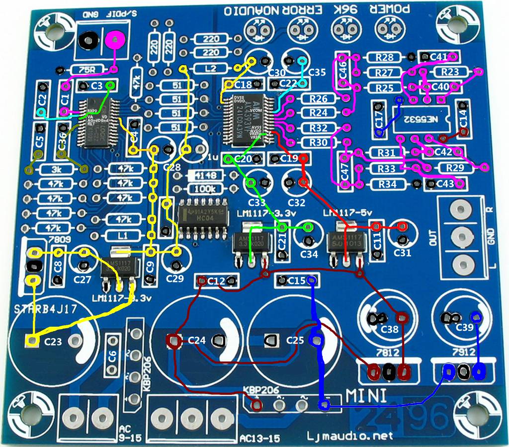

Power supply is 2x15vac... with 2x 15000uF/25V
Just made some minor changes to the 2496 dac power-supply:
- replaced the standard 7809 regulator by the ON-Semi equivalent (with bead on output wire)
- inserted a 2uH in the connection of the analog supply to the digital supply, thus creating a low-pass filter in conjunction with the 2200uF/100nF cap improving seperation of digital and analog supply.
I did not replace the 7815/7915, because of the frustrating hassle of de-soldering them and I did not want to cut them up...
Result:
- The sound-stage cleaned-up a bit more. Instruments gained some detail and separation.
- The high-hats are more defined, with that characteristic "tjsss" sound they ought to have, without any harshness. So a bit of "Audio Nirvana" ...
- Bass is still firm, but gained some detail 😎
In short: A disaster for the vendors of ready built DAC's... for I won't buy one in the foreseeable future 😉

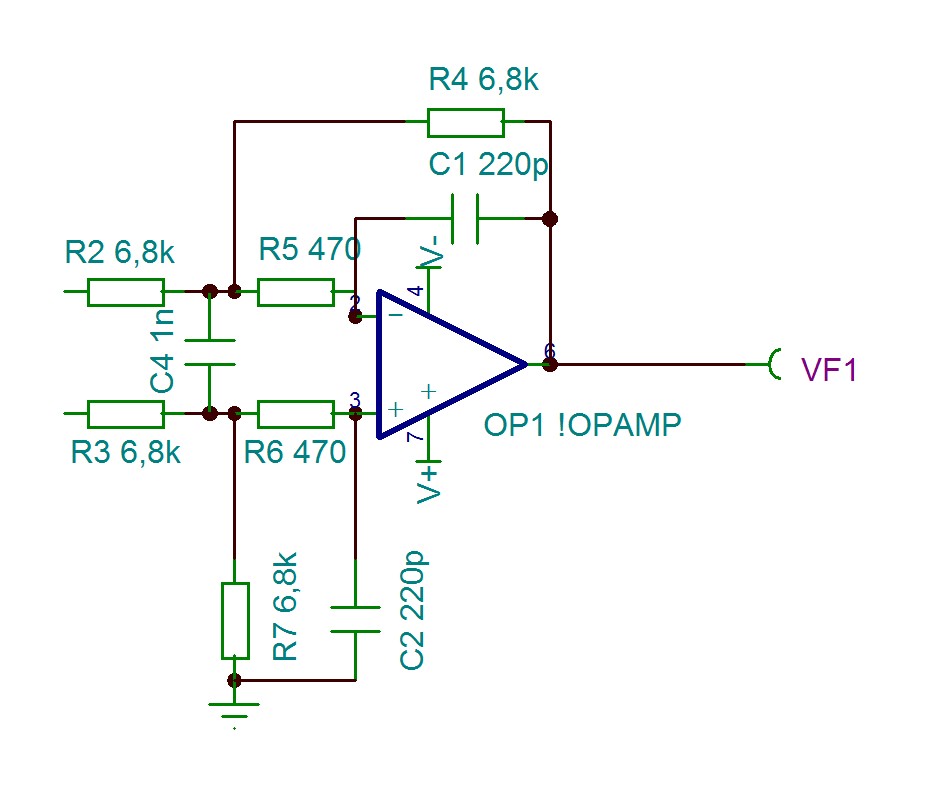

I was wondering if anyone dealt with the analog part .. I'm threw out opamp as soon as heard first sounds, and put in a buffer that sounds much better..
In the meantime, I discovered excellent LT1363/1364, I'm thinking now how to use them in this board..

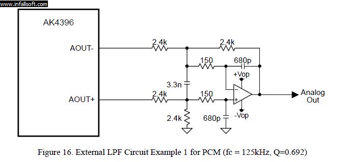

So, analog filter on this board have everywhere 1K resistor, capacitors 3n3 and 1n .. and when you look at the AK4396 pdf they suggested completely different values , closer to the sense..

If I were you, I'd change the C's and R's in the Filter section. I can't comment on the sound produced in the 4393 configuration, because I implemented the proper values initially (along with a number of other adjustments). It is quite a puzzle to find the correct locations of some components. I bought more resistors/capacitors than needed so I could select the best matching ones. Resistors are now within 0.2% and caps 0.5%..OK, what is advice?
I did not quite understand, problem is to find a place for some resistors on the board? Can you mark in board picture where is place for 150R, others are 2k4..
OK, what is advice?
No advice, simply you're right about the wrong values, I've come to same result at the post I've linked.
If you search on the thread I've posted a pic with parts position and numbering.
BTW you can find that pic and my upgrade BOM faster here.
what happend to your AK4399 project? never came up with a BOM!
An entire BOM is not necessary, my recommendations for the DAC9 are still the ones in this post.

R25, R27, R31, R33
Thank you, I will try opamp output from AK4396 datasheet with LT1364..
Guys, please look at pcb drawings
http://www.diyaudio.com/forums/digi...kit-cs8416-ak4393-5532-a-270.html#post3910388
C19 and C20 provide separate power line to AK4396 pins 17 and 18.
I don`t understand why shortcut present between 17 and 18 pins.
