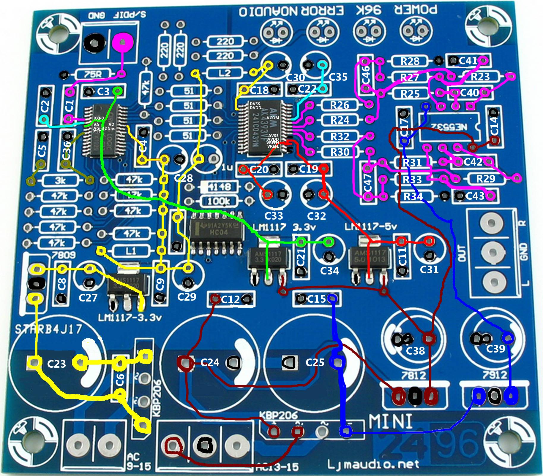

hi,
i did the i2s mod and now i'm seeing how in the default configuration this will limit the dac to 96khz due to both DFS0 and ACKS being pulled permanently low (no 96kHz pin on cs8416 anymore).
there is mention of pulling ACKS to DVCC by lifting pin28 and installing a jumper. while i see the vacant C18 as being an option for this, the schematic shows pin 26 (TST1) being connected to DVCC already. that would be a shorter path and possibly could be done without the use of a jumper wire with some clever bending.
can anyone confirm that pin 26 follows the schematic and is pulled high? or will i need to install a jumper over to the C18 pad?
thanks,
-matt
edit: it looks like it will do 192kHz as-is (though the table in the datasheet doesn't show this). is there an advantage then to putting the ak4396 into auto mode?

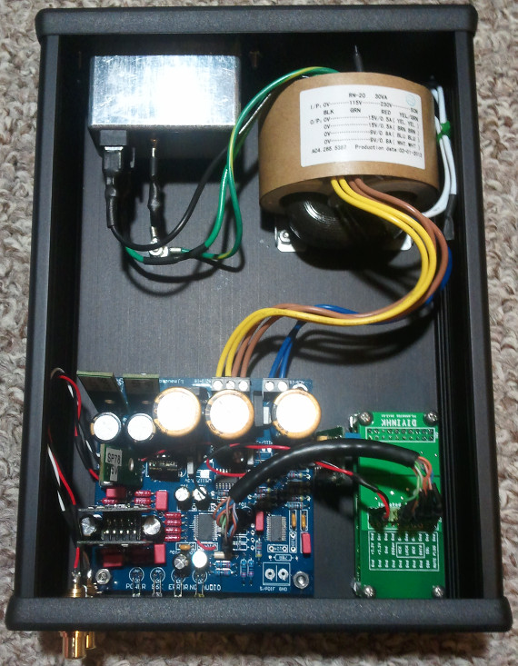

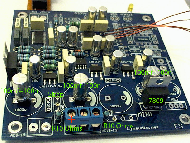

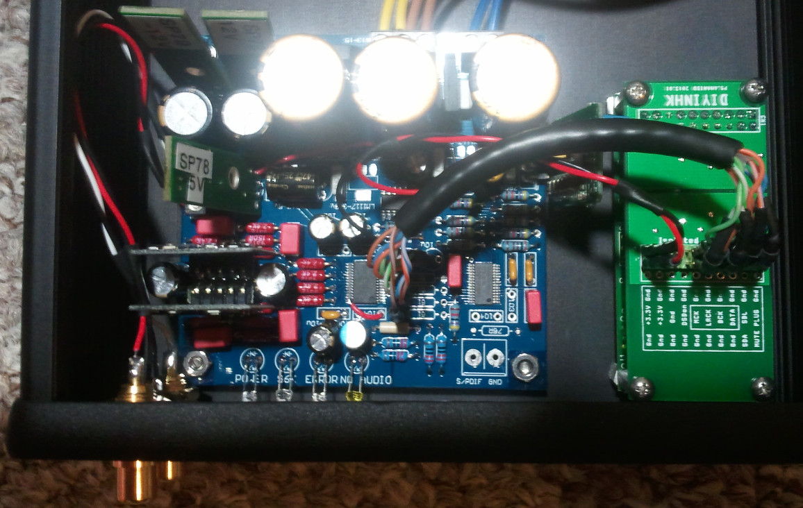

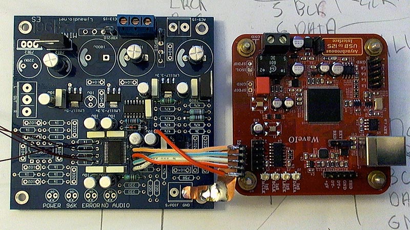

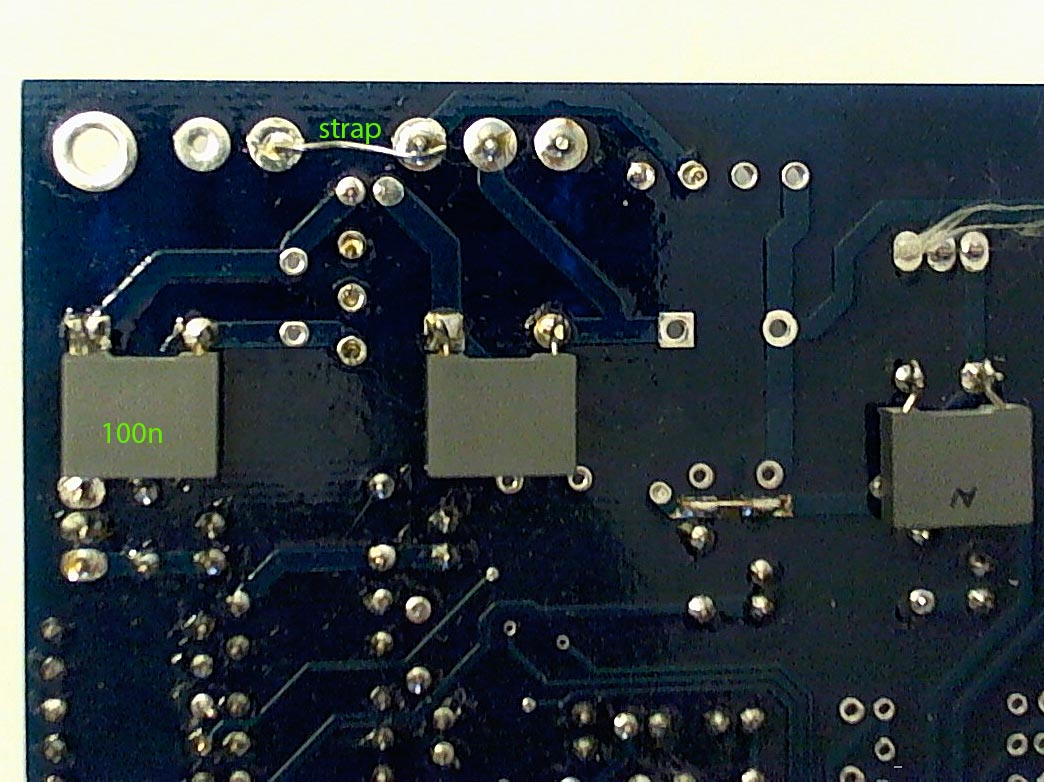

finished mods
hi,
i went ahead and lifted pin 28 and pulled it to DVDD with a small jumper. seems to work well, i haven't tested higher than 44.1/16 yet though.
here are some pics showing the mods (summary):
1. remove/replace all regulators on board - op amps have +/- 12v belleson, dac avdd has 5v belleson, dac dvdd has 3.3v tps7a4700 regulator board
2. remove 51ohm resistors, capacitor c28, for i2s and gnd connection
3. remove inductor from cs8416 power to pull 3.3v for amanero isolator pcb
4. add 100nF PPS smd capacitors at 47uF cerafines (c14/c17) for better decoupling of op amp
5. not really a "mod" but i got a dexa discrete op amp 🙂
6. lift pin 28 from ak4396, jumper to + pad of c18 to bring dac into auto detect mode
7. isolated i2s input from amanero over cat6, inline 100ohm resistors at source side
a few hours of effort required to make the i2s cable, and trimming dc offset on the op amp took a while, casework took forever, but i think it's a whole new dac now.
how does it sound? good 😉
-matt
