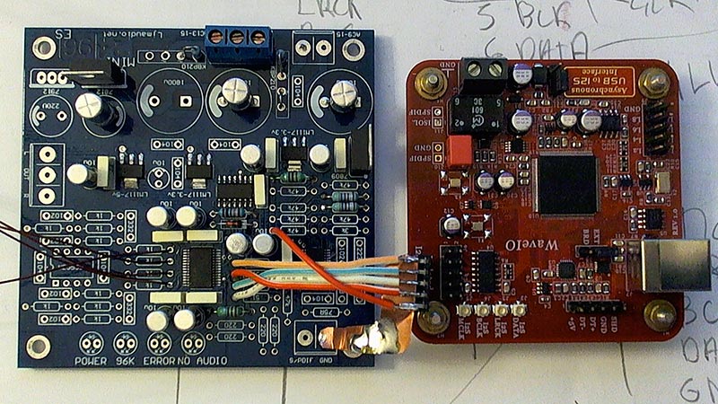

thanks for the pic:
now i order the cm6631 kit which have spdif and I2S, but i think use only the spdif.
about the coupling transformer, the price is high so i use 0.22uf cap for coupling between the DAC and power amplifier.
i think to move to cd player instead the pc, maybe the quality is higher.

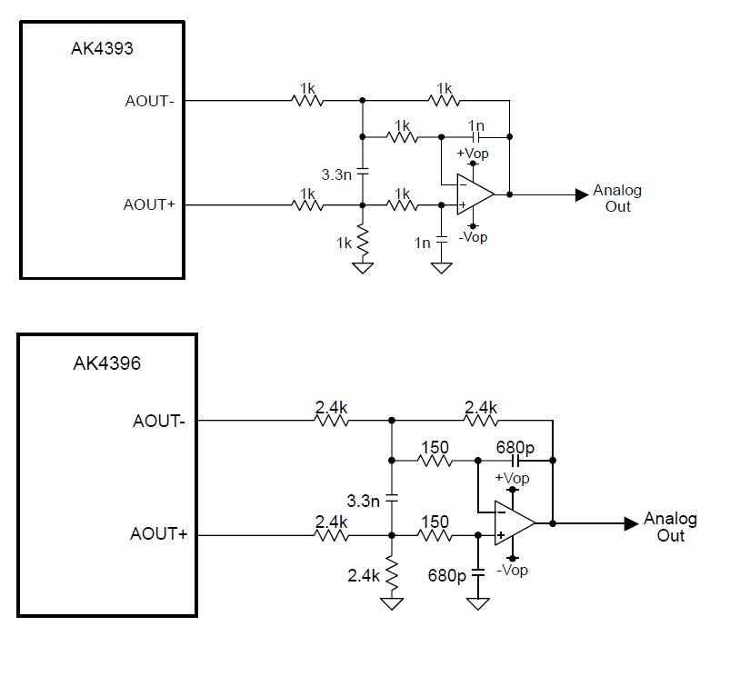

Use an ordinary divider at the output of the opamp... about 1/3 of the output voltage will do.hi
how i can down the gain in the ak4396 LPF according to the datasheet?
thanks
I want to make a tube buffer output for this DAC and I settled on a Broskie Cathode Follower or Unbalancer circuit. Now, I'd like to know if I need the Unbalancer circuit over the BCF as I read there's an extra voltage amplification stage in the Unbalancer. Is that needed? I am driving a small TA2020 amp at the moment, and I'll be experimenting with a tda7297 chip amp and maybe a lm3886 gainclone. Would I need the extra gain from the Unbalancer?

Anyway, before blaming the dac itself, we really should inspect the analog AF section to see if it is set for desired output or not. Albeit slightly more difficult to see, any small signal power decoupler cap is also an audio cap because your signal will go through the power decoupling caps the moment *before* you hear it, so those may also need inspected and the values adjusted when necessary. The decoulpers have a lot to do with midrange, but would probably not cause bass foldback 2nd order harmonic distortion. Necessarily, the capacity does exist (this is not impossible); however, it is far more likely for the AF (audio frequency) section is not adjusted for a favorable H1/H2 balance of bass.
The datasheet examples of most chip audio amplifiers of any size are usually inaccurate and indeed it is a fantastic and epic prank when they're accurate because I'd try everything else first. These things are probably at the output of your DAC and will definitely need inspected. Some DAC's have a high voltage output then followed by a chip amplifier set for maximum negative feedback so that it will perform as a buffer, which is a most grievous error and the rare case where you should not use a chip amplifier but rather a purpose made buffer instead. Or the alternative of using a diode clipper to protect the DAC from surges and then TWO audio amplifiers, allowing the differential DAC to facilitate a bridge amplifier will be much more entertaining than a quality blockade. Almost all audio amplifiers contain a phase splitter, but it is really crazy to have a balance to unbalanced converter at the output of your DAC and then a phase splitter, which is an unbalanced to balanced converter in the amplifier. That's bonkers. It could be nicer to bypass that whole section and allow the differential output DAC to drive the large signal amplifier without the redundant conversion processing.
