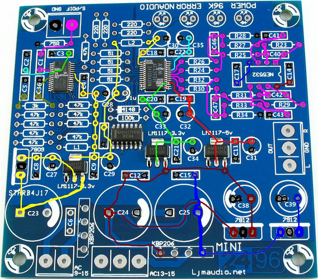

It's not a separate line, it's the same line. Look again at the schematics.
I have just looked again.
Two separate LM3117, two separate capacitor C31 and C34 on input LM.
Two separate C19 and C20 on outputs LM`s.
Independent lines until 17&18 PINs of AK.
There is shortcut.
There is shortcut.

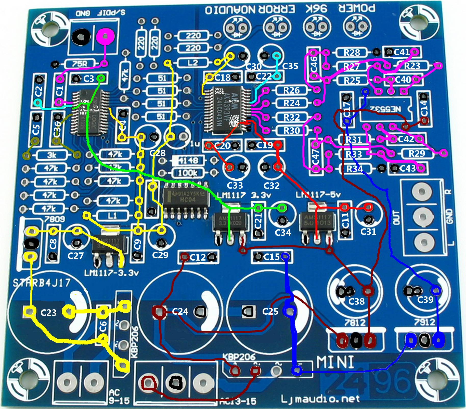

C19 and C20 are not separate. They share the A+5 line and the ground.
Wieslaw thanks and sorry because mentioned drawing is wrong!
So many pics...
Two pictures. No different in line C20 🙂
I agree the second one is may be right but on previous page we have the first one.
Ok, close the question, all is clear.

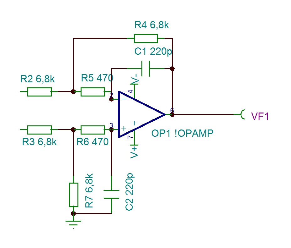

I recently made something like: op-amp as buffer/unbalancer, and it is driving LTR-110. For now it is best config i had. Still asking for help with cracks... Checked voltages, solder joints and nothing 🙁
Vulejov-
May I ask what op-amp OP1 in you drawing is? Does it matter if one uses 5532 or LM4562? I think it does...
Between NE5532 and LM4562 are no significant differences..
I use LT1364, works substantially better..
