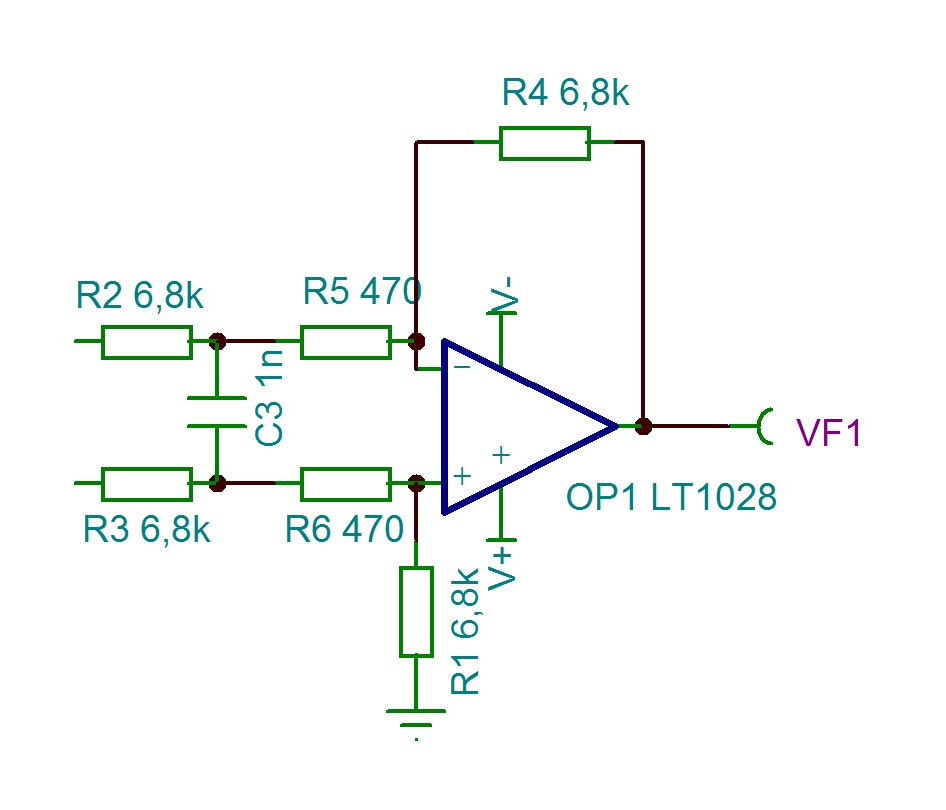

I read the topic, a bunch of nonsense, who serious can use the transformer at the output?!
Naked chip out has some disadvantages.. output impedance, coupling capacitor, half of voltage, lack of any filtering..
Try to make output like mine, then give a comment..

Hi I have one more question, I'm feeling lazy in sourcing another transformer for the 9v line, and I read from somewhere that it is possible to short 2 pads on the pcb to eliminate the need of second transformer, but which?

Hello, please at the picture posted posted by potiron on the 3rd March 2012 :
http://www.diyaudio.com/forums/digi...-ak4393-dac-kit-cs8416-ak4393-5532-a-128.html
I did some tests switching from dedicated power (9V batterie) and this shortcut to the 12V and did not notice any difference on the sound , at least with my amplifer, speakers...and my ears!. Guess that the key is a good transformer (torric).
Much thanks for your help!
