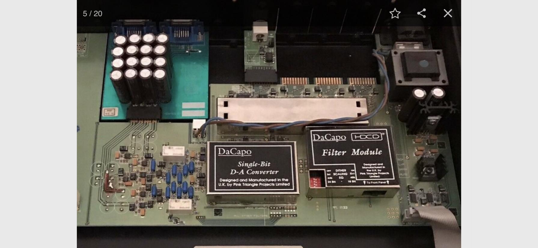

Here is a question. Someone who worked at PT reckons PT managed to make the da-capo with one of caps under dac metal can the wrong way round. Did they actually do this? And if yes what did it do and would correcting it help any?

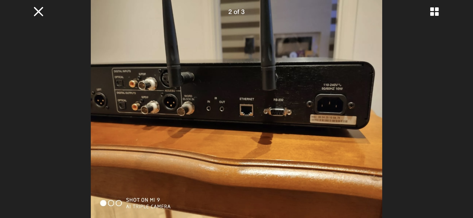

Mr MAC,
If you can confirm the transporter supports 128 CLK input - also once clocklocked, then you can only playback 44.1KHz files (CD rips etc).
buy cutting track sunder the potted module and injecting the clock then you can bypass the DAC's PLL based clock - driven directly by the Crystal on the Clock lock DIC...
WRT the reversed Cap under the potted DAC section, I'm not aware of this, but this might have occurred after I left PT - it would explain a later Dacapo board (built after i left) I have here that failed under the potted section... It could be a Tant cap reversed in the PLL Loop BW filter...

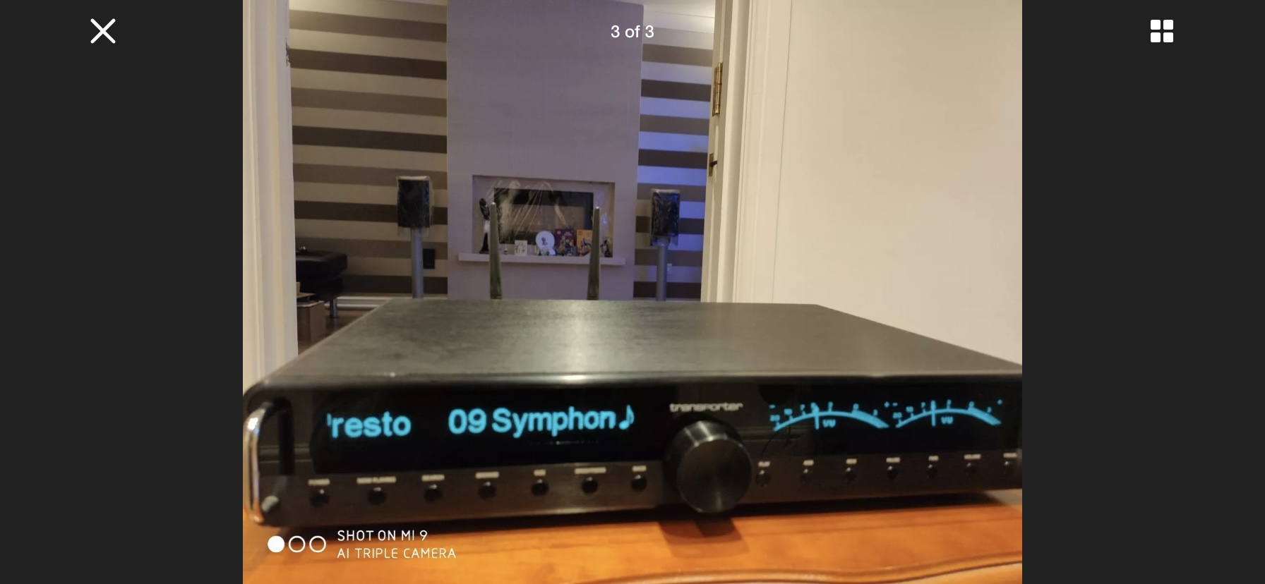

Yep appears transporter and m2tech evo2 usb-spdif are only two ways to clock lock da-capo to a streamer/music server type setup as they are only two I can find that will take a 128fs word clock.
Will also compare spdif non-clock locked and the transporters own dac via its balanced outputs and see how each performs and what wins out as best performer.

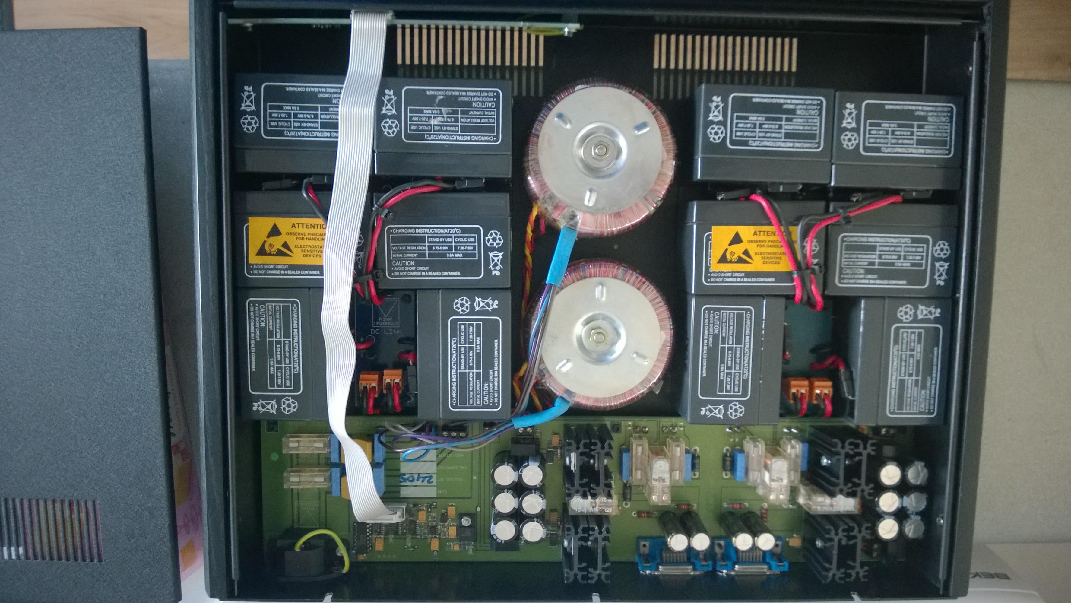

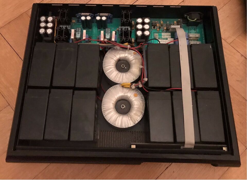

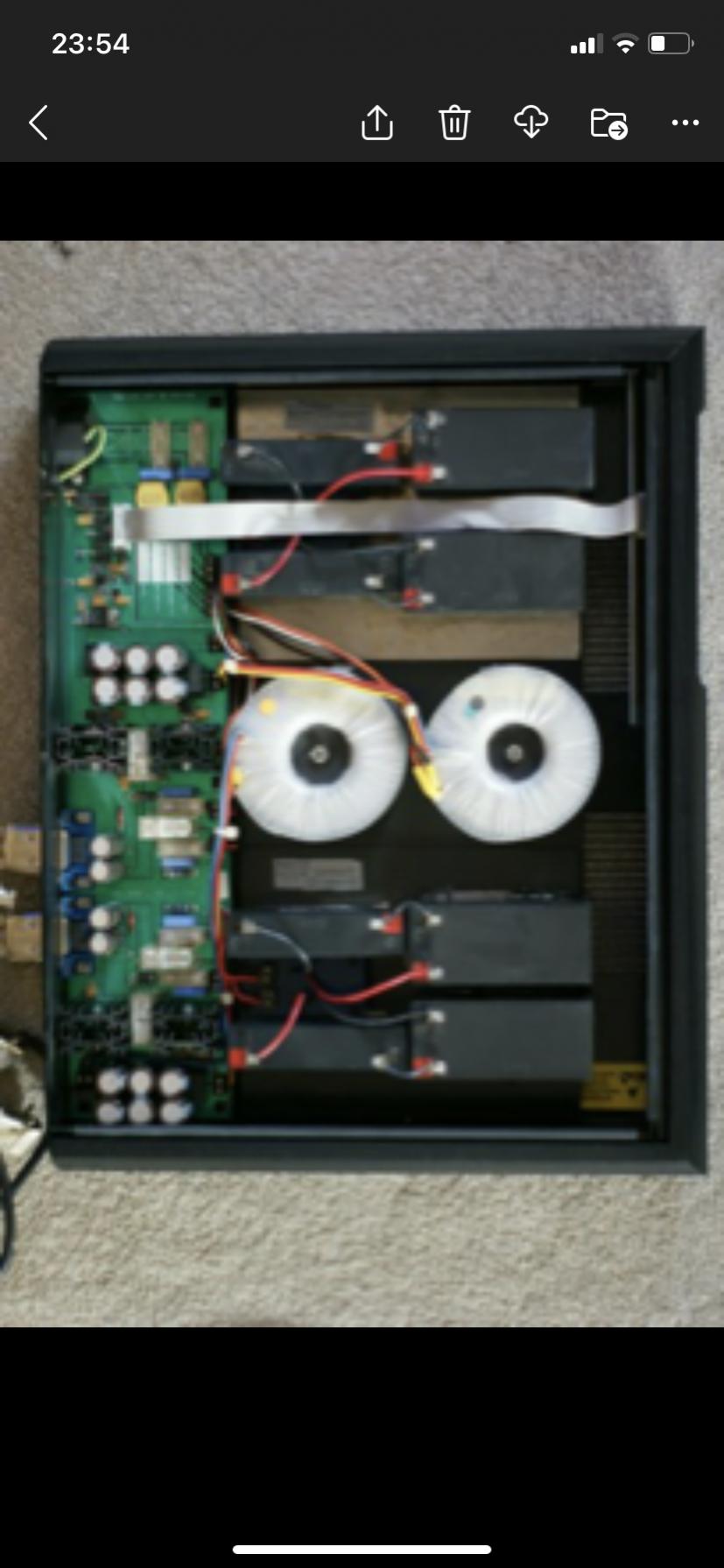

What batteries should be in the DC????
My old on had a larger and smaller battery in 4 banks??? (Just a guess) 1 larger and 1 smaller so guessing 12v and 6v making 18v. I have also seen same arrangement but using 3x 6v cells. Tonight I am seeing what looks like all 12v cells (or are they just large 6v ones?) yeah must be bigger 6v ones and sure my current one is using 3v cells so 6 per 18v bank.
See the three photos. I take it it’s just a case of what will fit in case and maybe people maximising capacity fitting larger cells.

Hi Mr mac,
So you want 18V per Bank - and the largest cells you can find that will fit the case.
I believe (from feedback that came to me) the original Cell size is no longer available - the cells used in the last unit pictured is a great solution if the are 6V cells...
WRT to the German unit - I have no idea whats going on here, you can see the same type caps have also leaked on the DC input card - and the caps in the Digital section, so these should also have been replaced...
