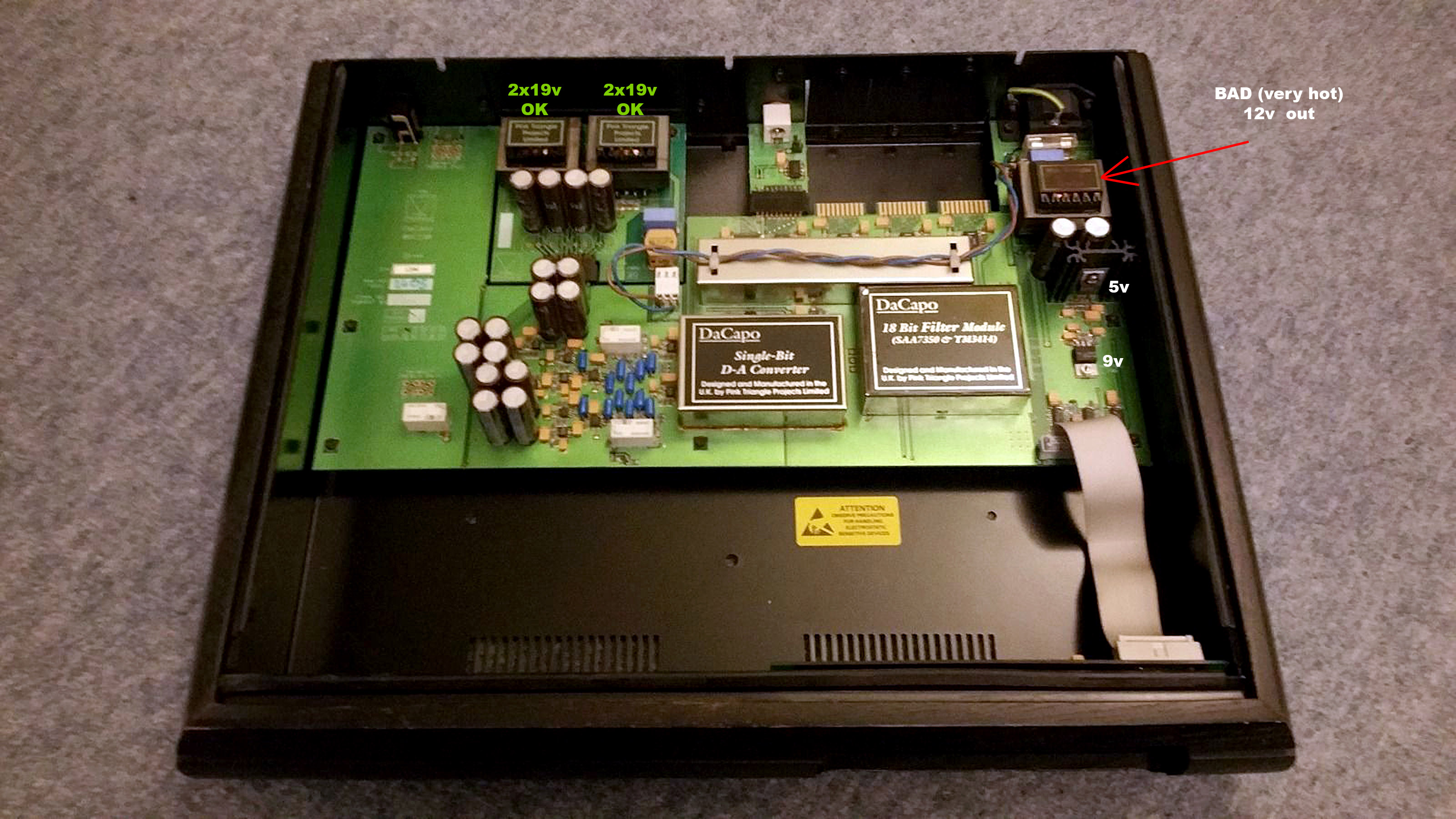

Dacapo voltages
Please help me. What is the voltage from the transformers? I have one gives out 12v (hot!) Another pair goes 4 lines. 3 of them give 18-19v and one 16v (?!). It seems to me wrong.
The two transformers on the mains card should all be putting out about 19v DC (after the rectifiers). If one has a low rail it is likely being dragged down by excessive loading (did you replace all those old 2200uf capacitors?). If the PCB tracks are corroded by rotten capacitors and you did repairs then checking that you re-instated the tracks correctly could be another place for your attention (The PCB is simple enough but I can tell you from experience that it is difficult to get a picture of a PCB that hasn't rotted so that you know what to aim for, only later issues of the board had capacitors that didn't leak and rot the PCB's).
The single transformer on the right side (looking from the front) is for the logic and is usually a couple of 9v windings in parallel (but I have seen a single higher current 9v winding used), fed into a bridge rectifier and then a couple of 317 to-220 package regulators. The PCB indicates 8v2 on the tab of one of them if memory serves correctly.
Hope that helps.

Voltages
The transformers are just 15v - 0 - 15v - 0. If one is only putting out 16v after the rectifier and the transformer is getting hot then you have a problem that will likely cause premature failure of that transformer. They are a total pain to replace because of the pinouts (I had to replace one of mine and paid to have a custom wound transformer rather than chop up the PCB to make a cheaper one work).
Suggest that you put a small value resistor in series with the rectifier output and measure the voltage over it so that you can then calculate the current draw - repeat for the other rail from the same transformer and compare. If they aren't similar then the problem is not with your transformers.
I wrote it wrong, sorry. The problem now looks like this.

Transformer problem
The tab of one of those regulators should be at 8v2 - if you have 9v then you may have shorted secondary windings where the heat has caused the insulation to fail (the transformer will get hotter still as a result of this).
I think this regulator feeds into further SMT 317 regulators used for the CS8412, ec.
Strongly suggest you replace this transformer before it fails and takes out half the logic on your DAC board!
I think this transformer is under sized anyway - it might be a good idea to replace this with a 30va 9v? (Check voltage!) toroidal transformer located towards the front of the case (there is loads of space there and it will be much easier than trying to get a drop-in replacement).
Thank you for this information! This is exactly what I needed!
