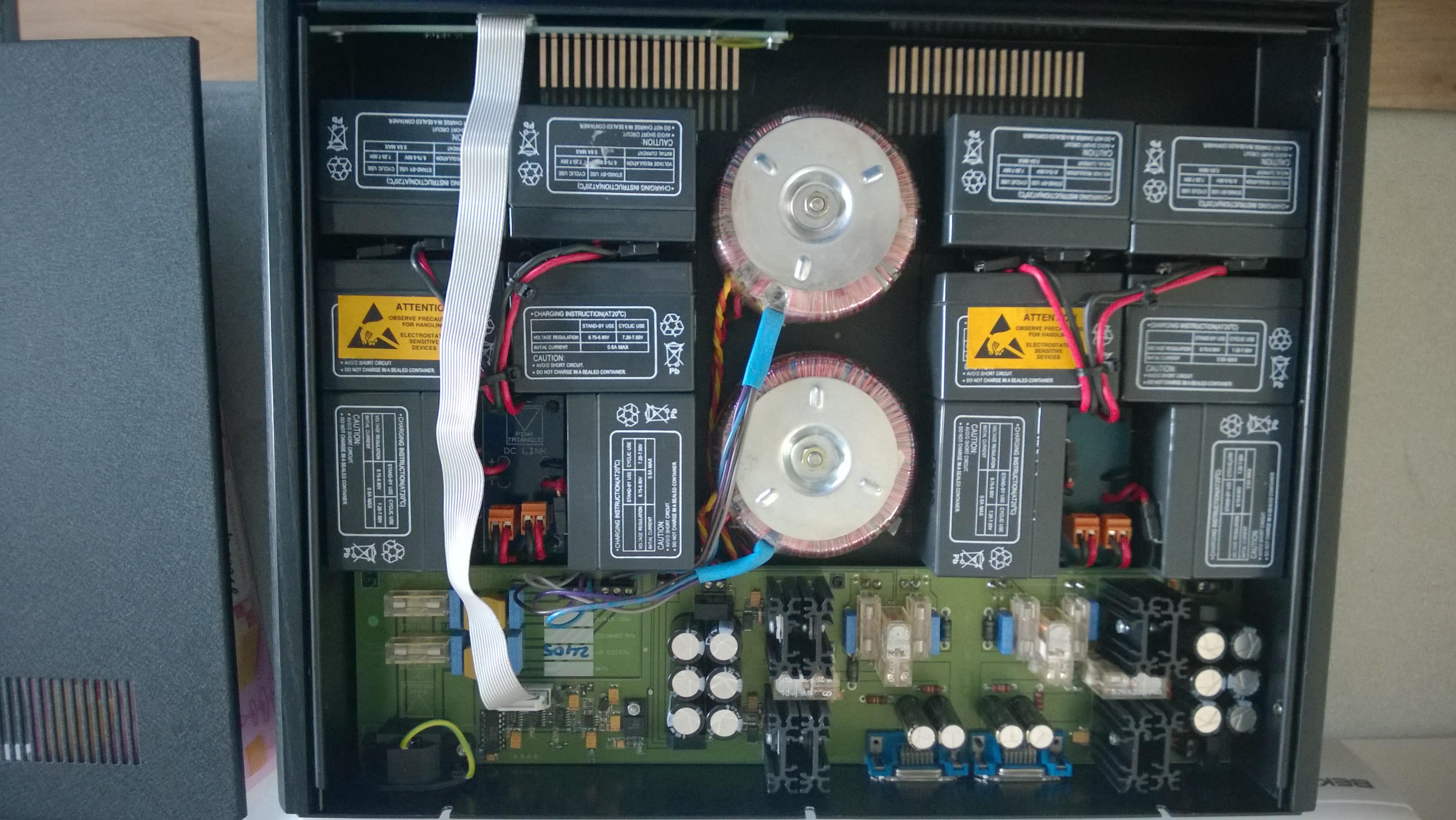

WRT Cell size, its important that all cells are the same type as 3x6V cells are connected in series for 18V per bank.
The charging circuit does not load balanced so if one cells has higher resistance it will see higher charging voltage... Lead Acid cells dot like this - although they are thankfully nowhere as sensitive as LiPo etc.

Makes sense. Will keep to 3x6v and all the same brand/type.

My freeking DC is dead �� No lights at all battery or A/C
Do very dead batteries cause the unit not to work at all?
Will check any fuses too.

Hard to say remotely, normally the DC should work with battery's removed - but what worried be is that the same caps the leak on the DAC PCB are also used in the DC...
Remove battery's and check fuses - see if the DC works without the cells fitted (it should).

The caps on this DC were all changed out very early and tbh iirc the DC isn’t a complicated multilayer board so would hope should have been easy to clean up to stop any issues.
I’ll take cells out and check all the fuses. Now need to figure out where the hell I put the original PSU card for da-capo as well. Hopefully in one of PT boxes in loft.

Fuses fine, batteries disconnected as suggested and nowt (though admittedly two cells have developed almost slightly melted looking shapes to the sides).
So horsed the whole battery holder boards out the case.... find the wires from transformer to board look a little loose to point may have been close to touching together so reseat them all.
Boof we have a working DC.

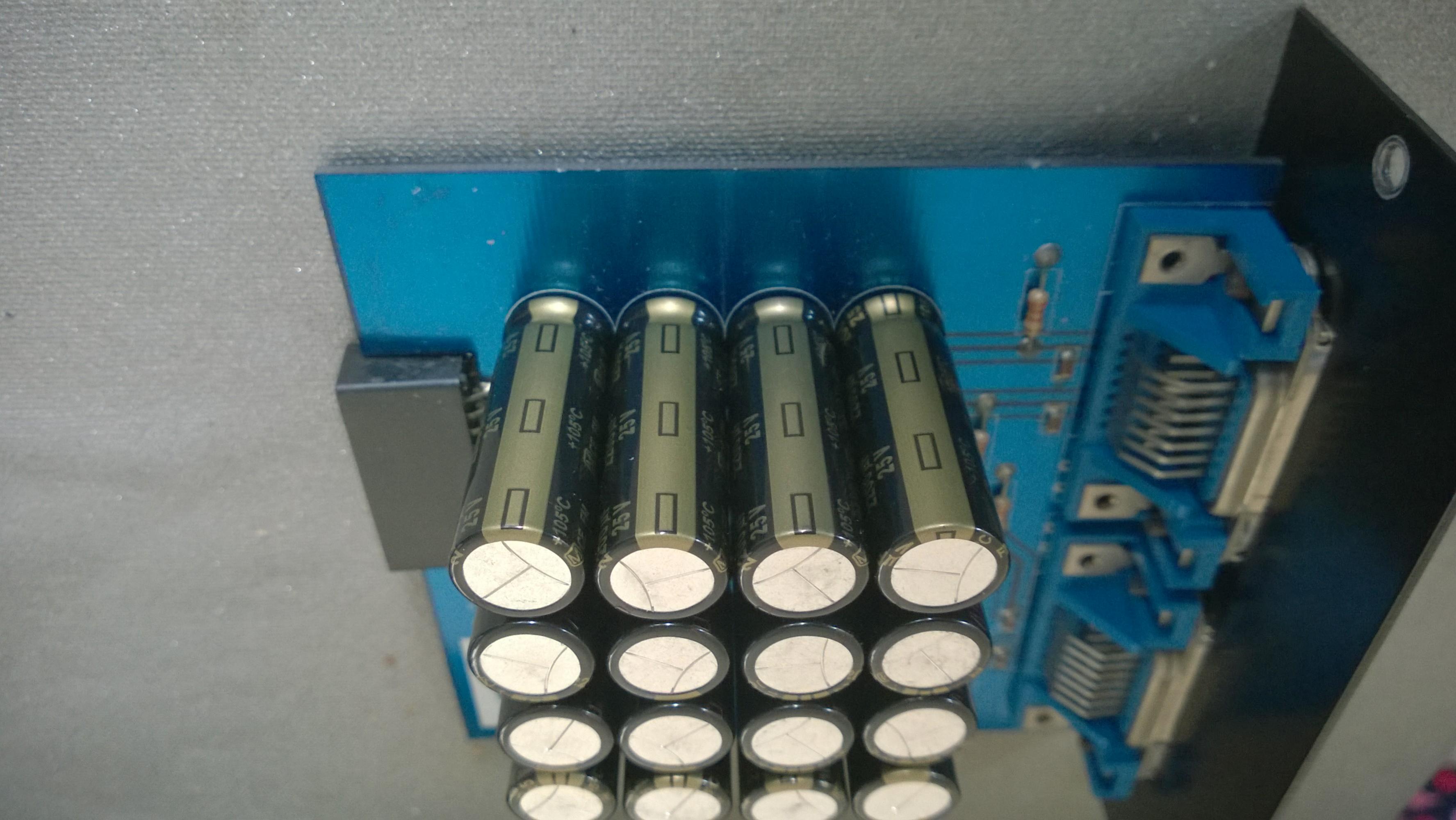

Replacement DaCapo board
I’ve bought 3 DaCapo DACs over the years - one was for the case (i couldn’t find a DC unit for love nor money so i made my own in a DaCapo case). The pcb was pretty rotten under the leaky power supply caps but the rest of it looks ok. If you were to bypass the power supply section you might be lucky enough to have a working DAC. I don’t want anything for it - just PM me with your address and I’ll send it out to you.

in September 2021, is the Pink Triangle Dacapo DAC, worth changing the 18 (?) 2200μF 25V electrolytic capacitors to replace the aging (duff!?) - LXF Nippon Chem-Con.
(and is it worth doing this before power-up!) or quick check inside to visibly check no leackage or buldging caps!?

Take lid off first and take some pics of inside.
The caps don’t have to be bulging or show signs to have leaked, they all do…
