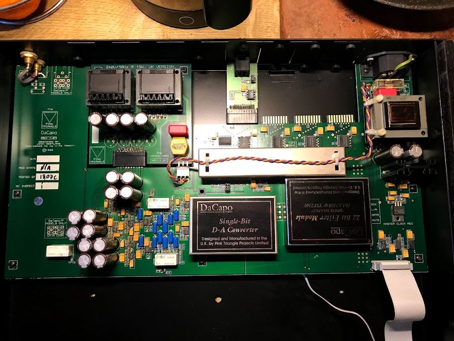

Yes take some internal pictures - we can then tell the condition of the PCB + what digital filter is fitted, HDCD or 22Bit are by far the best, I dont like the others...[/QUOTE]

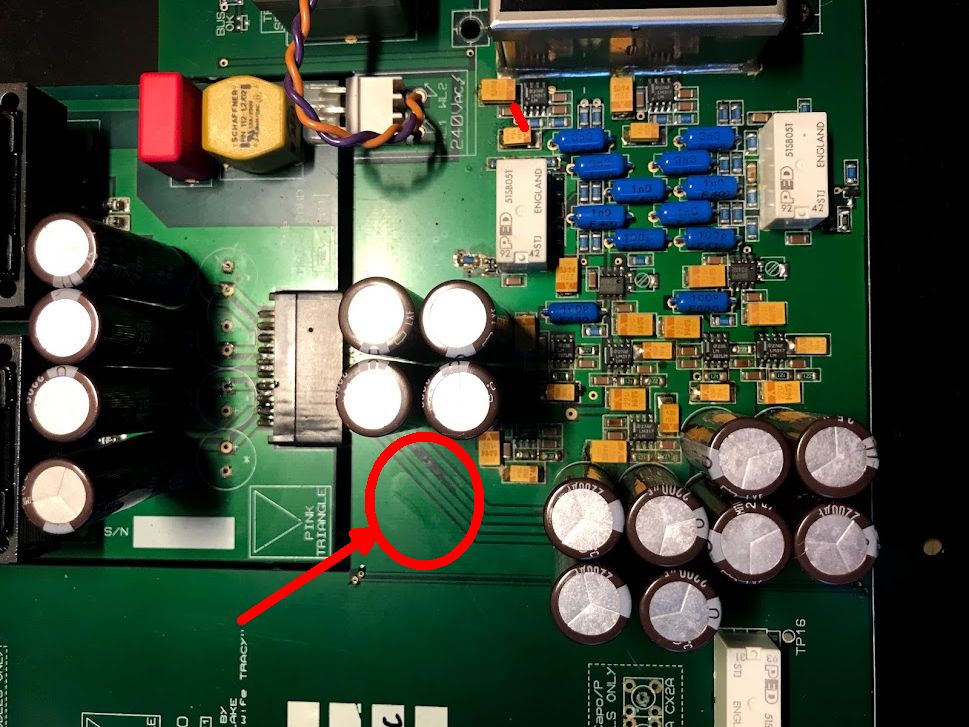

Okay at long last, and it's been a very long time, it's eventually in my hands!

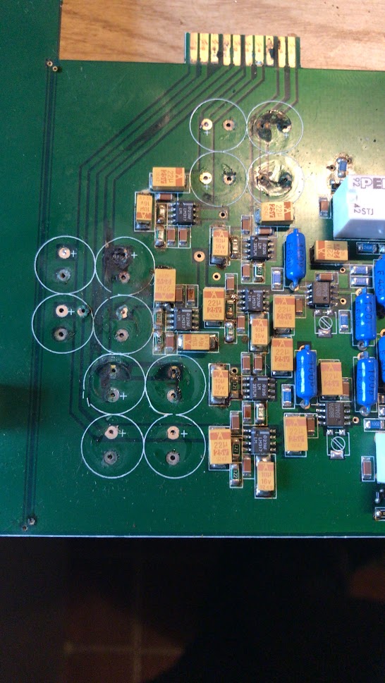

and here are the pictures before I remove the caps, the caps do look original, and I suspect there maybe some damage as I've not seen this on any other photos of PCBs, until I remove all the duff caps, it's not clear how extensive the damage is.

What is the brand and type? Typical Chinese throw away quality? Replace without thinking. Good quality stuff but old and has had heat? Replace without thinking. Device famous for cap failure? Replace without thinking.
Clean the board with isopropyl alcohol, put a wire on that PCB track. Pana FC, always OK ....
Yes, will remove all caps, clean the board, and replace.
Rubycon seem popular in this thread.
It is not so much about the brand but about the series... Peugeot 106 was an excellent car while the more expensive 306 is nowhere to be seen on the roads anymore.
And psssst... don't tell this to anyone but eh... some of the series eh... are sold under various brand and series names.
You can use a Dremel with very small brush to remove the corrosion of the solder pads. They are plated through so please use one of those wooden toothpicks and turn a few times with IPA in the holes. Measure for continuity as sometimes corrosion makes the upper and bottom PCB track isolated! Pre-tin the now corrosion free pads at both sides while keeping a stainless steel pin in the hole (solder does not stick to that). Clean the board thoroughly to stop the process. Wear a mask!
