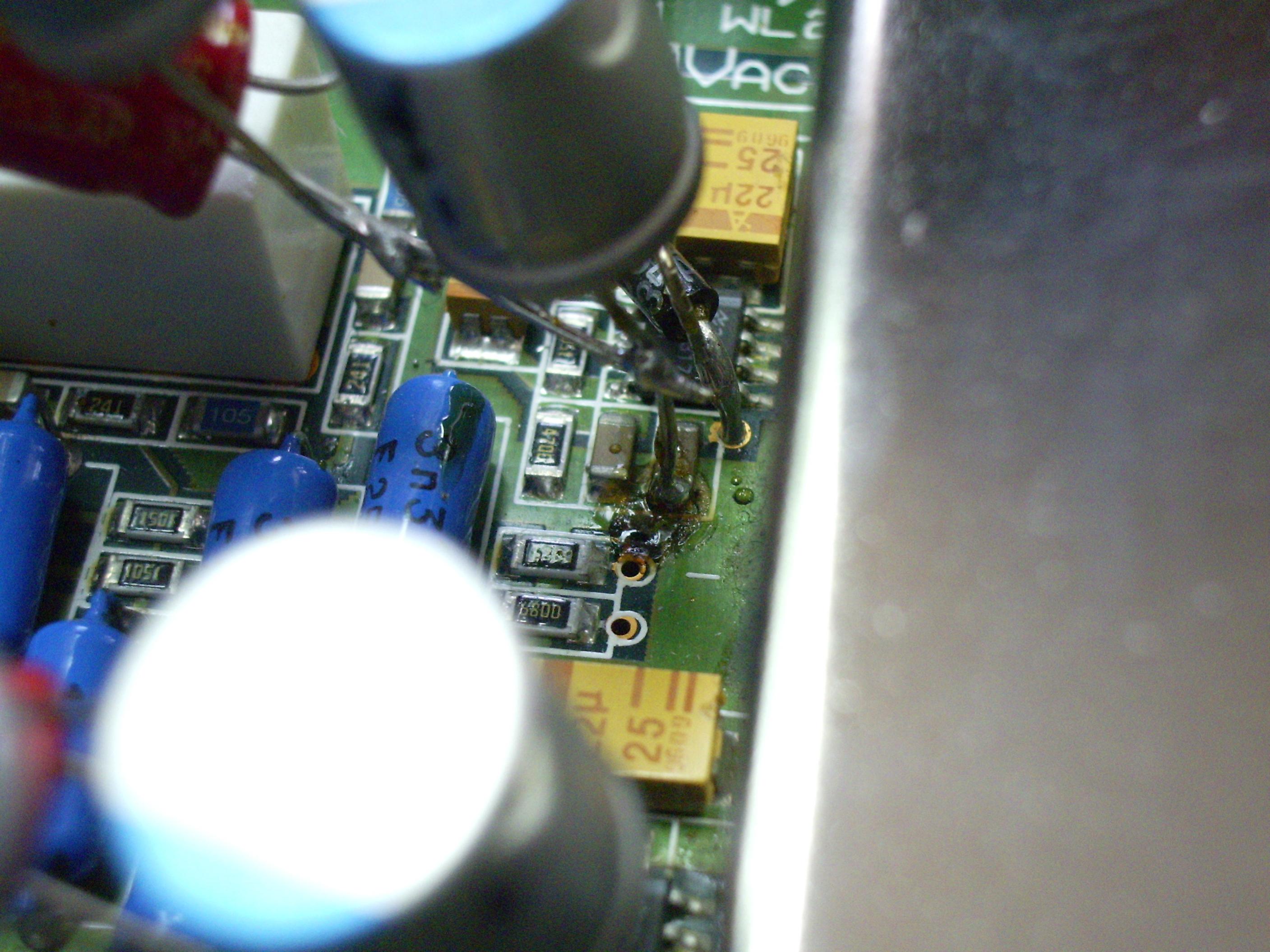

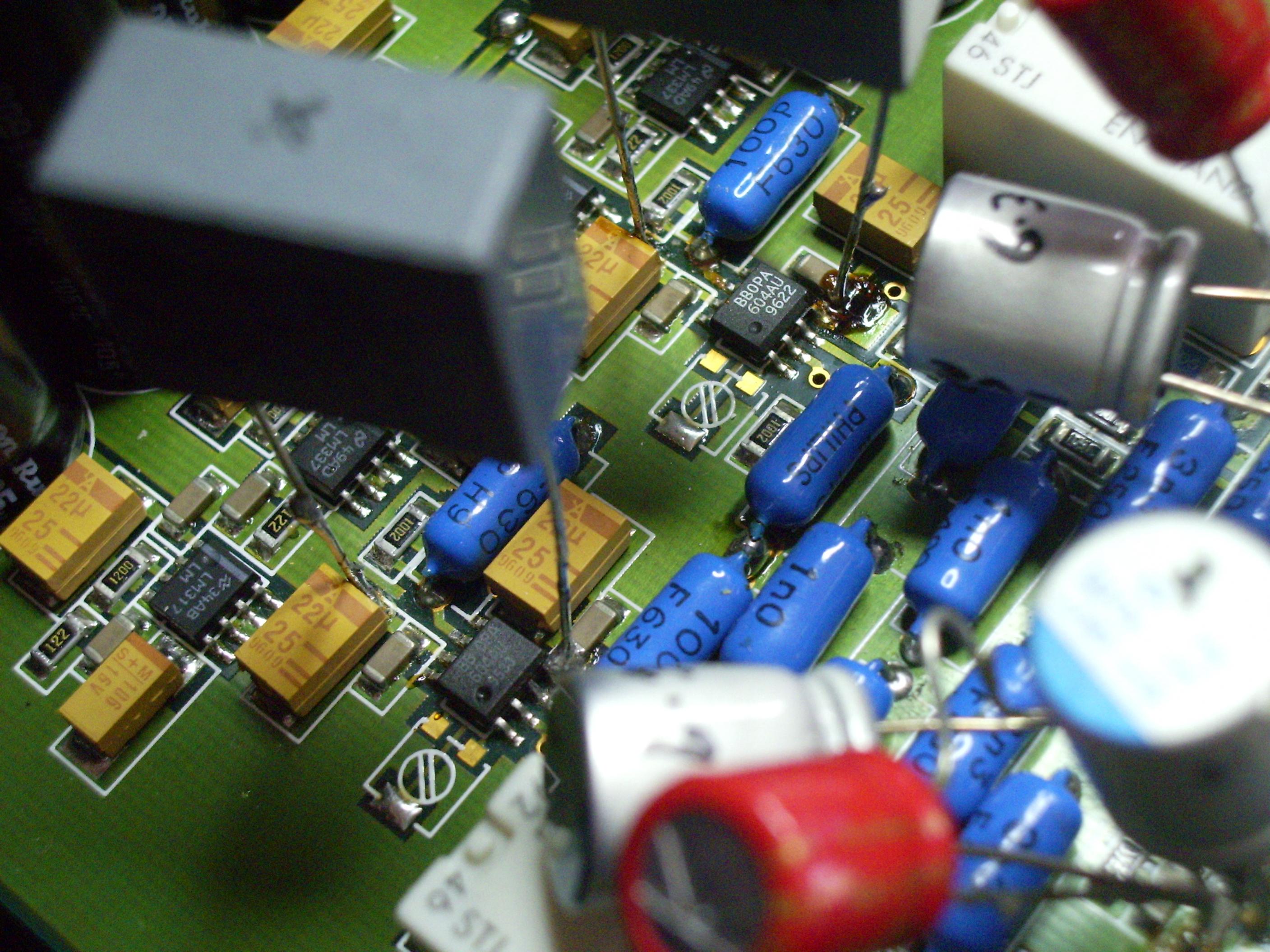

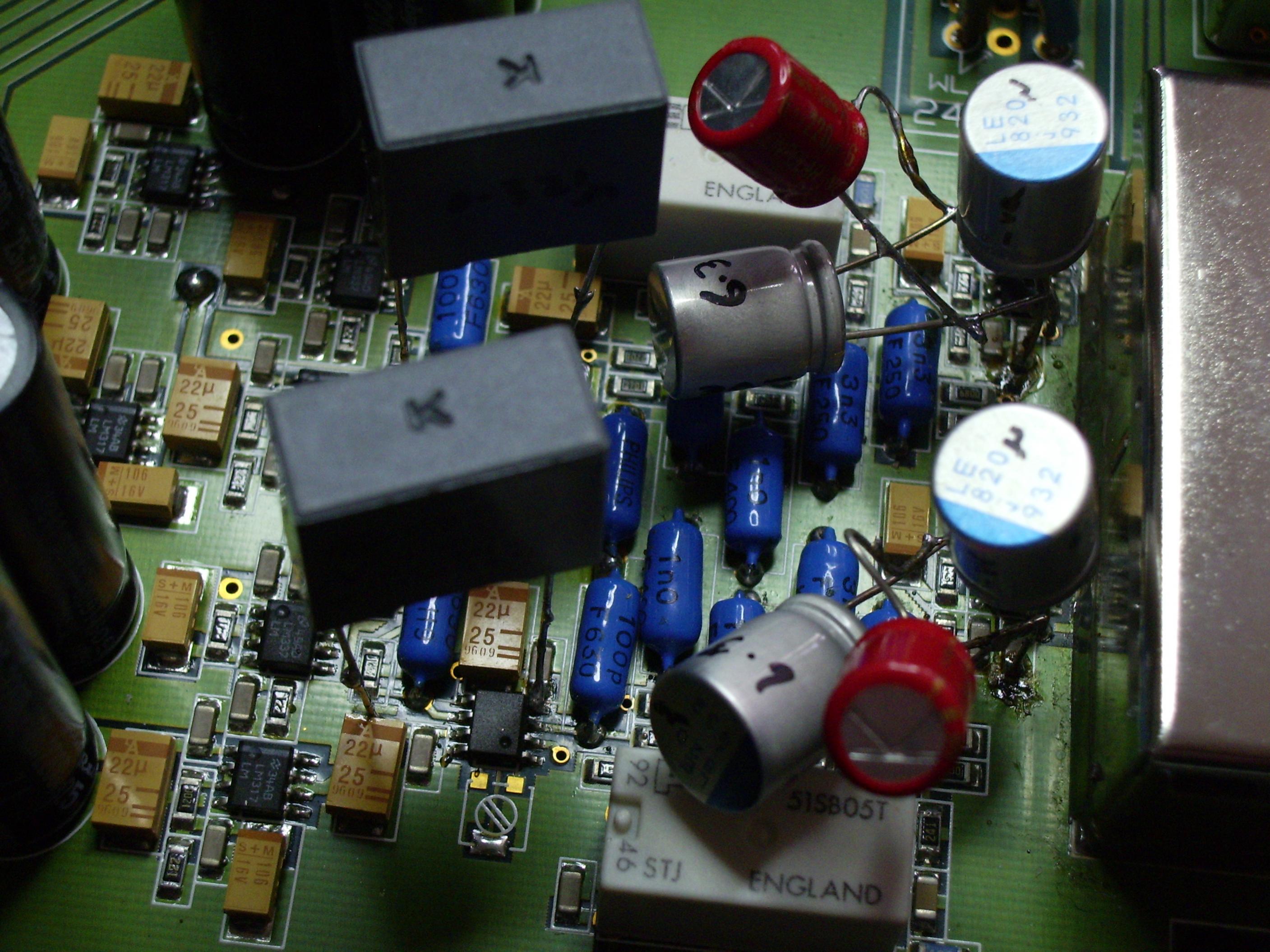

OPA604 op-amp for each channel on the one I worked on. There is no resistor after the op-amps, they go straight out the back, so that that into account when chip rolling. Also, to miss out all the copper track and terrible sounding RCA sockets, it's worth direct wiring from the op-amps either to new RCA sockets, or direct out of the box to your pre-amp input. There are muting relays that short the signal to earth, I left those tracked to the op-amps.

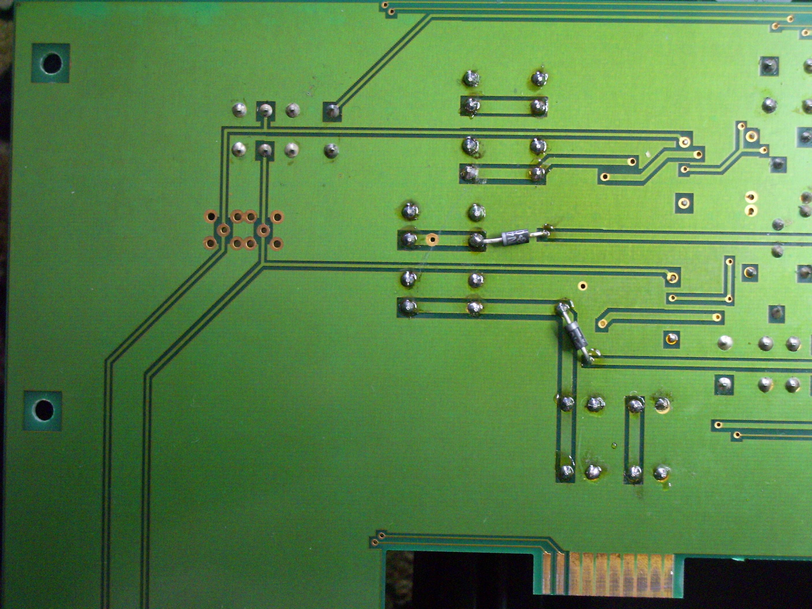

I added back diodes across the regulators and a bank of caps on the +5V's just before the DAC can. Comprised of 2 x 820uF Nichicon polymer and a 220uF Black Gate N, all in parallel. One set for each channel. Made a LOT of difference. Clarity, dynamics, bass.
Also added 4 large Polymers across the analogue stage supply's normal El.caps just after the diode bridges where there were spaces on the board. Also on the digital supplies. All were worth doing.

I looked back through here as I though I'd posted some photos of the output stage mod's I did but I only found this one, post 504: http://www.diyaudio.com/forums/digital-line-level/70107-da-capo-issue-john-w-11.html
Plus a couple of the 24 bit filter board.
There's quite a bit about modifications around page 10 (about post 471 or so).
