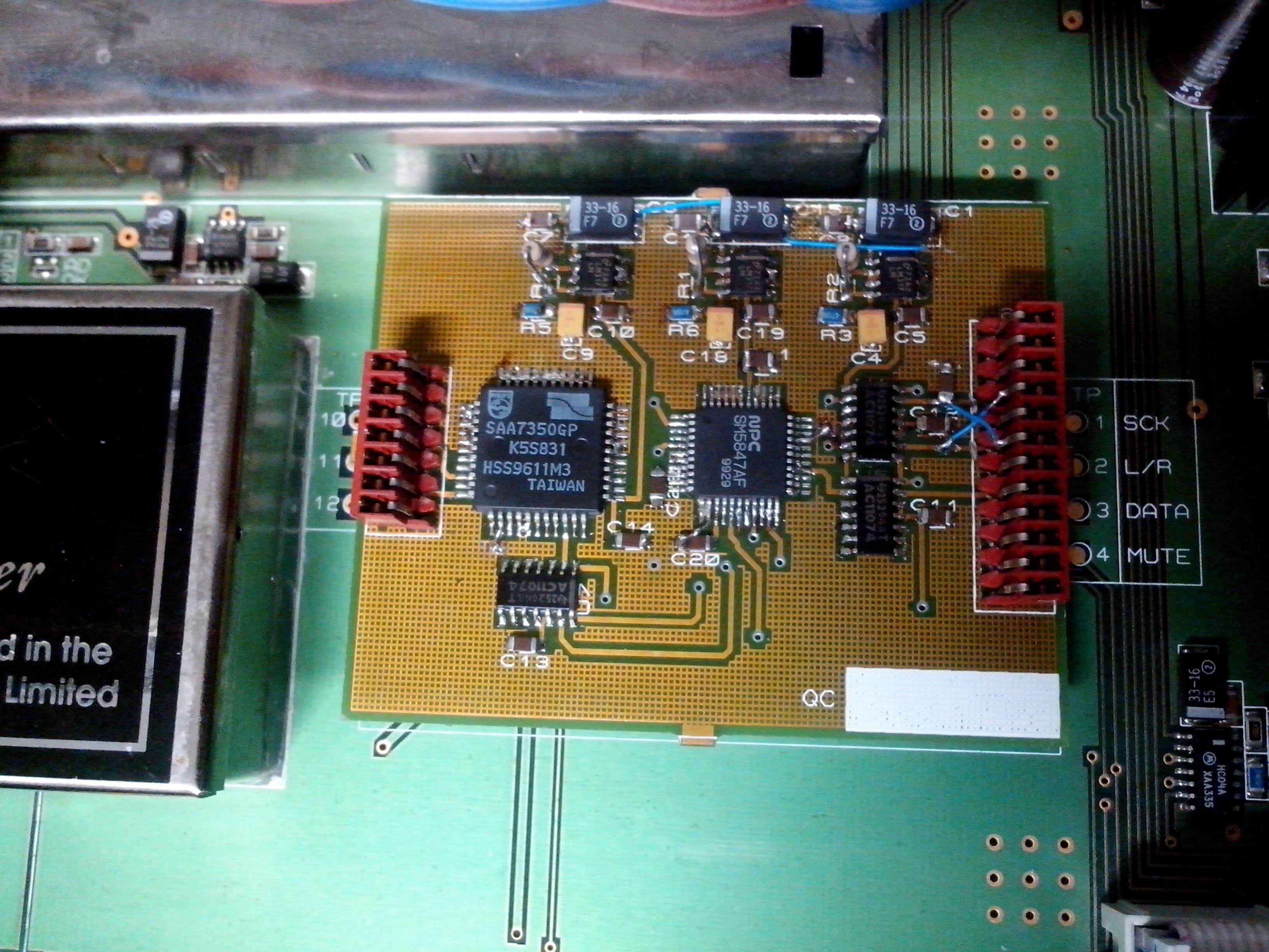

John I was wondering if you came to any conclusion about the pink noise from the da-capo DAC from the post on the forum middle of last year.
I also have a Da-Capo which creates the same pink/white noise sound, with a hint of the music behind it, after a period of being powered up (doesn't seem to make a difference if it is in standby or not, just the power being plugged in).
The DAC has the HDCD filter fitted (so isn't the 1307 filter issue that you mentioned).
I have tried re-seating the filter module and moving the Input card to a different slot. Neither have made any difference.
Funnily enough about 4 – 5 months ago a Da-Capo came up for sale that must have been one of your development ones. The serial was no 1 and it had a dedication to your wife actully on the circuit board. If I had seen your name on these forums before now I would have let you know as it sold for silly low money…
Lastly I wondered if by any chance anyone might have a copy of the original Da-Capo instruction manual at all? I would really appreciate a photocopy of it (been trying to get one for ages), I am also looking for a Cardinal instruction manual as well…
Does anyone know the dip switch settings for the HDCD filter (or will I only get intelligible sound if I have used the correct setting)

I did some work to one with hiss and it seemed to not be a problem once I'd changed the various electrolytic capacitors in there, most of which were leaking. Plus I added some better ones, namely the Nichicon conductive polymer type, which did improve the sound.
There were still some hiss/noise problems as you describe, but it almost seemed as if it could be that the pins or sockets for the filter canister were not clean enough / tarnished.
When working well, it will hiss for the first ½ a second or so from switch on, then 'lock' on and the hiss stops. A different filter, the HDCD, was tried and there were random hiss problems with it. So I wondered if it was that the noise was about something not locking onto some clock signal due to tarnished contacts to / from the filter.
Hi IanAs And thanks for your reply, i have to say you that all caps are already replaced and i have looking for if there were corroded tracks but could not find anything.I have a oscilloscope,but i have'nt electric diagram so i can't check waveforms as SCK , L/R ,DATA ,please see picture attached.
I tried to compare them with those of my Philips CD 650 that has a TDA1541 (pin 1.2.3)and the signals were not equal but attenuated and distorted and dirty.
I also tried changing input slot but nothing resolved.
Now I'm almost discouraged!
It would be interesting to have the references of the waveforms and/or voltage of the test points on the PCB.

Hi, I had had similar problem as you have. My case was white noise, cricking noise, distortion on the sound and sound level difference right and left. I wander how do you connect the output of Dacapo to the AMP. I assume the D might be very sensitive to the very small current from outside. I make numbers of pre-AMPs using Valves. The recent development is using 70 times lower signals from D for reducing the distortion for overall pre-AMP. So, far D has been working happily with it.
The configuration of the mother board and DIP is as follows;
1 – 2 >> Open, 2 – 3 >> Close. DIP: 1 >> Right, 2 >> Left, 3 >> Right, 4>> Left.
I recommend the Audio lab M-DAC for the replacement of D, setting the audio level to 0 dB and the filter to Transient XD. If you buy it, you need to burn it at least one week. Do not criticise the initial sound you hear. I have not done yet the close comparison between M and D. However, I feel D with HDCD is slightly better. I hope my comments will help you someway.
Regards, Tammy

Hi, Further to my article yesterday, I would like to inform of the new development. Up to Yesterday my D had been working perfectly. However, I noticed today it has been dead. From this result I believe my suspecting was wrong. I have started to use M-Dac again. On the other hand, I have noticed I need to change some electrical parameter in my development for this change. Perhaps the sound resolution will be changed as well.
All DC powers of D are OK, but when the mains power is on, HDCD and Stand By indicators are on and 1-2second later HDCD indicator is going off and it never come back again. Also I have noticed all signal relays do not energized. If anybody comes close to the solution, please let me know.
Regards, Tammy
Regards, Tammy
