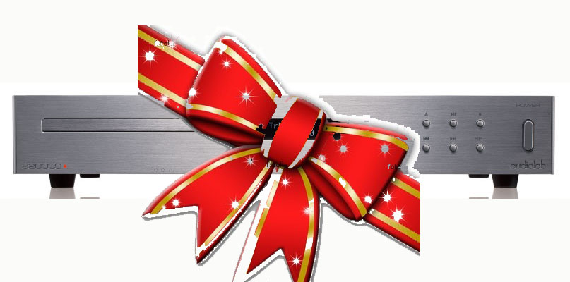

Did you buy something better?
At risk of shooting myself in the foot.. yes.... Mr Westlake's Audiolab 8200CDQ. I recommend you go and listen to one. Don't tell anyone though!

I'm also bought one today! It's too early to tell someting about sound, just want to say that in my 8200CDQ there are two additional digital filters ( 7 totally ): "Optimal Transient XD" and "Optimal Transient DD". They are not mentioned in manual, so I'm wondering what is the benefit?
I'll make comparison between Audiolab 8000CD MKII + Linn AV5103 preamp against Audiolab 8200CDQ later on. I'm also have two headphone amps to compare. Ah! I also have external DAC on Sabre ES9008 ( not 9018 as in the CDQ )

Well, you know what? Don't be fooled by first three-four days from buying new of Audiolab 8200CDQ. Just don't swith it off. This is the brilliant apparatus!!!
My system now: The Audiolab 8200CDQ + Genelec HT208B in cherry ( active ) = amazing!
