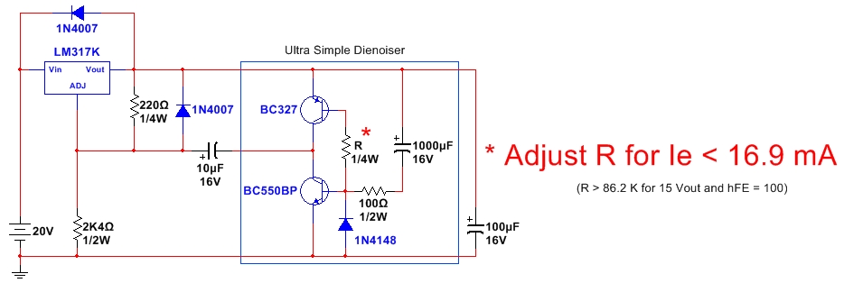

The Ultra Simple Dienoiser allows great flexibility in the choice of R and C, without appreciable detriment to its performance.
A small advantage can be perceived between 2KHz and 20KHz, relative to denoiser, with a simpler and cleaner spectral content.
The difference that could show between a lower value of C (100 to 220 uF) and a significantly higher one (like 1000 uF) could be seen in the transient state. A lower value of C yields greater oscillation amplitudes, but in less time. A higher value of C yields lower oscillation amplitudes, but in a longer time.
I didn't see it specified, ¿what value of Cadj. have you used for the Ultra Simple Dienoiser? ¿10 uF or 220 uF?

I used 10uF. I didn't test LM337 as I have to switch the polarity of too many parts on the diy supply. I will test it once I gather more things to test LM337 with. But by my guess it should work no issues, especially with the 20nF comp. LM337 needed a low ESR output cap with the normal dienoiser, just like LT1084. Once I used a low ESR output cap I could get them to work with the normal dienoiser, so I figure the LM337 will surely work with the USD.

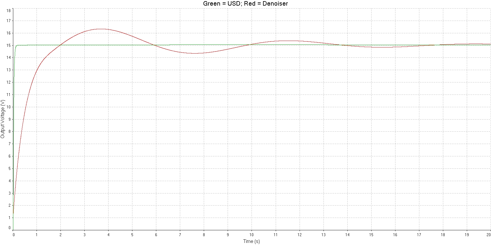

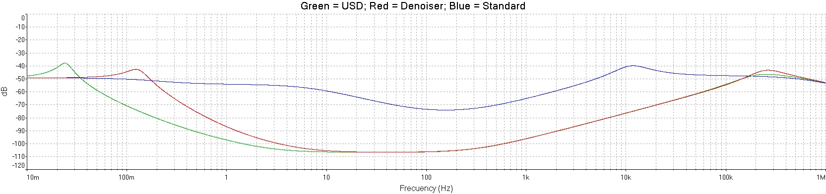

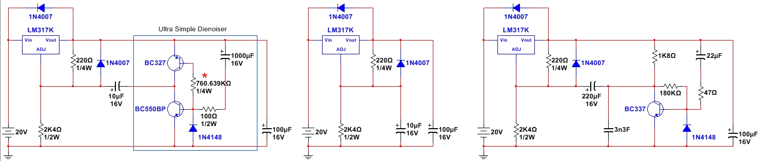

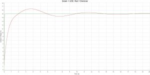

Complementing the measurements that Trilero kindly carries out, I upload a comparison between a normal LM317 scheme suggested by the manufacturer, the Denoiser and the USD. These last two, operating at a similar collector current (5,785 mA approx.).
As you can see, both the Denoiser and the USD show similar PSRR vs. frequency (in audible range). There could be a slight advantage in favor of the USD of between 3 to 4 dB outside the audible range (265 KHz, according to simulations), although at that frequency it has not been verified yet, it is possible to verify a small difference between 2KHz to 20 KHz in Trileru measurements (giving as probable what the simulation predicts at 265 KHz). In any case, it would be necessary to check under which collector current regime both configurations were operating, since they should be compared at a similar regime.
What is visibly different is the transitory response, a situation that in the Denoiser is not the most favorable. The USD presents a much more immediate response on the first connection.

The value of R in the comparison was 760 K approx, to allow a similar value of collector current (both in the Denoiser and in the USD). It is obvious that a standardized value was not sought, but only to make the comparison.
Depending on the output voltage of the regulator, the characteristics of the signal transistors used and the collector current, it will be the corresponding value of R.
To make it fairly universal, a 50K trimpot (up to 6V) could be used instead R; 100K (between 6V and 9V); 200K (between 9V and 12V); 500K (between 12V and 19.5V); 1M (between 19.5V and 28.5V) and 2M (between 28.5V and 37V).
Best regards
It's not clear what value is that resistor between both transistors bases.
Can you specify?
You hit the nail on the head: it has to have the very exact value required to keep both transistors in linear mode.
Both behave as CCS's, and tiny differences in Ic will result in one of the transistors being saturated.
If the transistors have a very similar HFe, and a lowish Vaf, they might find an equilibrium, but it will be hairy, and the resistor value will serve as a fine-tune tweaking.
Without feedback, the DC conditions will be very unstable, and the circuit will be unusable in practice.
It's OK to speculate in sim, but I do not recommend using it without further stabilization measures
