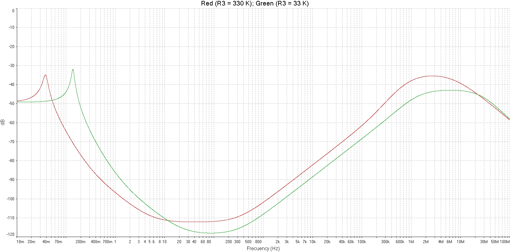

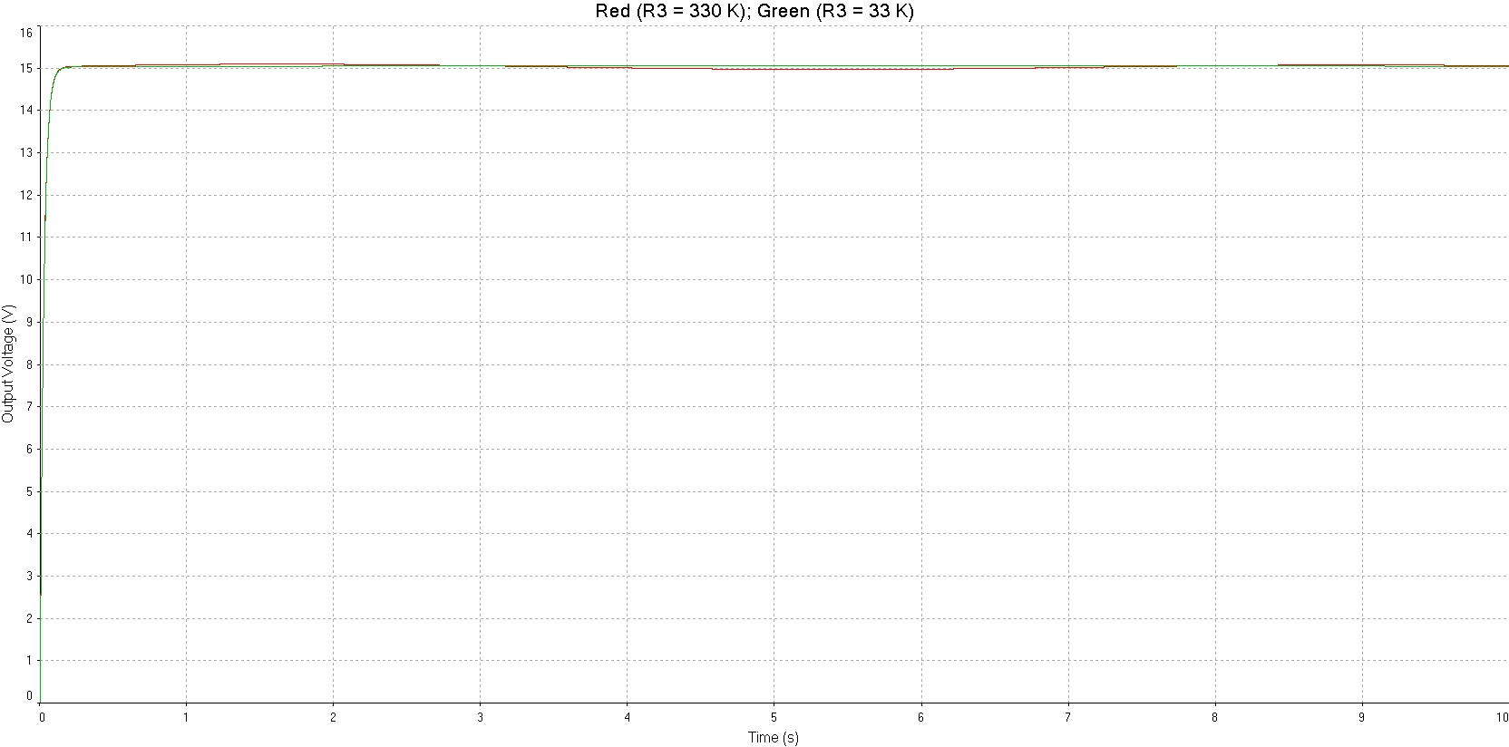

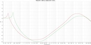

To see the flexibility of the Ultra Simple Dienoiser, I will vary R3 in a decade.
attachment.php
attachment.php
It only remains to know if it requires any compensation, which I do not think is necessary.
Best regards

It is gratifying to confirm that your setup does not require compensation of any kind, even if it does not match the performance of the original dienoiser.
Have you been able to check if it improves the parameters in relation to the typical schemes suggested by the manufacturer (with Cadj and Cout)?
Most likely, the circuit behaves very flexible in terms of ranges of values for R3.
It is very interesting to note that the Ultra Simple Dienoiser has a much less complex spectral content than the original Dienoiser.
