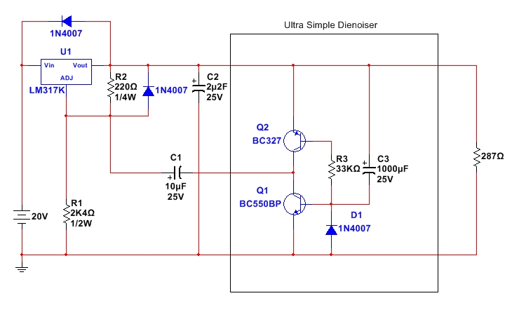

Although it is not a scheme that I like at all, the results are very attractive.

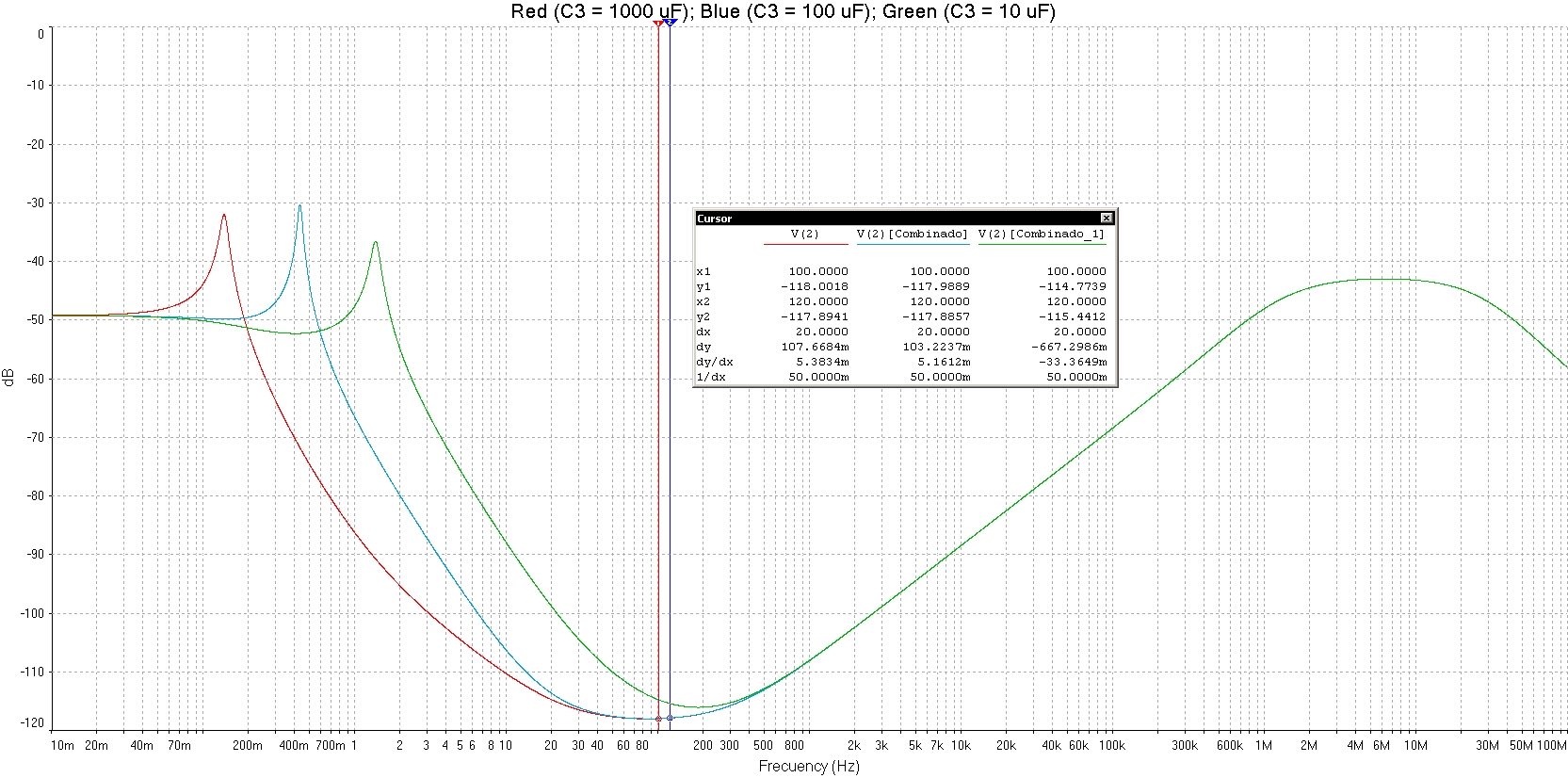

The transient state can be modeled more or less as we need, acting mainly on the value of C3.
The other two capacitors could be of a value closer to the typical ones suggested by the manufacturer, which would make their adaptation more universal.

It is evident that everything depends a lot on the real parameters of the signal transistors, such as the current that is going to be drained from the output.

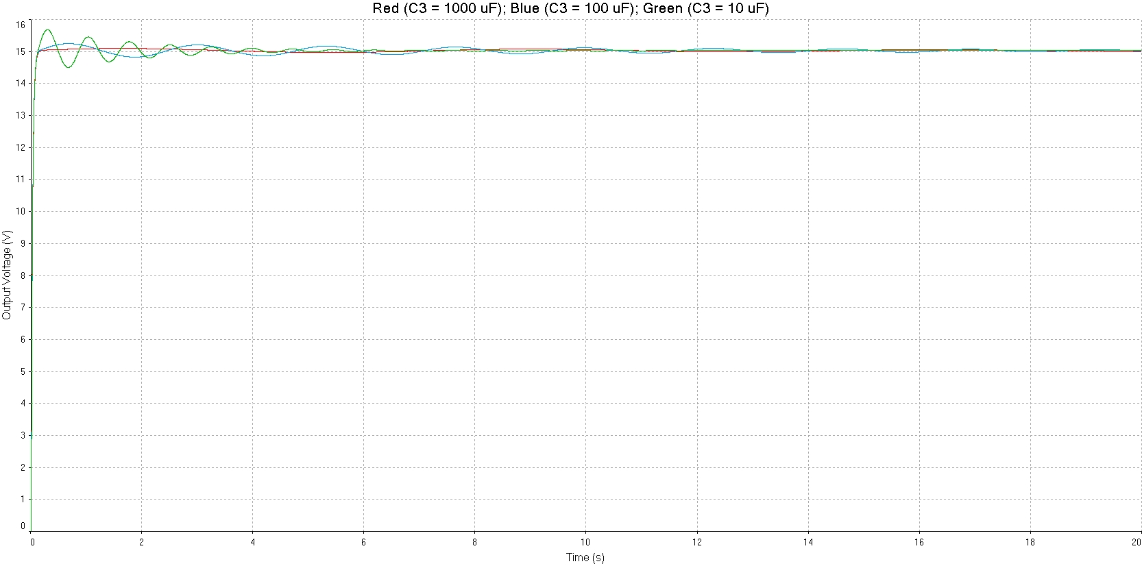

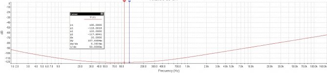

That looks really nice Diego. I tried 100uF for C3 and overall performance seems close enough to the original dienoiser.
There's a bit more over/undershoot but not by much. For the small part count I find it attractive. Think it will be stable without compensation?
Yes I see that there's around 110mA. Any particular transistors you would recommend?

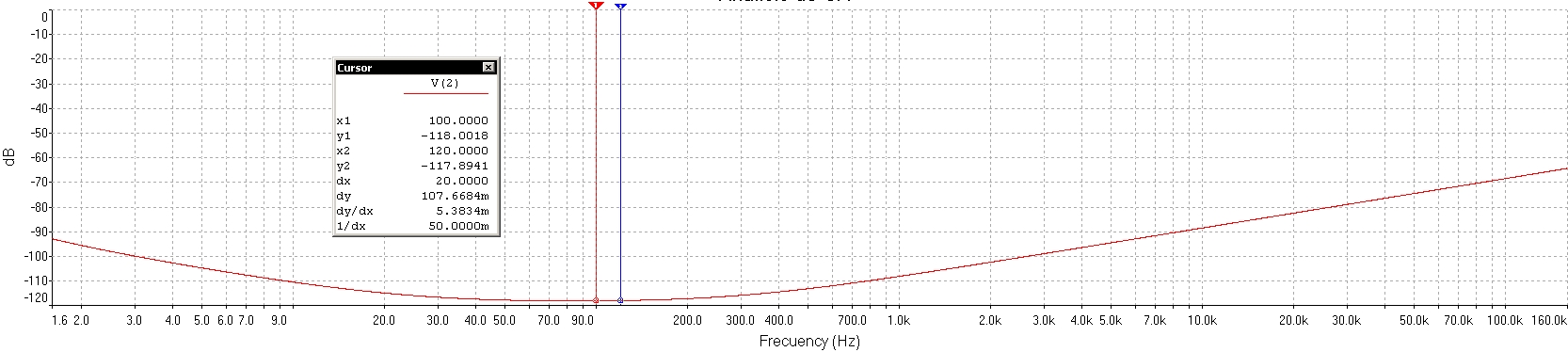

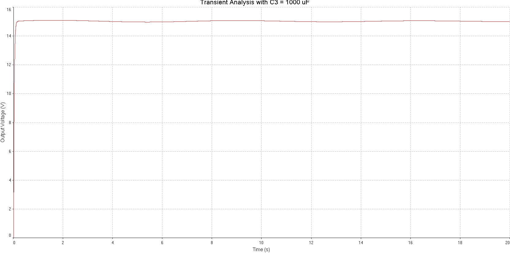

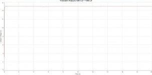

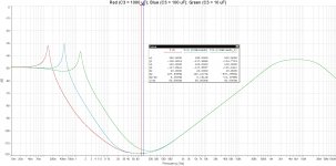

The red trace in the last attachment to #1685 appears to have an oscillation period of 7 seconds: troughs at 5 seconds and again at 12 seconds. That's a frequency of 0.14 Hz, which corresponds quite well to the red resonant peak in the first attachment to #1686.
With a ~ 20dB resonant peak, I bet you'll see many cycles of sinusoidal ringing if you apply a step function load current (from 10% of max, to 90% of max) and let the simulation run for 20 simulated seconds after the step.
The good news is, this resonant peak is plainly visible on the AC analysis plot, whose simulation runs very quickly. So you can try hundreds or even thousands of design modifications, to get rid of the peak. .STEP to your heart's content.

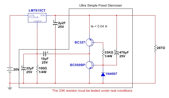

The circuit that I approached you is a first and rough approximation. Therefore, it will have to be polished at the same time as testing.
Anyway, I think it has potential.
Iq: it would be convenient if it were below 40 mA, although it will depend a lot on the transistors (we will have to play with R3).
I don't think this circuit can show instabilities.

Since C1 doesn't have a large voltage differential between the terminals it can be 0805. The only large component would be the 100uF cap, and for 16V rating it can be found in 1210 package. This thing can be crazy small at 16mm x 8mm. That's single sided and could be diy. I think it can be made even smaller if I put the parts on both sides.
Unlike a fixed resistor, Q2 behaves like a dynamically variable load for Q1.
This configuration seems to allow a somewhat more independent adjustment of the parameters of interest.

Wow. Surprisingly fast, neat, and small.
I hope that it will work very well.
Many thanks for your beautiful work!!!.

This is just testing to see how small it can be without the 100uF being expensive.
I'm trying a diy version, am really curious if it works. Since I already have the diy lm317 supply with the original dienoiser I can also make comparisons on lm317/lt1084/lm338. If I have time maybe I also test the lm7812.

The biasing of Q1 and Q2 is terrible, the base current is known, then, the collector current depends of the transistor current gains which is notoriously non accurate.Unlike a fixed resistor, Q2 behaves like a dynamically variable load for Q1.
In any case, I would like to be very cautious in forwarding observations, since it would have to be tested.
Best regards
Q2 as a dynamic load is obscure and about unpredictable.

I haven't made detailed measurements on the dienoiser, but the nonoiser and dienoiser look relatively similar from a performance perspective, and the total wideband noise (10Hz to 10kHz) of a ZTX-fitted nonoiser has been measured at 90nV. I don't think that a naked, modern reg can better that (but you can show me wrong)
I prefer your original dienoiser version: it is certainly more deterministic, and I think that in practice, some compensation would be required to make your newer incarnation acceptably stable. It needs to be tested.Although it is not a scheme that I like at all, the results are very attractive.
