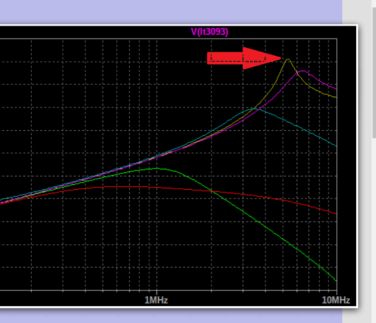

If the Texas Instruments spice model is to be trusted, it looks like TPS72301 might be a winner. It's about double the price of LM337, is SOT-23-5 package, and is a 200mA rated device. For the last boards I made it can easily be added, as a footprint, on top of the SOT-223 one for LM337.
Here's a comparison with the other negative regulators I simulated:
And it seems pretty well paired with the LT3080:
Output impedance is similarly linear:
I'll look at others but at the moment this seems like a really good fit for the low power supply. And it's cheap (ish). Hope the spice model is accurate.
I'll look at other positive low power regulators, maybe I find something cheaper than LT3080 but even so it's not that expensive.

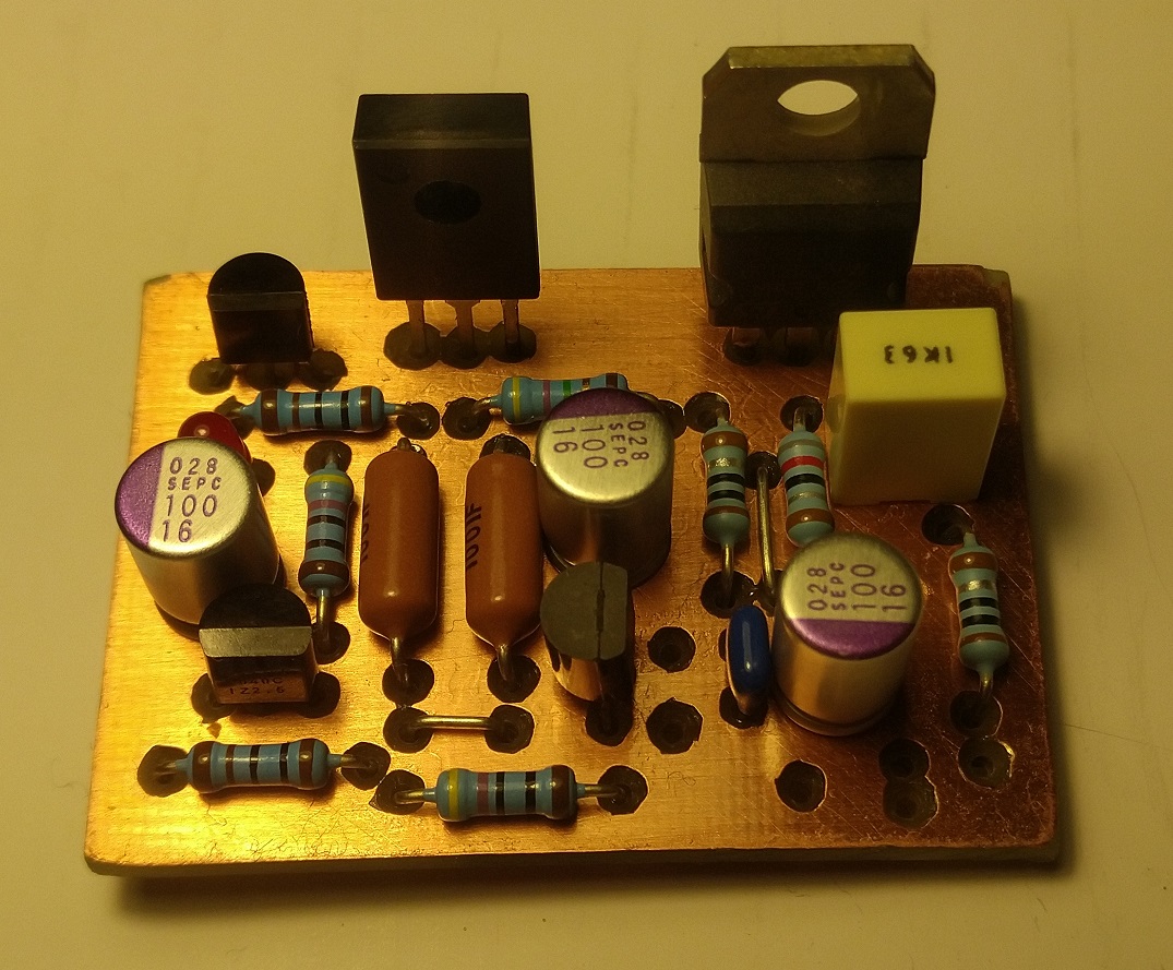

I installed LT1085+dienoiser for the +12V rail in the DAC, and also a cascaded LT1085+dienoiser for +5V Vref/VACC. A bit tricky, needs a very low ESR output cap, and some compensation, but it works great.

I’ve been doing my DACs for years and I’ve thrown out serial regulators around the most essential digital chips.
The picture shows the 5V regulator for the PMD100 filter, it is a WJ shunt regulator with small modifications.
What would be the benefits vs the LT1085+dienoiser?
This is the physical implementation size-wise, LT1085 was installed later instead of the ams1117 to the upper right:

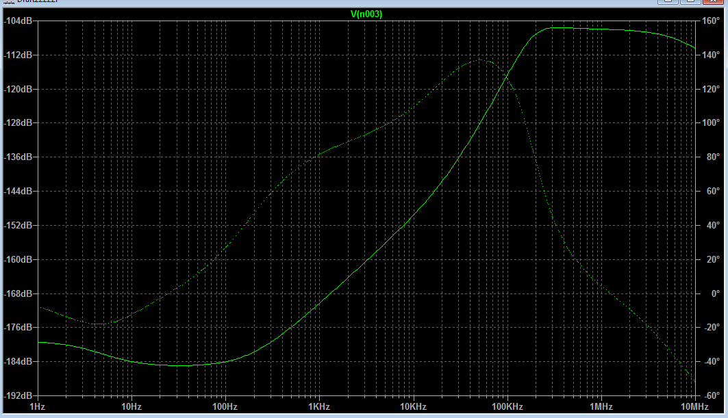

This is PSRR of LT1085+dienoiser:
And this is the output impedance (I guess LT3080 is even more linear):
This mod made the most difference in how the DAC sounds, and it was by alot. I usually don't notice small changes. This one was clear as day.

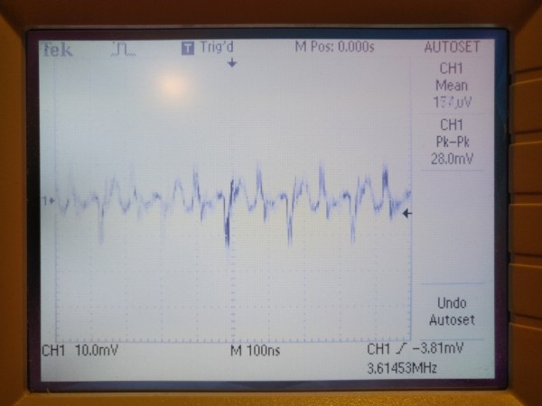

I tested recently in the same environment WJ shunt reg and expensive ADM7150, shunt proved to be far better precisely because of its lower impedance than ADM7150 or any other serial regulator. By the way, I consider ADM7150 to be the best serial regulator for digital.
I didn't simulate impedance, but for me the area in the MHz band is always important when it comes to digital, for analog signals it's a different story.
I am only considering the analog part with this. For sure there's better solutions for digital.
Getting back to my simulations, I tried some more positive regs that would be compatible. So far I like LT3080/LT3082/LT3088 series. They are very similar yet slightly different.
The LT3082 is a 200mA part and cheapest of all three. Fits great for the low current power supply. But it's 1.3V drop.
LT3080 is middle priced but is a 1.1A part and 0.35V drop.
LT3088 is the most expensive, is a 800mA part and 1.35V drop.
LT3080/LT3082 need a 1.2Meg output voltage setting resistor for 12Vout while the LT3088 needs 240K for 12Vout.
LT3082 is 3€, LT3080 is 3.6€ LT3088 is 4.1€.
The real toss is between the first two, as the latter has the best performance as output impedance. Between 20Hz and 30KHz it never goes above 1uOhm, and most of it below 0.5uOhm.
Self noise is almost identical between the three, but for PSRR the LT3080 is slightly worse then the other two:
All three have the same pinout and can be gotten in sot223 package.
