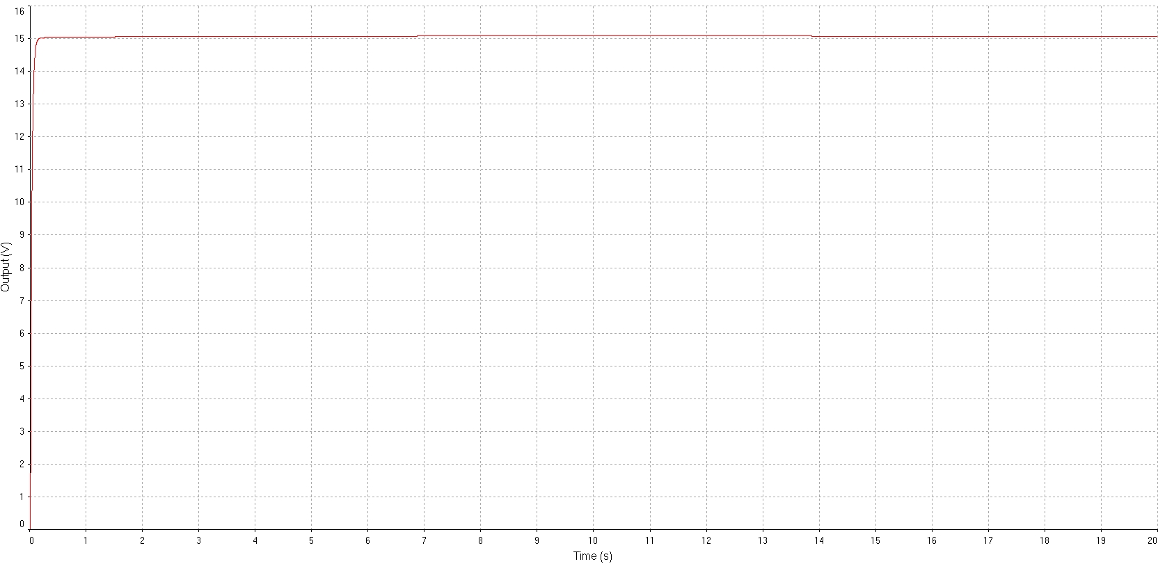

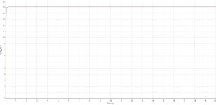

In the datasheet there's this for the SET pin absolute maximum ratings:
SET Pin Voltage (Relative to OUT, Note 6) ...............±10V
And note 6 says:
"Note 6: Diodes with series 1k resistors clamp the SET pin to the OUT pin. These diodes and resistors only carry current under transient overloads."
Could this be an issue or maybe the model does not contain the said diode?
This is the SET pin probed:
In this case, it doesn't matter too much: you just want to ping the regulator with some kind of stimulus to see how it reacts, and there is no risk of frying something in the sim universe

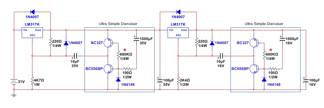

Would you please post your last dual lm 317 /337 dienoiser + cap multiplier schematic with a better resolution
I really like simulation results and would like to try
Is It sure that lm337 + dienoiser Is stable and does not oscilate

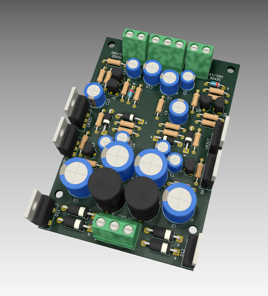

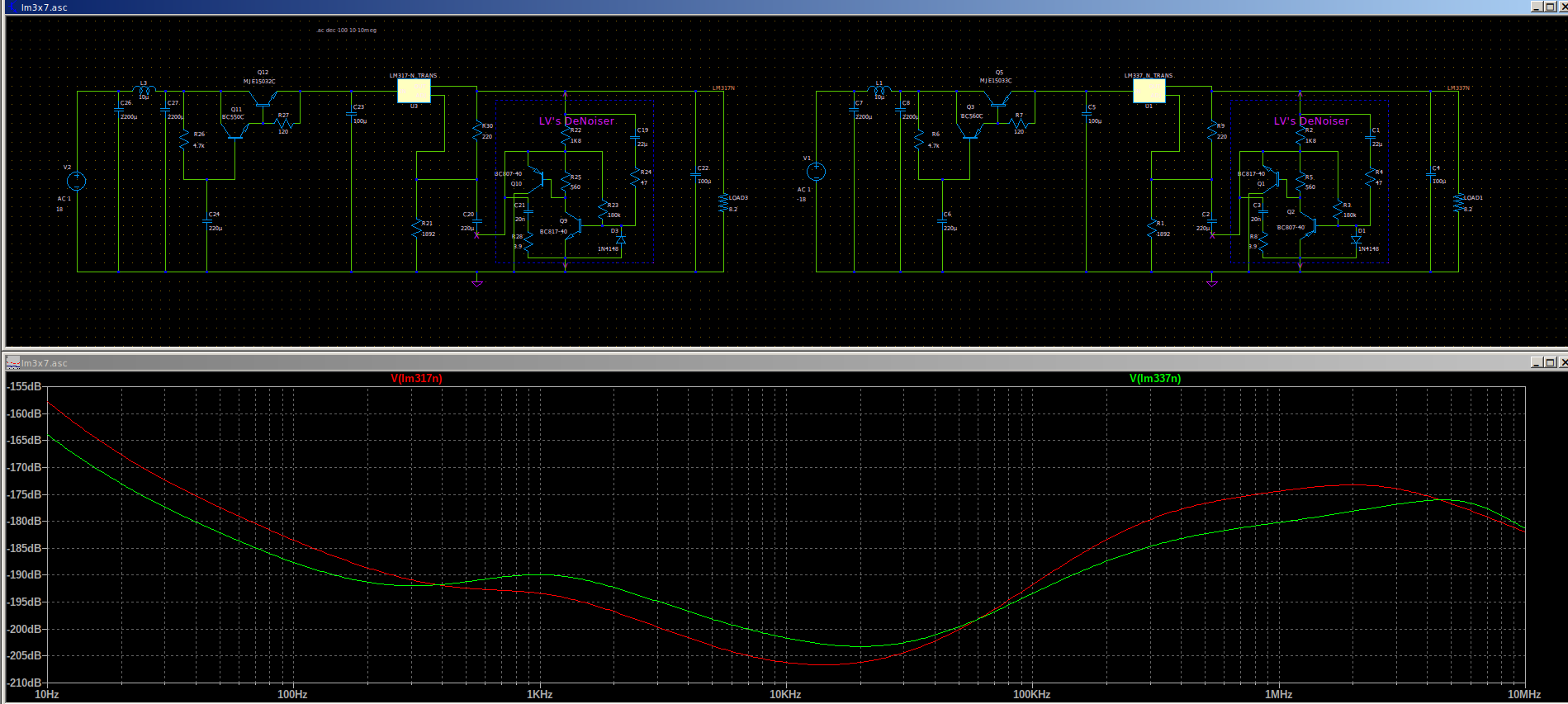

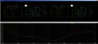

The pcb schematic is included in the Kicad project. I attached the simulation file if you were referring to it, but you need to add the LM3x7N models from TI in your LTSpice library.
I managed to get a stable dienoiser on one earlier DIY power supply board and also in the headamp where I used an add-on board. LM337 +dienoiser needs a low esr output cap (under 0.05ohms) and some compensation (depends on layout, 30-40nF). This latest diy board could be used with the denoiser option, just install a 0ohm resistor instead of the dienoiser resistor. Until I get a chance of testing it and finding the correct Ccomp/Rcomp so both LM3x7 dienoisers are stable.

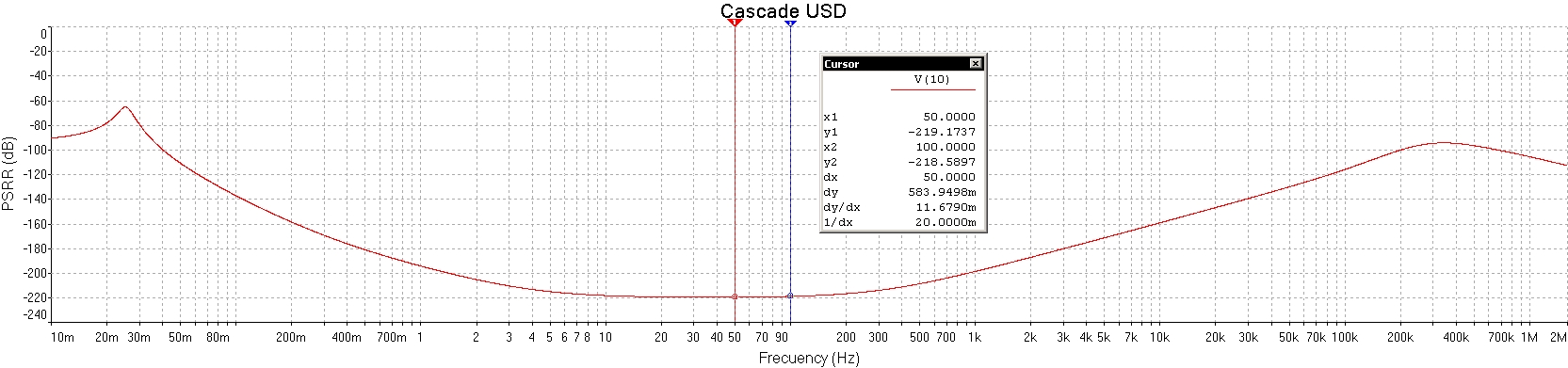

Also a small correction on that simulation. To get accurate self noise reduction by the denoiser the correct connections should be as in the right version in the photo, the left is not correct.
I made the same update to the single LM317 supply. Theoretically it could be used with a LT3082 as well as I added a 0805 footprint for the 2.2uF coupling cap to de/dienoiser. Has two 6.3mm smd output cap footprints as well as 1210 over them, so you can achieve low ESR for LT3082. You don't install the protection diodes for LT3082, only for LM317. Fab house and diy versions with gerbers and pdf. Fab house version has cooling planes on the back, and the same as before the DIY version has a gnd pad (from voltage setting resistor) that you have to link to the gnd trace with a piece of wire. Boards size is around 62mm x 28mm.
This board has not been tested yet so you make it at your own risk. Kicad projects attached.

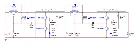

Not I.
The bias of the two transistors does not make sense. I already told you, sorry, you do not want to understand

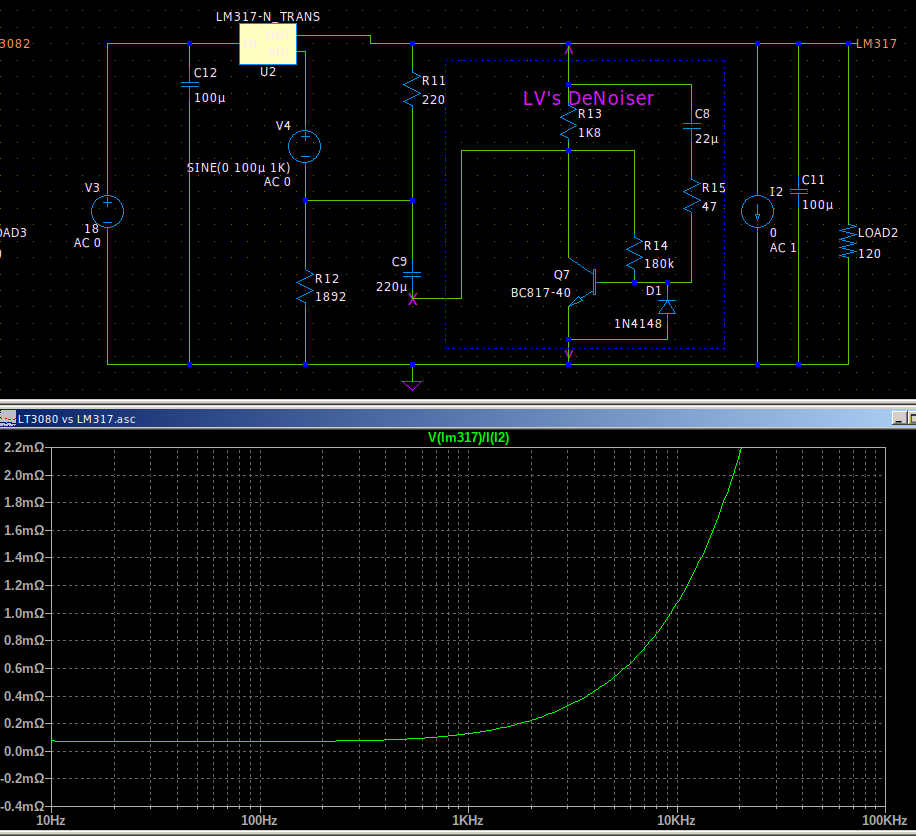

Also the denoiser (not dienoiser) already has a lower output impedance than the output caps have, even at 20KHz. I think you only have to use something to have the regulator stable, but I don't see the need for a large value. Is there anything I'm missing?
I attached the output impedance for LM317N + denoiser. Output cap has 470mOhm(resistor)+44mOhm(cap) in your case while the regulator has around 2mOhm (edit: at 20KHz. around 25mOhm at 5MHz) .

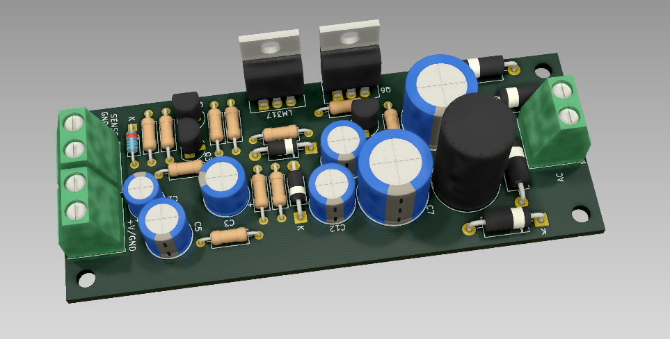

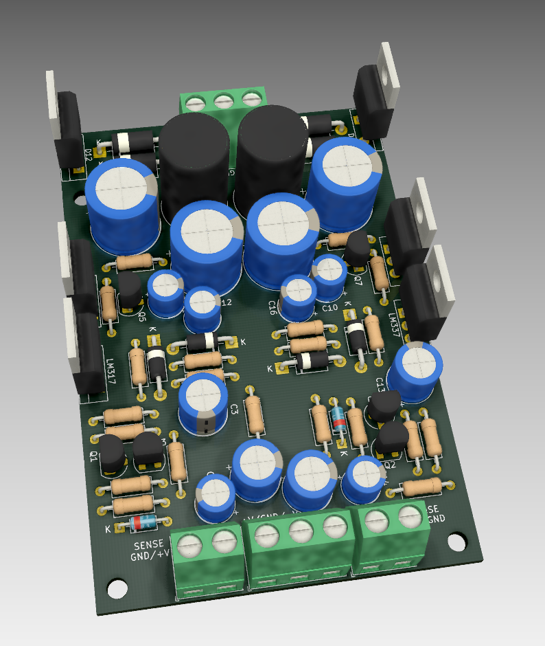

I made the THT 1.5A version of the previous supply. It should be good to 1.5A. It's single sided and can be diy-ed. Has pdf and gerbers inside the folder, as well as the Kicad project.
The input filter is CLC and I recommend using an inductor of around 10uH with a 9A rating. I put two footprints and you should be able to find something that fits. Something like 744750460100 from Wurth should do fine. The inductor should clear up HF noise. Input capacitors I'd use 2200uF/35V Panasonic FR (12.5mm diameter!). I'd use FR for all caps until the regulator, the footprints should allow for the 35V versions.
Cap multiplier transistors I'd use BC550/BC560 with MJE15032/3 combo. But you can use anything that is available in the pinout given you keep the voltage/current ratings.
The board should be transformer configuration agnostic, as in you can use either a center tapped one either a two wire secondary one. If you're using one without a center tap you need to use the TO220 diode option on the board. Since it carries all the current it will get hot, so you might want to heatsink it. They are mounted on the side just like the pass/regulator. You'd use the middle of the connector for ground and the lower hole of the connector for the other AC wire. If going with center tapped then choose DO-15 diodes that have 2A or higher current rating. The practical result should be the same regardless of center tapped or not. I think the ripple should be around 1nV or so, there's other issues than the ripple at this point. That is at full 1.5A output.
The dienoisers also have 1206 output caps footprint on the backside. It should work for LM337 as it needs a low esr on the output, and I put one for the LM317 in case one wants to try LT3080 instead. It should be possible to hack one in with some work on the regulator legs. Take care of the ADJ cap for dienoiser, should be 2.2-4.7uF for LT3080. You could put a 0805/1206 across the electrolytic pads. I will test LT3082 soon and if it works I think there's high chances LT3080 also works with the dienoiser. There's an ESR correcting resistor in series to GND with the electrolytic output cap for LM317. There's a jumper on the backside to bypass it if you're using a cap that has the correct ESR.
If you want the denoiser instead you can bypass the 560R resistor with a wire. There's R/C comp network and I will have to test for the dienoiser values but I think they should be the same with the ones that I used on the first DIY supply I made. I can't remember the values but they should be in earlier posts. The layout is almost identical for the dienoiser parts and it should work.
There's jumpers on the back to sense the regulator output at the output connectors if you don't want to mess with wires. Also since the GND trace on that jumper is close to each sense connector one could easily add coax cables to remote sense.
The board should be good to 30V output if you use the correct voltage rating for all caps involved. Try to shoot for at least 5V between input and output. Play with the sim to check the ripple on the first cap and check how low it goes.
Board size is around 62mm x 90mm.
edit: this design has not been tested so you make it at your own risk!

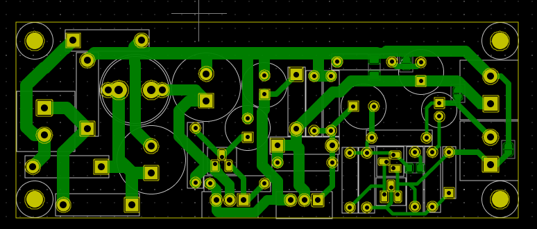

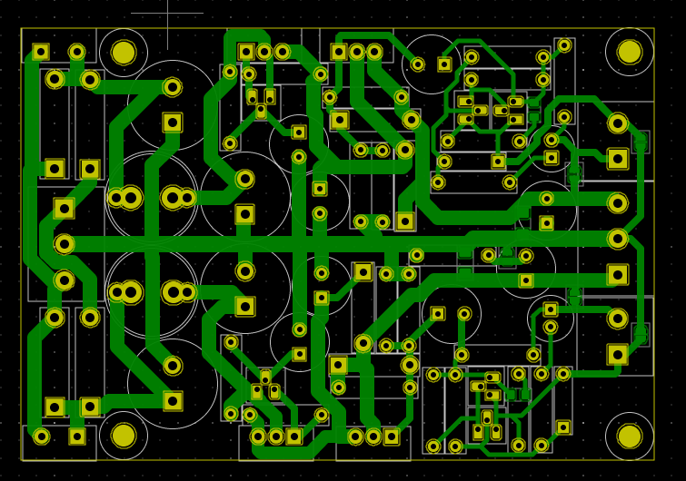

And the same thing for only the LM317. You can also use LT108x for this and the previous board, forgot to mention. Just needs very low ESR on the output cap (will test with 1206 ceramic) and some compensation, I think around 40-50nF/3.9R or so. When I get to testing I hope to get values for most of them.
Board size is around 37mm x 93mm.
Also warning, this board has not been tested. You make it at your own risk!
